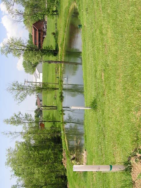

When I built my big pond, also 4 acres in size, I built three underwater islands that are four feet below the surface when the pond is totally full. Since I'm down a foot or two by the end of summer, that means they have 2 to three feet of water over them when we're out there fishing. The sides of my islands drop four feet to the bottom of the pond and the pond depth varies from 8 to 12 feet when full. Stumps and logs that didn't burn are piles and scaterd over the bottom as well as along the sides of the islands in places.
My small pond has an island for the very reason mentioned. Save time in removing dirt. I justified it as a place for ducks to be safe and hang out, but they rarely use it. I was hoping for ducks in my big pond, but the shoreline is too steep for them to have any feeding and the water is too deep for them. I get a few ducks from time to time, but mostly they avoid it. I don't think a good duck pond is the same as a good bass pond, and I built mine for growing large bass.
Eddie

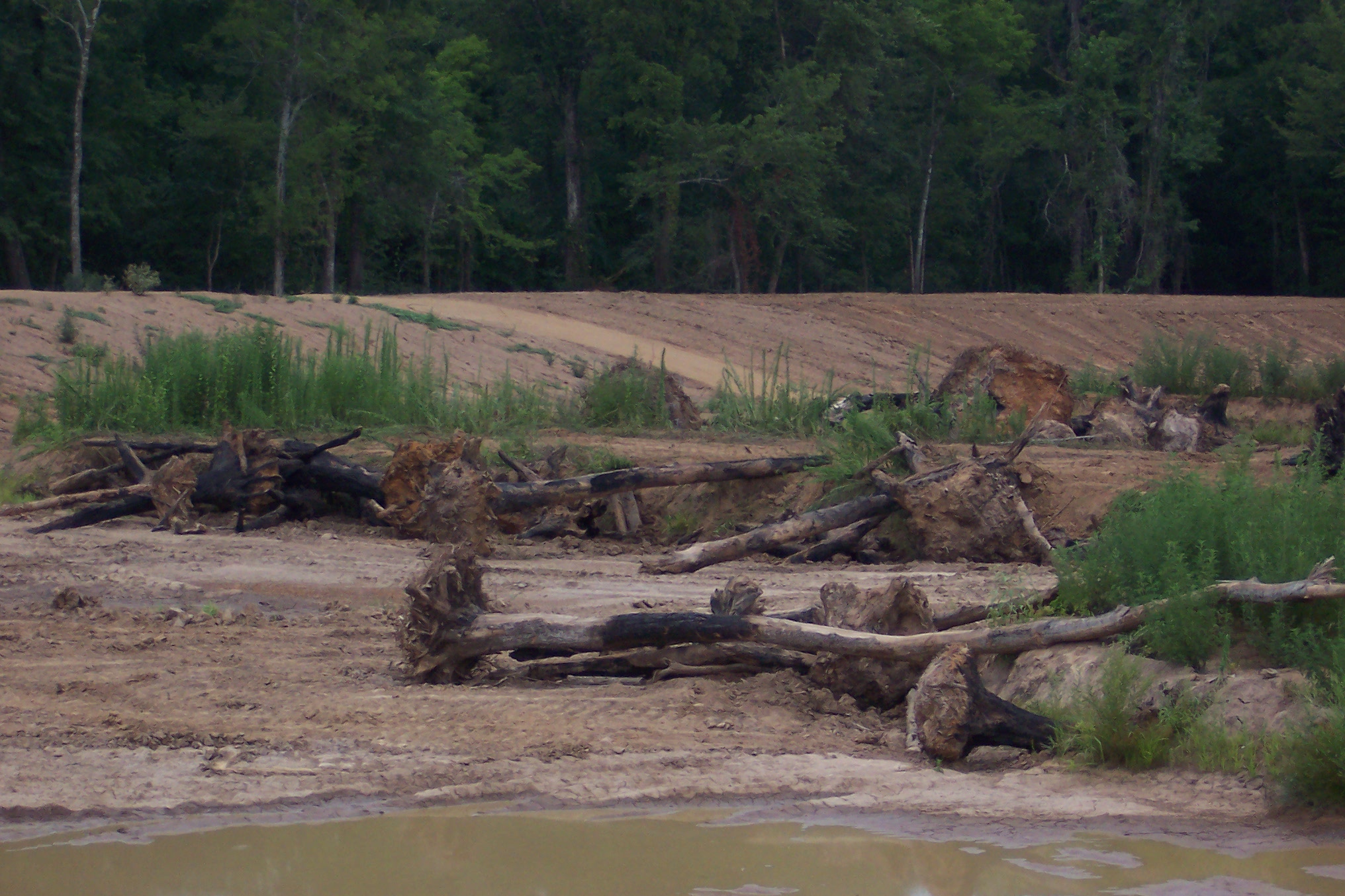

Based on input from TBN University faculty (Y'all) I decided to Go 4 It. 1. Reduced size to 1/4 to 1/5 acre. 2. Changed location from rear of property to nearer house with layout based on best line of sight from house. 3. Added option to bring in heavy equipment if/when I get tired or run out of time. 4. Give some dirt to neighbors (they come get it) to reduce work.
Bacically am going to dig a very shallow ditch deeper and wider. Currently: getting rid of trees and major roots, removing top foot or so of top soil for use around property and defining size an shape of finished project. Retired 1/1/2010 and now have time. Will post pic's from time to time as work progresses

Ctpres, it sounds and looks like you've got it going. Congratulations on your retirement.:)
You sure have a pretty place with nice trees. A nice pond in there would be very cool.
/ Build A Pond? #58
CONGRATULATIONS !!!!!
With lots of time on your hands, digging your pond will be just about the most fun you can have. Of course, it might seem like work while you're doing it, but it's not. When you feel wore out, take a break, but never quit digging and moving dirt until it's where you want it to be. The only regret that anybody ever has with a pond is that it's not big enough. No pond ever is!! Figure out the maximum size that you can make it, and keep at it until you get it to that point. If it takes all year, or five years, it's better to take the time then to have any regrets.
Enjoy,
Eddie
