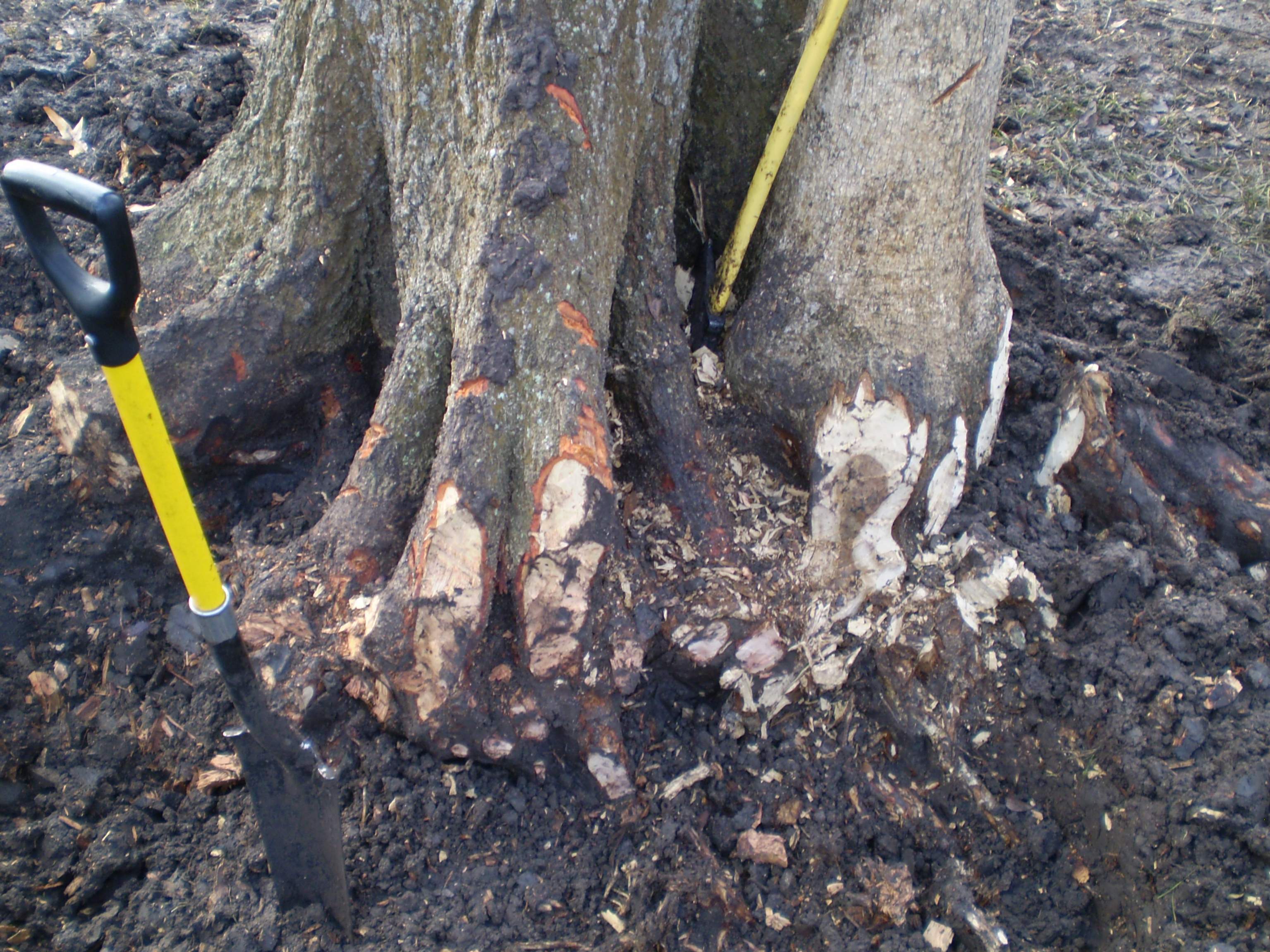

One of my early problems turns out to be top soil removal around large tree roots. My Bota just is not big enough. Since I only have a few trees left to deal with I don't want to bring in bigger equipment yet. I tried cutting big roots out several feet before pushing tree down and it works great. Yup more work but working with a shovel and axe is good exercise for an old man. Picture is my worst case, two big trees in same spot. Lots of chain, rope and two tractors to pull should get the job done

ctpres- is that a maple tree ? if so, you are in trouble. There are tap roots underneath the tree that goes more then 6 feet down. It took me 2 days with a bota BH and my fathers massey to dig it out and took two of us to topple it. chopping the roots on the side is good, but you need to remove all the dirt around it first to expose the bottom of the tree to see what I mean.
I took out a maple about the size of the one in your pic. It had a double trunk too. I dug and pushed for a long time. Finally ended up with a crater with a still very upright tree in the middle :) Could not figure out why I could not get the thing loose.
Eventually I got to the 'root' of the problem. The tree roots were grown around a rock so big, all I could do is push it in low gear. Fortunately, it was sandy soil or the tree might still be there. :)

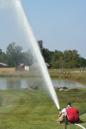

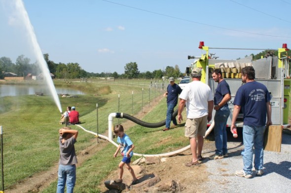

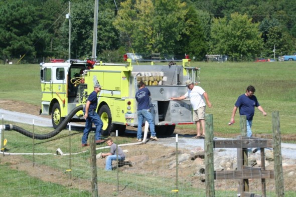

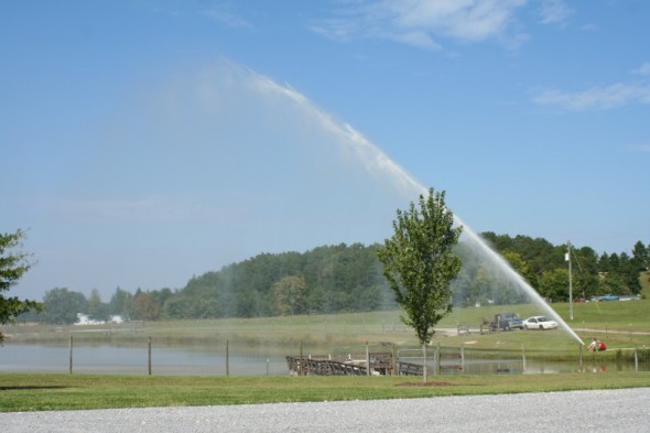

You have to install a dry hydrant dryhydrants.com: Mainstream Dry Hydrants Home Page. . You also have to have the hydrant "engineered" and the pond has to pass a 100 year drought survey before ISO (Insurance Services Organization) will recognize it as a water source. ISO is the company that rates fire departments. You also have to have a road built to within 10 feet of the dry hydrant that will support a fire truck (30,000# to 50,000#) 365 days out of the year.
I've been in the fire industry (as a volunteer in a rural dept) for 19 years so I am speaking from experience.
Here are some pictures of the dry hydrant that we have in our pond. The driveway runs right against the pond. It cost about $1000.00 to install and I did all the work myself. That's me stepping over the suction hose in the first picture. :D
My suggestion is to check with your local department before you spend your money.
Chris

I may be off a little on the pricing, but by the time I bought 100' of 6" schedule 40 pipe ($5.00 a foot) , the strainer and stand assembly ($100.00) for the end of the pipe, several 6" couplings ($17.00 each) , a 6" 90 ($35.00) and the dry hydant head ($200.00) it came in close to $1000.00.
You have to glue the pipe. You can't use the bell ends with rubber gaskets, because you are using the fire engine to create a vacuum in the pipe to move the water. The rubber gasketed pipes are for pressure applications.
The general contractor that was re-claiming the pond let me use his Komatsu excavotor to dig the trench for the dry hydrant so I didn't have to pay for that part.
Chris

This pair of trees turned out to be a major project. It rained resulting in more fun. Lots of shovel and axe work to get these two down. Finally dug deep enough to flood base and soften soil around remaing roots under base. At 65' high I didn't have enough chain to safely pull with tractor. Attached 1 ton cable winch to nearby tree and every few hours I'd crank it a few more notches. It finally fell sometine wed. night. Never got to see the big event-sound asleep. More rain today so top soil removal on hold.
Huh!! who would have thought? That was a dandy idea. get the tree area wet and apply tension and crank it and leave it. :D One more bit of knowledge under my belt for future!:D
Congrats on getting the tree down easy and cheap! now the real work begins- cutting it up and getting it out of there in the MUD!! ;)

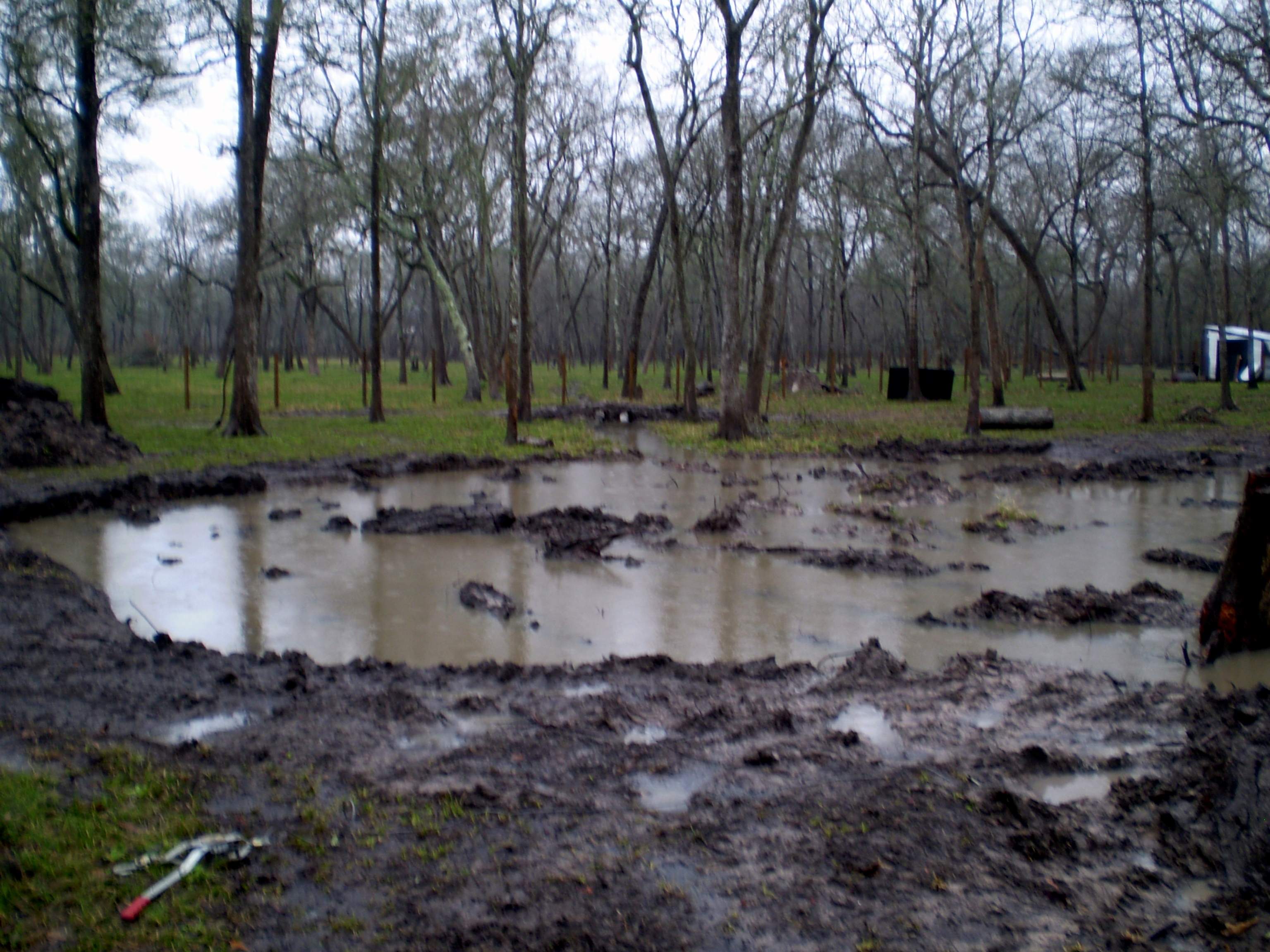

All the recent rain gave me a chance to test the water level. Now I have some idea as to how much dirt needs to be removed on the bank. End result will be a slope that can be safely mowed right to the waters edge with a zero turn. Top soil removal about 1/3 done. Current objective is to remove topsoil, slope shoreline and get something growing around the edges for erosion control
