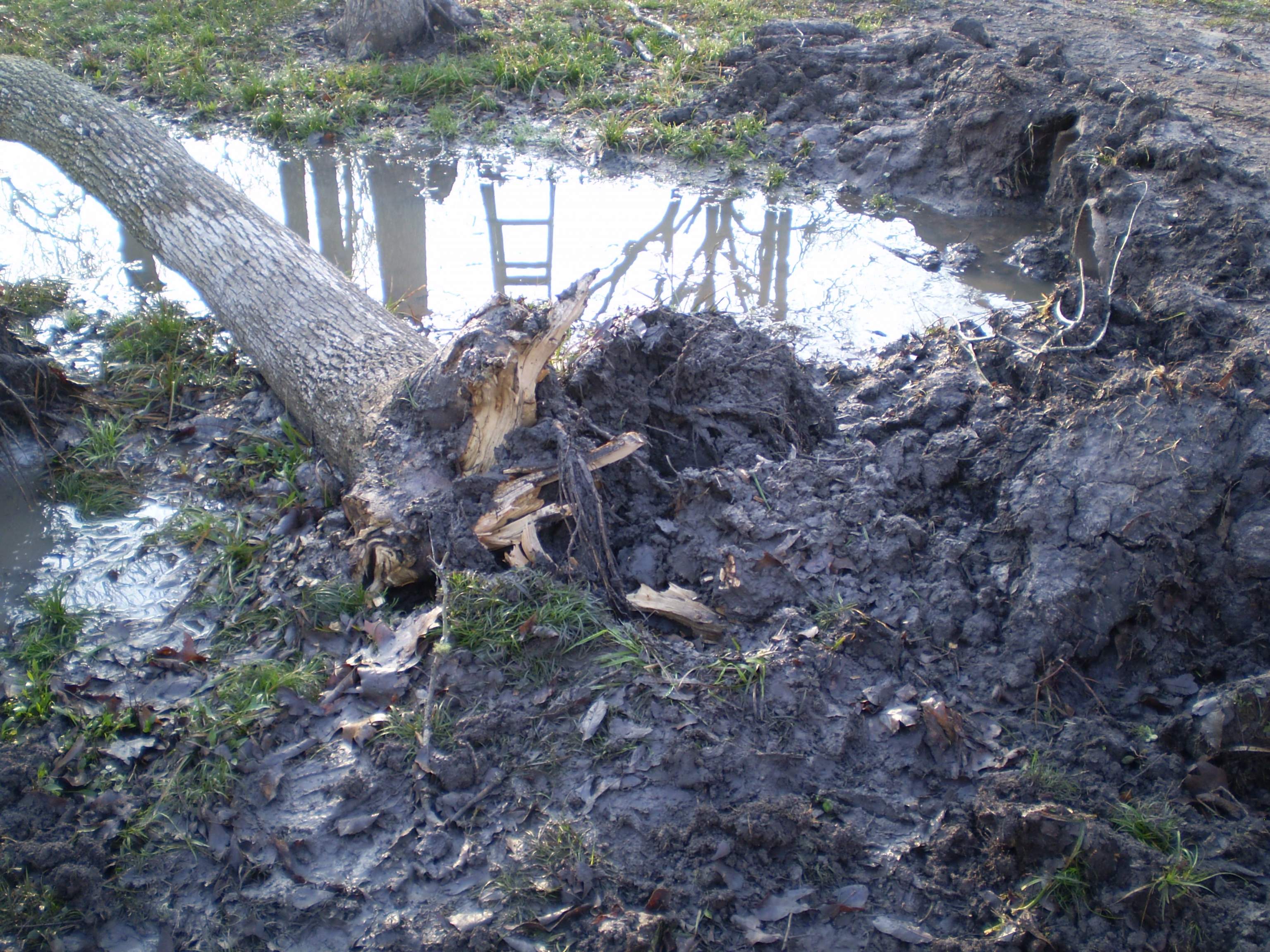

With all the rain I'm running out of chances for dirt work and having to resort to less fun projects. Size of pond keeps getting bigger which means more tree removal. I had such good luck with flooding that big one and winching it down I decided to try it again. First I raised the water level and left it alone for a week or so. In short order (about one hour total work on each) three trees on the ground. No stumps to mess with and major roots gone. Once things dry up Bota and new toothbar should have much easier time getting top soil out. Tools used: water, 5 ton hand/cable winch, some rope and about 30 ft of chain. Proceedure: Chain 15-20 high on tree to be removed to winch attached low on nearby tree. Crank till tight and go do something else. In hour or two crank it tight again and continue crank/wait proceedure till all cable in on winch. Use rope to secure chain while cable unrolled and secured to new point on chain and then continue crank and wait. Piece of cake. Wish I'd tried this sooner.
Since mud will be around for awhile I'm thinking a bridge will be next. Looking at cutting arch on bottom of treated 16' 2x12's and using piece cut from bottom to complete arch on top. Gluing and screwing two together for each side and deck boards on top. Handrail and done. Now just need to figure easiest and fastest way to cut arch.

Sounds like a nice way to make a walking bridge, I wouldn't try to take any weight across it though. By the time you arch a 2x12 there will not be enough meat to support much more.

I wonder if you do make that arch from the 2x12's and used the cut out section from the bottom to the top and then laminate/screw/glue heavy marine plywood to each side of both 2x12's and trim to fit and that would strengthen up the arch considerably.

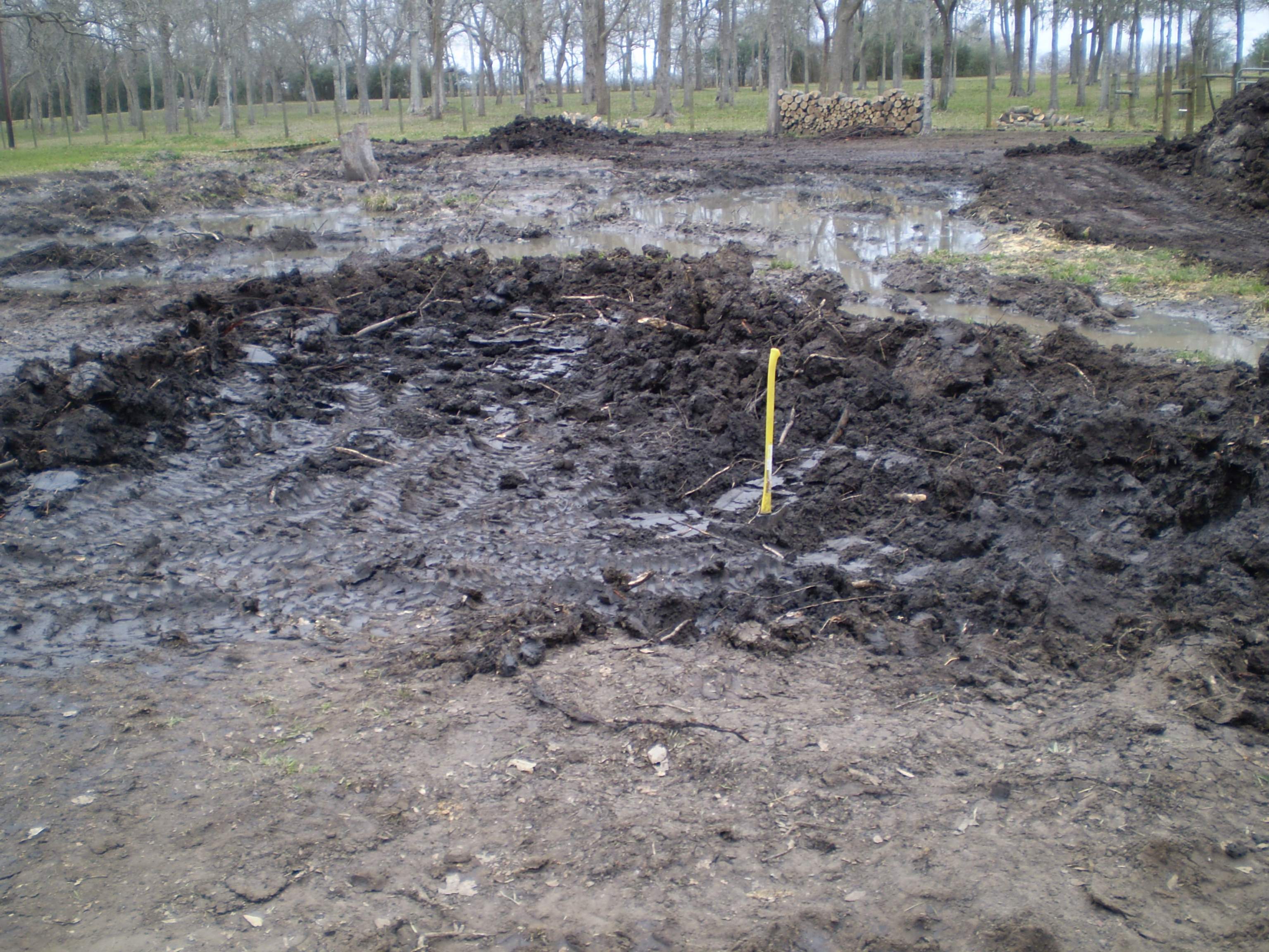

Does a toothbar really help? WOW! YES. I couldn't wait to try it out and finally figured out how to dig with so much water, I was using FEL to slice off chunks at waters edge. Problem with that was muddy spoils and in genaral a big mess. It worked BUT. New method-drop back a few feet and dig behind man made dam. What a difference, damp ground and new toothbar makes for fast work. Pictures represent about two hours work-a lot of which was spent learning how. Axe in middle is for scale. Top of handle is actually below water level behind dam. Also another question answered. Will soil hold water? Pictures answer that.
Do you need a toothbar? If you are digging or moving dirt-YES.

I gotta say- I admire you to keep working in muddy conditions. I can understand you really want to get it started and you have.
I have no doubt about the dirt bridge being able to hold up. My father and I built his dirt bridge when I was 14 and worked until I was 16 to get it done and still holding up fine after 22 years. All we used was a ATV and dump cart by hand. :eek: The bridge we built was similar to what you did, but has one 3 inch pipe on bottom with plug and several more above that 2 feet higher for overflow. The plug on bottom is for those real heavy flooding conditions in spring from snow melt. every 10 years the plug needs to be removed. I have been meaning to build a 12volt watermill for bottom pipe for light but never got around to it.
Have you ever gotten stuck yet? I assume you have due to those kinds of muddy conditions. You must be using your head to get that much work done. :) In the last picture, I see h poles coming out of the ground. what are those? some sort of a kids play area or something ?

Pic of Bota below water level. Nope not stuck and actually havn't been stuck yet. So far most work not in mud. Bota setting in hole for 2nd day of digging with toothbar. Battery died on picture showing hole. Will try again. Rain forcast for tomorrow, may be test trailer work day.

This picture shows results of two days of toothbar digging on East side of pond. At this rate I only have 3 or 4 more days of top soil removal. Then smooth out banks, plant some quick ground cover and figure out how to get piles moved to low spots around the ranch. That's the Bar BOB Ranch Head Honcho surveying days work.
