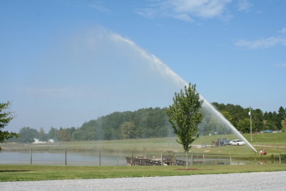

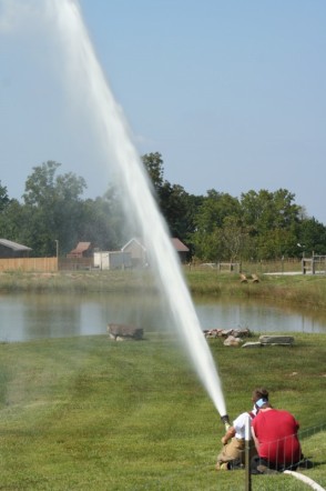

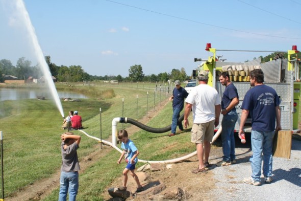

Anyone in Texas build a dry hydrant system for using pond water in fire fighting? I was in fire alarm business for about 30 years and understand problems with getting systems approved. Local AHJ has already insisted on me submitting plans for approval. Just need info on what has been done. I will build it as long as I don't have to go with the code that requires galvanized pipe.
/ Build A Pond? #130
Around here we use 6" schedule 40 pipe per NFPA 1142. You can buy the pipe locally and then order the fitting for the dry hydrant on the internet. This is where I got the parts for mine: dryhydrants.com: Mainstream Dry Hydrants Home Page.
NFPA 1142 gives details on the installation and maintenance of Dry Hydrants. If you go to the NFPA website : NFPA and click on Codes and Standards. Click Buy Codes and Standards. You will then have to register to be able to see the code. You can view the code online. You will not have to buy it, but you will not be able to print it.
Get ready to spend over $1000.00 on a dry hydrant. The parts are pricey!
Chris

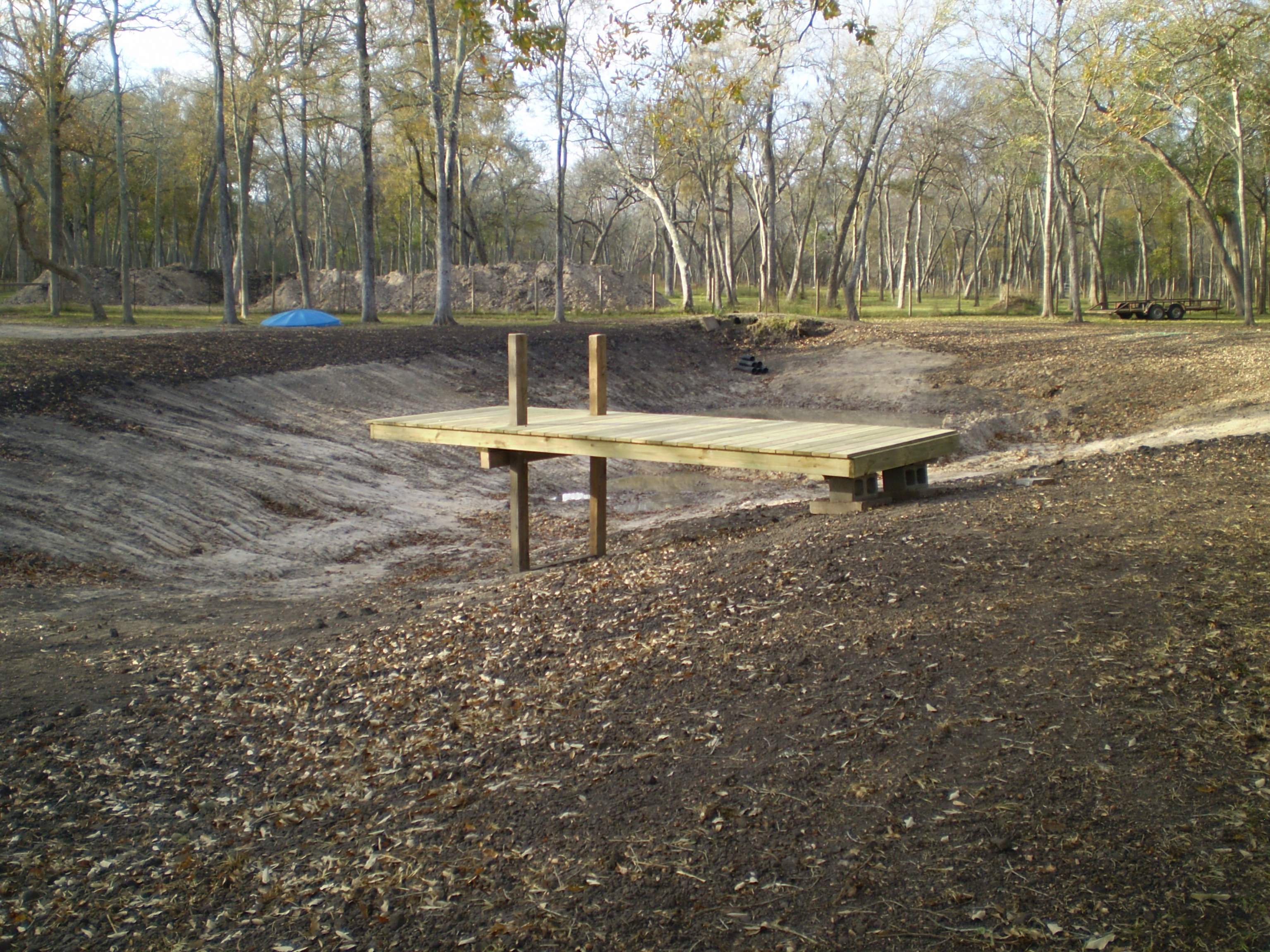

Dock done. Bring on the rain. Well almost done, I still need to finish some kind of approach and step up to dock. But that won't happen till I see for sure where water level will be when full, my transit slills are marginal.
The good news is, if your stabilizer doesn't work, eventually you'll have a narrow boat ramp :) (a canoe ramp?)
I like that pond!
Nice dock!! I bet if I show this to my kids - first thing they'll ask - "Daddy, Can you build us a ramp like that so we can jump it with our dirt bikes". :D I like the pond too. We hope to start digging our 1st pond after the Holidays. :thumbsup:
