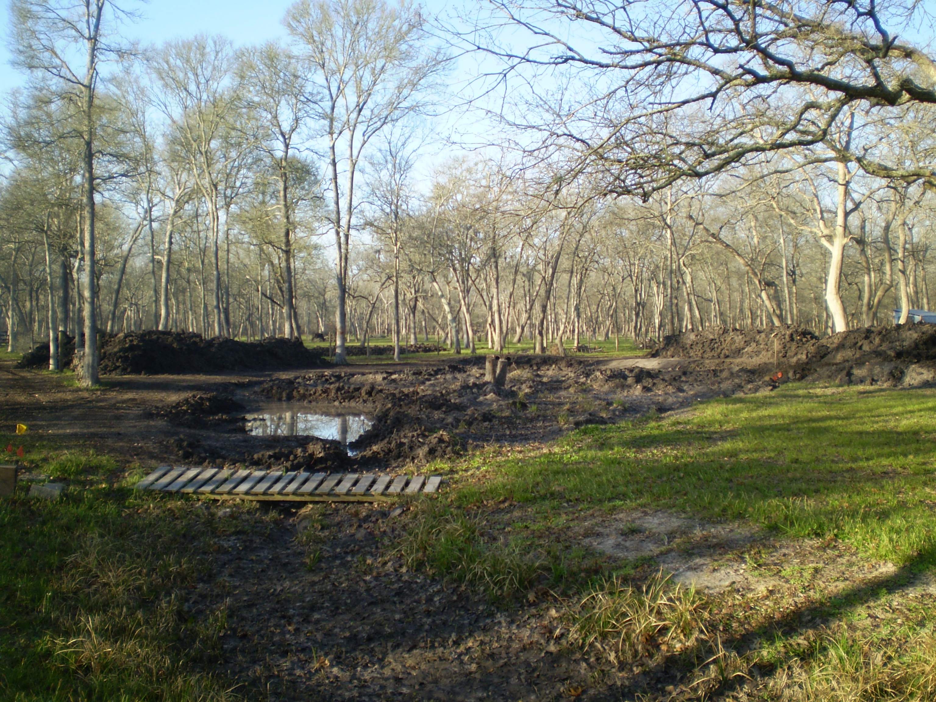

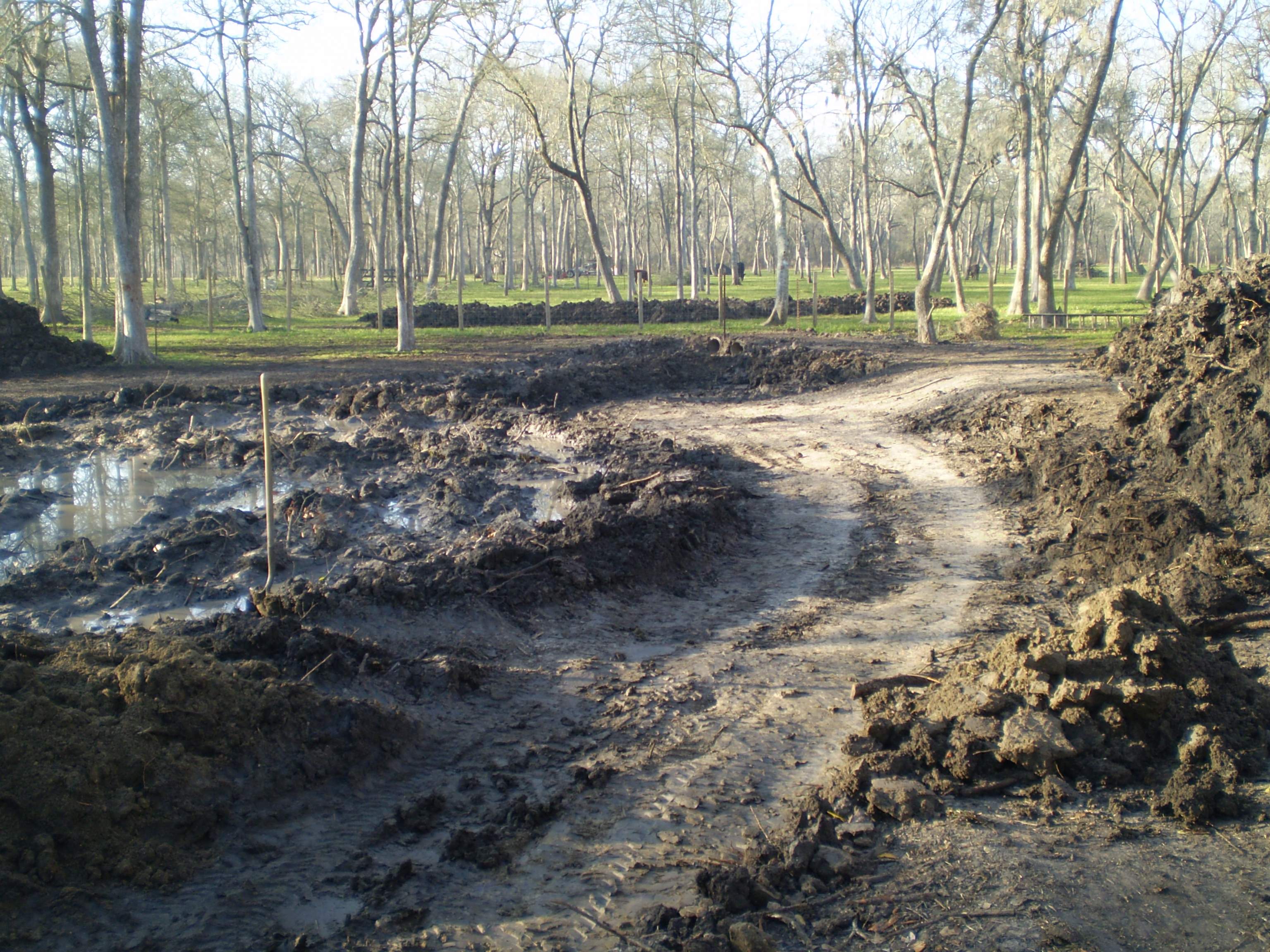

Project status: Topsoil removal done, lots of dirt ready to be moved, waiting for trailer, east side ready for grass, stream diverted to east side. Pic one shows east side of pond ready for buffalo grass planting and maybe a few landscape plants. Also can see temporay new stream bed. I diverted water flow to a narrow channel on the east side. If we don't get a lot of rain the rest of the pond should dry up so I can start working on the bottom. Pic two is just finished west side. Bit hard to see depth untill you see the drive out ramp on the far end. Pic three is whole project viewed from upstream side. Pic four is view from house. Not much to see from house but a lot of dirt. So far this is still fun.

/ Build A Pond? #103
Looks like you're coming right along. I like how nice the shoreline is looking and can see where it's going to look very natural with the shape you are making it.

Thank You Eddie! I didn't want any straight shorelines. I'm just doing this as I go and trying to think each step thru. Havn't even finished yet and starting to work on landscaping.

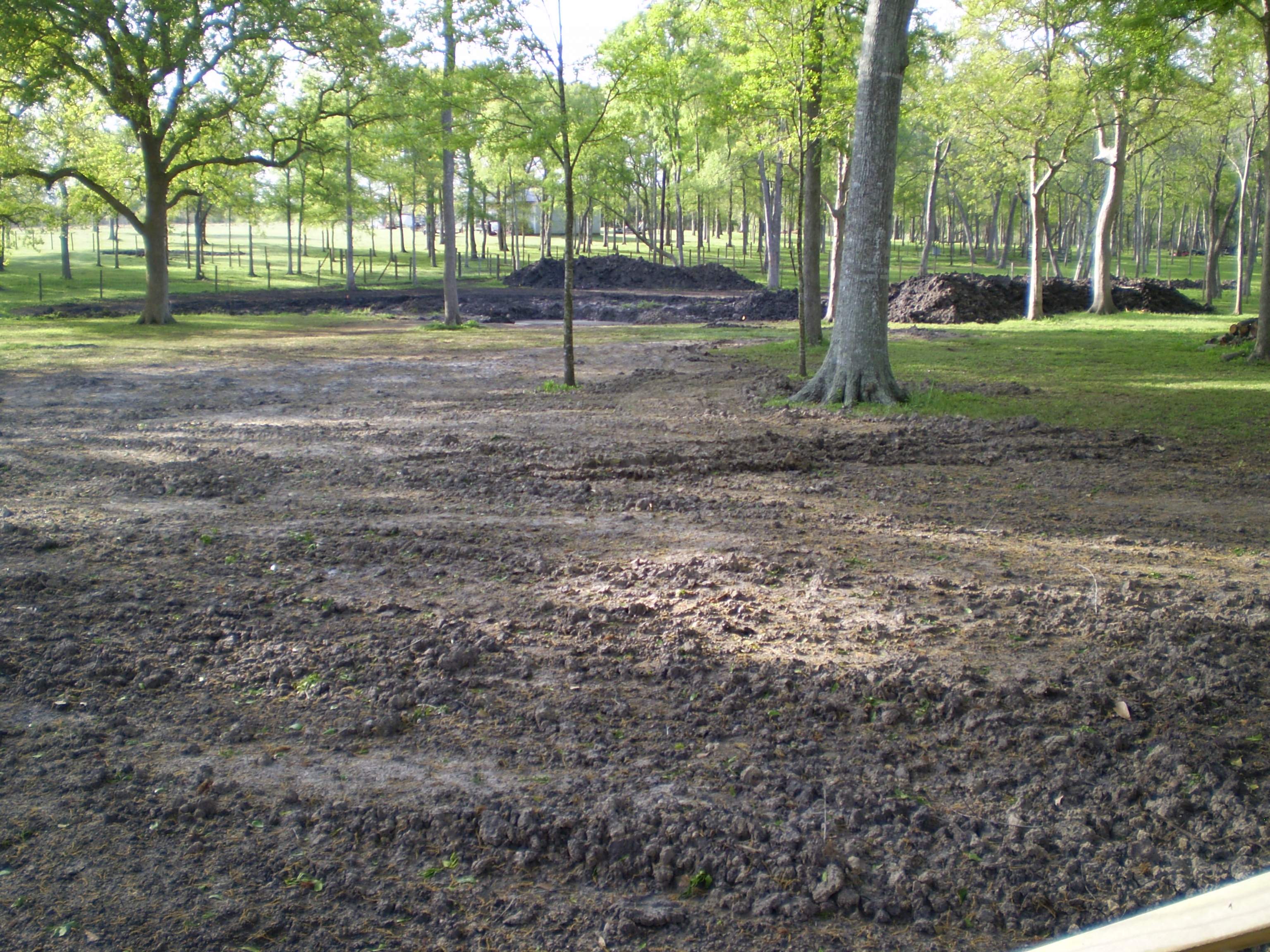

Dirt piles are going away ever so slowly. Neighbors that originally wanted some found out how much work it is and have all but stopped. Today or tomorrow a friend with lots of heavy equipment seat time is dropping by to give me some technical help on how to handle the spredding, leveling and seedbed prepration. Must get a lot done before the end on this month as we are leaving for a one month plus RV trip west. Can see some of moved dirt at bottom of picture. So far only spreading around house to smooth out the original pad built up to raise building site. Trying to make it look more natural as opposed to the original pad shaped like house.

Thanks to my retired friends (20 years heavy equipment operator) visit today: 1. Now can use a transit good enough to check grading the banks and depth to go in digging. It had been gathering dust in the shop. I had opened the case once to see what was in it-knew I could't figure out how to and just shoved it in a corner over five years ago. 2. He looked around for a couple of minutes and showed me a LOT of places needing fill dirt. 3. Told me to quit making it easy for neighbors by piling dirt in easy to work piles around the edges. Let then dig. 4. Said don't worry any more about stripping any top soil. Just dig down to desired depth till it rains. Then channel any standing water into that hole and start another one next to it. 5. Thinks my diverted channel should be adequate to handle pretty heavy rains limiting work areas to local runoff and direct hit rain. 6. Don't worry so much about staying off of septic field with tractor. Should be no problem when empty on twenty yead old field. And BEST OF ALL thinks it looks pretty good so far. In All a Great Day.

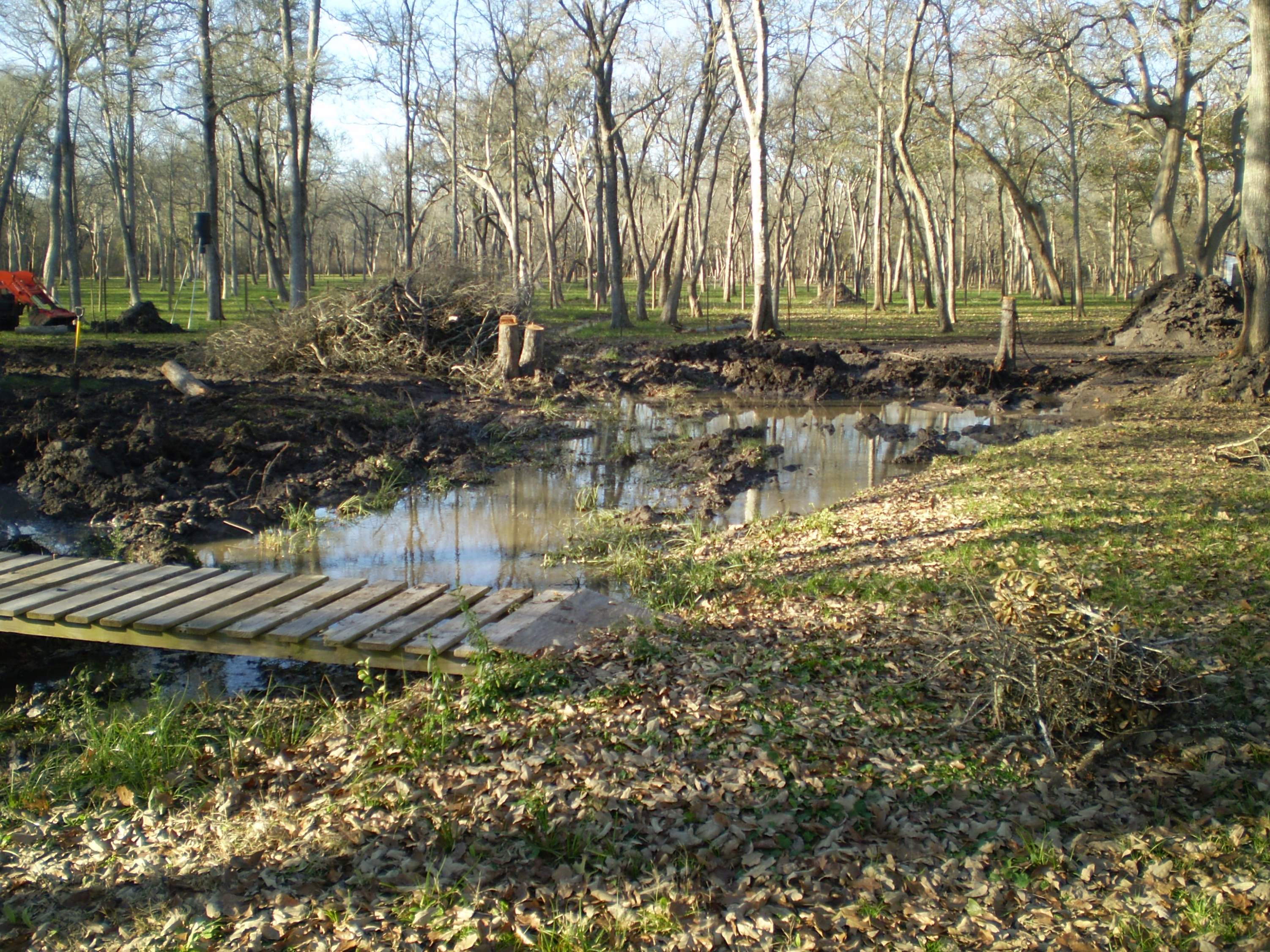

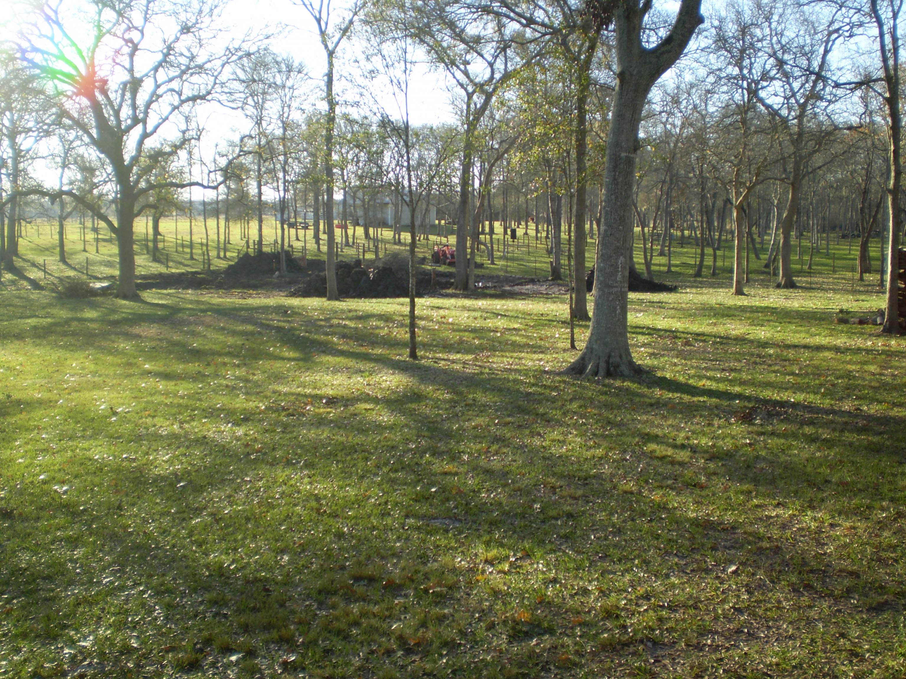

Status report before RV trip.
Will be on the road getting a different kind of seat time for about 45 days.
First picture is water after less than 1/2 inch of rain. I really wasn't expecting it to hold very long as I hit sand around three feet. That's really good news from a digging and spreading standpoint. Just means I'll need to save some of that gumbo to seal the bottom.
Next one is view of dirt spread around back yard. Wasn't really in the plans but that is what I have to look at when we get home. Just couldn't work fast enough to get it ready for grass seed.
Last one is view from edge of pond. For a tinhorn I think I have been doing pretty good at leveling. Still have a lot to learn. Now I really understand the use/need of wheels on BB.

/ Build A Pond? #113
It looks like you will have no trouble holding water in that pond.:thumbsup:
The second picture reminds me of a section of my yard that I recently prepared and planted. I've been trying to get a good lawn established from seed, but the progress has been very slow. Two weeks ago, the weather was nice for a couple of days, and the ground was damp. So, I had the tiller on the tractor and decided to see if I could lightly till this area. It went okay with the tilling, but I honestly wouldn't recommend it. Established grass kinda clumped up in the tiller. Anyhow, after tilling, I dragged the area with my chainlink drag and got it pretty smooth. I put down 150 lb of fertilizer over the area (about 4000 sq ft) and then put down 120 lb of fescue, rye, and bermuda seed that I premixed. I have a pull behind spreader for my lawn tractor that worked beautifully. After seeding, I drove back and forth over the area a gazillion times to set the seed into the surface of the soil and kinda pack down the seedbed.
After I finished and had the sprinkler going to water the new seed, I was cleaning up all my fertilizer and grass seed bags when something caught my eye. In one instant, I felt sick at my stomach and pretty darn stupid.:eek: The fertilizer bags all clearly said "Weed and Feed" on the bags.:shocked: I had grabbed the wrong bags in my haste at the store and didn't notice until the fertilizer was down. I meant to get 13-13-13 starter fertilizer, but what I got was high nitrogen fertilizer mixed with weed killer that inhibits germination. It's been two weeks now with two rain/snow events and lots of warm weather. I have not seen one single sprig of grass growing from the seed. Of course, the weed killer is still there from the fertilizer, so I can't even get new seed down and expect any success.:( My bare lawn is hanging around my neck like the proverbial albatross.:ashamed:
