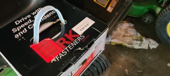

^ good point, Eddie. Maybe the widest roll of window flashing or zip tape that you can find? Ideally covering all the flat portion of your cut on the top side of the poles. The gooey tape also reseals itself around screws coming through it.

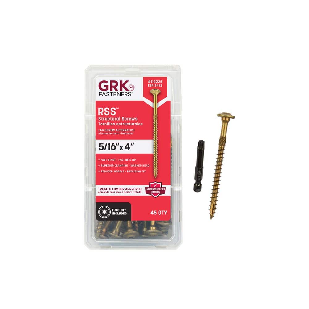

Good call on the GRKs, they are indeed stout. And you got the big 'uns. I predrilled holes for all of my decking boards, didn't want to stress them out too bad. I also used a spade drill bit to make a very shallow counter sink for the GRK heads, since I wanted them flush with the decking. In retrospect, that was probably a bad idea.

I will have over 600 screws to put in, so I plan to pre-drill the boards, but not countersink the heads. Not worried to much about the little bumps.
   / Building 55' Bridge Across Creek - Utility Poles #23
If your decking is green you won't need to pre drill, and if not, the only reason would be for splitting near the ends. I use the heck out of those GRK RSS screws and am amazed that even in normal junk lumber (normal lumberyard dimensional stuff) we can put them within an inch of the end of a 2x4 for temporary bracing without splitting it. 👍
If you don't already have one, get a cordless impact driver.
   / Building 55' Bridge Across Creek - Utility Poles #24
Countersinking makes a little "cup" that will hold water and expose end grain. The little things add up.
