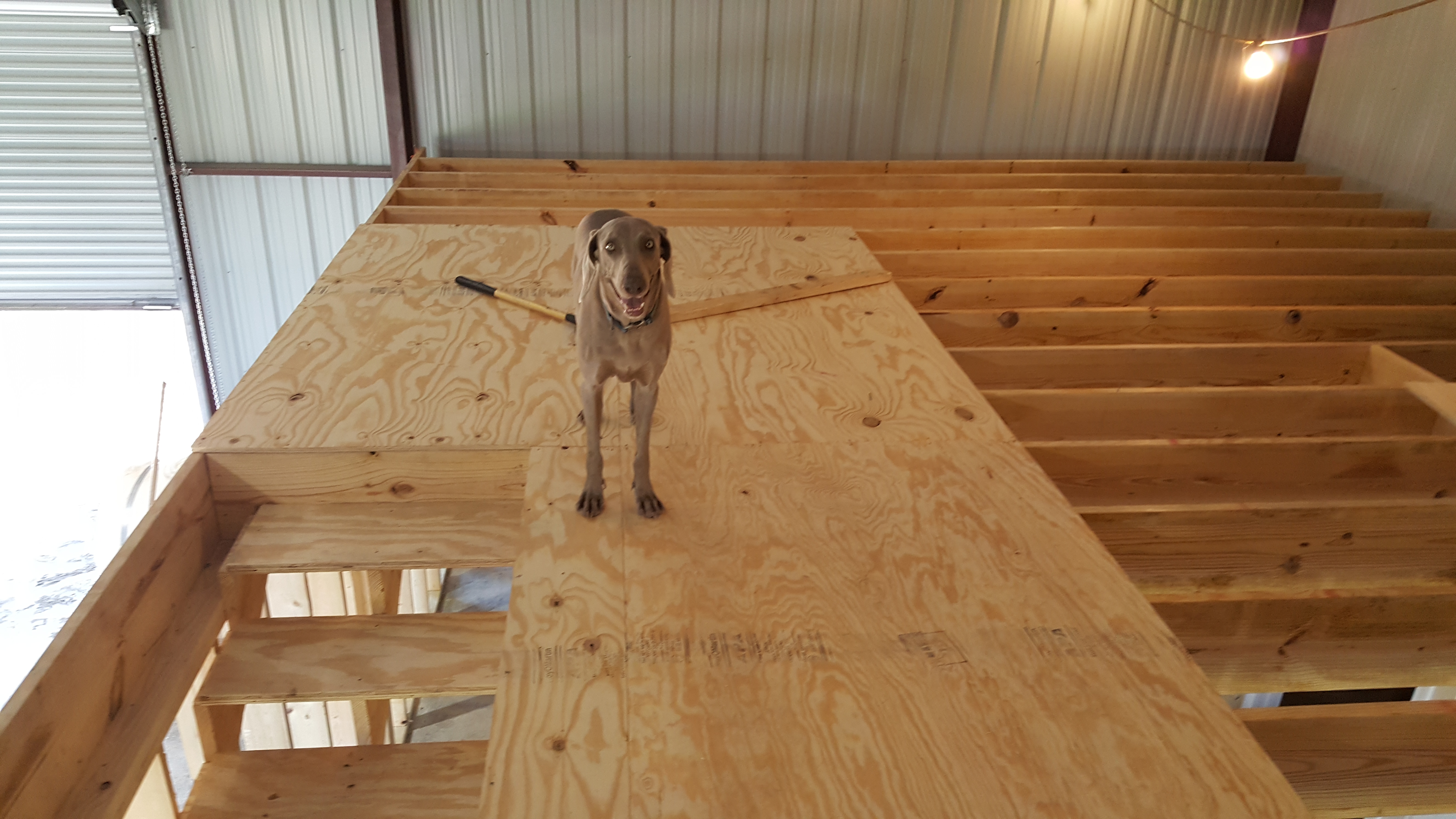

Started decking the second story. The dog is claiming his territory.
Gosh that guy looks happy to be up there. haha. Awesome.
Re: George.... plywood stair treads should be fine. Looks to be the same 3/4 or 1" ply as the decking. Rated for 2' spans, plenty strong for a stair tread. That said, I wouldn't use it either, I like a nice bull nose stair tread for safety and aesthetics.

The stair treads are 3/8 sub tread covered with 1 1/8 plywood with a bull nose routed on the edge.
