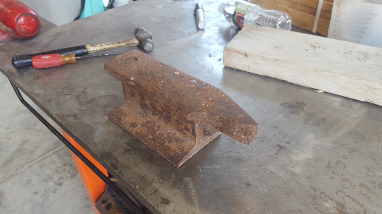

My BIL built this for me 30 years ago. I use it for a small portable anvil. You can beat the snot out of things on it. Survived my shop fire ten years ago.
