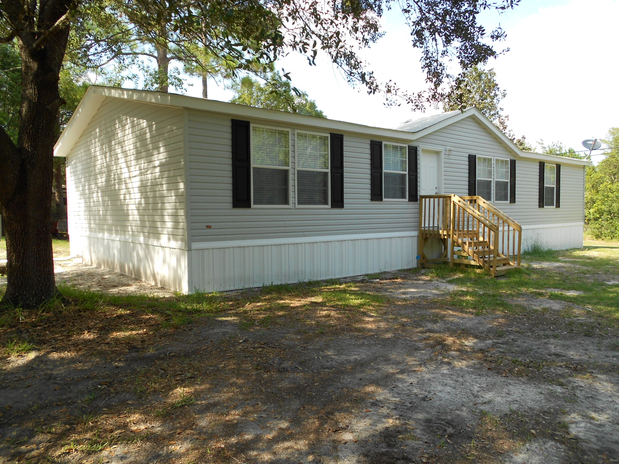

As has been said, you need to look at Modular Homes, or Manufactured Homes (used to be called Mobile Homes).
I purchased a Manufactured Home last summer, totally custom ordered and built the way I wanted it for under $37. a sq.ft. delivered and set up!
I went to dealers web site and found a floor plan that was close to what I wanted then I printed two copies of it. I cut up one copy and put the rooms on top of the other copy the way I wanted it, made a copy of that and sent it to the dealer who sent it to the factory. They put it into CAD and I had my custom home! NO extra charge either because it was basically the same house, different plan.
I ordered Vaulted Ceiling, insulation package upgrade and upgraded kitchen cabinets for the under $37. sqft. price.
In your area you can probably even have it set on a basement.
They still do make the cheap looking MH's but my dealer has a much better product that looks like a real home with the higher quality. I bought a Jacobsen, they are made in Clearwater Fl. It has a Zone 2 Wind rating.

I will add that on the day that I gave the deposit my home was put into the factory schedule and 4 days later it was ready for delivery! It took me a month longer to get my stupid permits in place. They delivered the home the next day after I got the permits.
The new home also has 2" X 6" exterior walls and 2" X 4" interior walls.
I did keep the price down by pulling the electrical and plumbing permits and doing that work myself. Also brought in 10 loads of dirt for the pad which kept price down.
