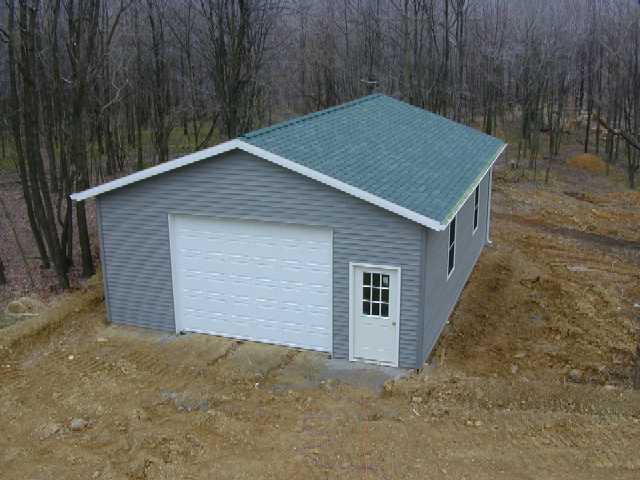

This may be too "barnish" for you, but here is a picture of mine. The landscape and interior are unfinished.

yes, I went with Morton. There have been some previous discussions on this board about barns and whether or not Morton was worth the price vs other options. I do not have any regrets whatsoever, and I did enjoy the relationship with the local Morton crew.

Thanks, Bill. I was just wondering what they were like to work with. I do like the looks of some of their buildings, but when I'm ready to build, I think I have enough contacts in the business that we can "general" our own project.
