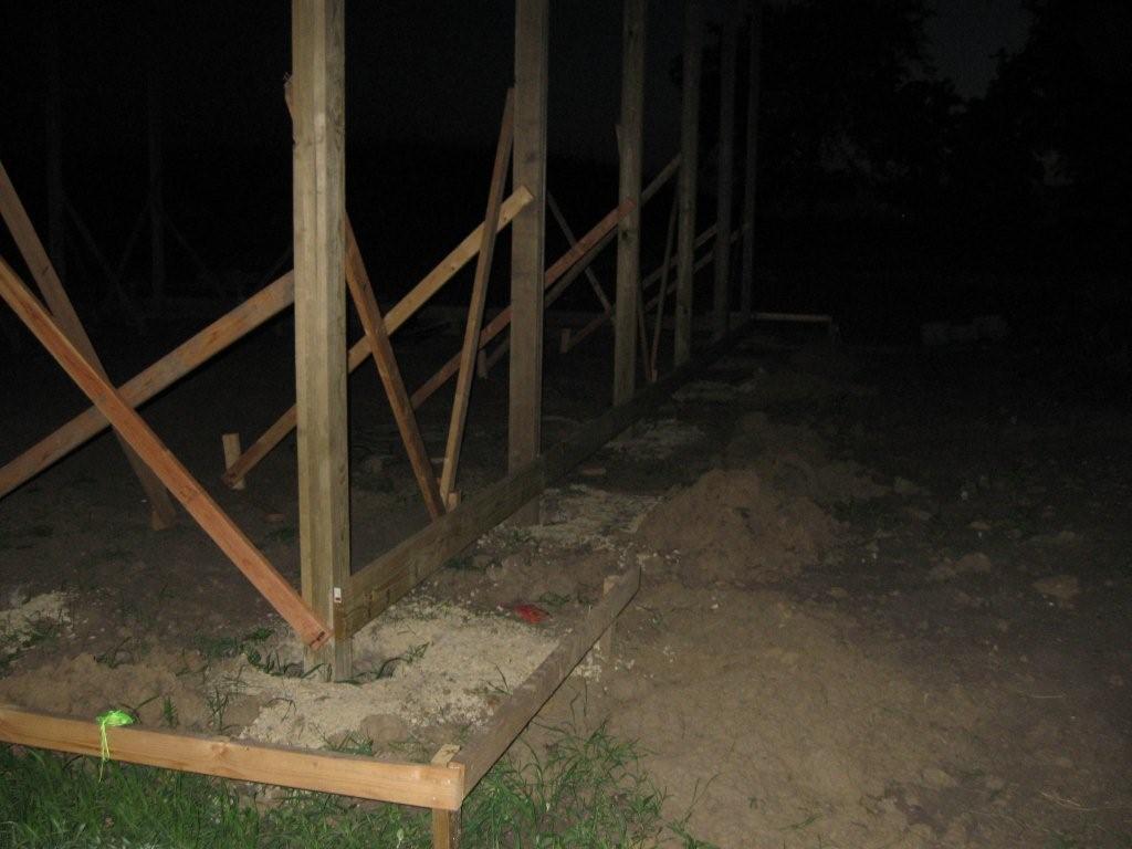

90% of the treated grade board installed.
Got an hour, maybe an hour and a half in tonight after dinner. I'd gone out on Tuesday evening and set up my rotary laser and marked a level line on all the posts. Then I figured out which post was the shortest and determined where my grade line should be. For my building, Cleary considers it a 13' 4" building. That's the dimension from the grade line to the top of the pole. With their Energy Miser trusses, it provides an inside clearance of 12' from the bottom of the truss to the grade line. Of course, they figure on the concrete coming up 3 or 4" above the grade line, so I'll end up with a ceiling of about 11' 8" or 11' 9" once I put concrete in it. Had I paid closer attentiion, I'd have had them tweak it to a 13'8" height to end up with 12' between concrete and truss, but that's ok...
Went out tonight and cut and nailed up the 2x8 treated grade planks. Got all of those up except for the two 6' chunks on the front end on either side of the overhead door openning, just got too dark too quickly. Plus, I ended up with a brace 2x4 on the outside of the one short wall, so that'll have to be moved first anyway. The planks were nailed on with 20D ring shank nails, 3 per post per board.

Picture of the grade plank.
