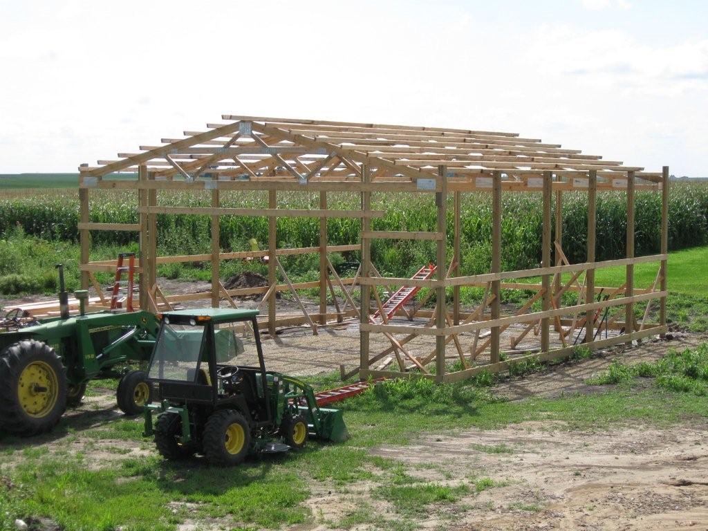

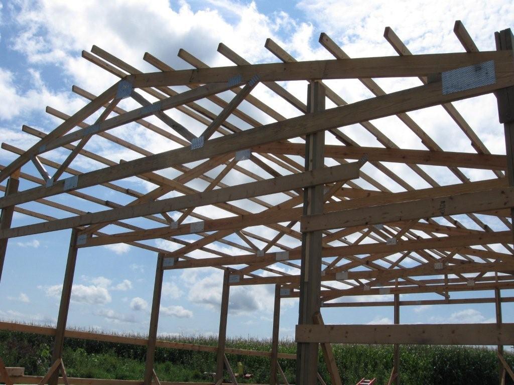

Progress.
My folks came out Friday night and dad helped out on Saturday. We got all of the main purlins installed in a solid day of work, fortunately the weather cooperated and didn't get too hot on us. Borrowed that coworker's 4020 again and used the loader to get dad up to the peak while putting in the 2 peak purlins. Once those were in, we installed the bottom purlins to set the spacings at the poles. With that much done, the trusses would handle ladders leaning against them, so we started in on the rest of the purlins. Lots of nails, all driven "the old fashioned way". The count was:
(28) - 18' 2x4's
(14) - 10' 2x4's
(2) - 9' 2x4 peak purlins
(6) - 8' 2x4 peak purlins
(2) - 2' 2x4's
(138) - 40D ring shank spikes
(96) - 10D ring shank toenails
(200) - 10D ring shank nails (joining purlins together)
Needless to say, my right hand and wrist is not happy with me today. Got a nasty blister on my index finger where the hammer handle rubbed while driving many of the 200 nails tying the purlin boards to each other, all at weird, awkward angles... All in all a productive day with no injuries, which is the best kind.
Then it rained another 0.9" last night, just to make sure that nothing gets completely dry out there...:rolleyes:

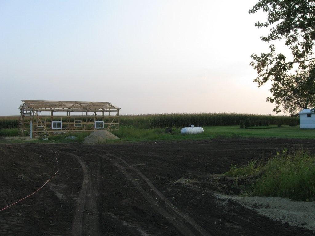

Latest pic taken from out front of the house after they got done with the finish grading around the place.
