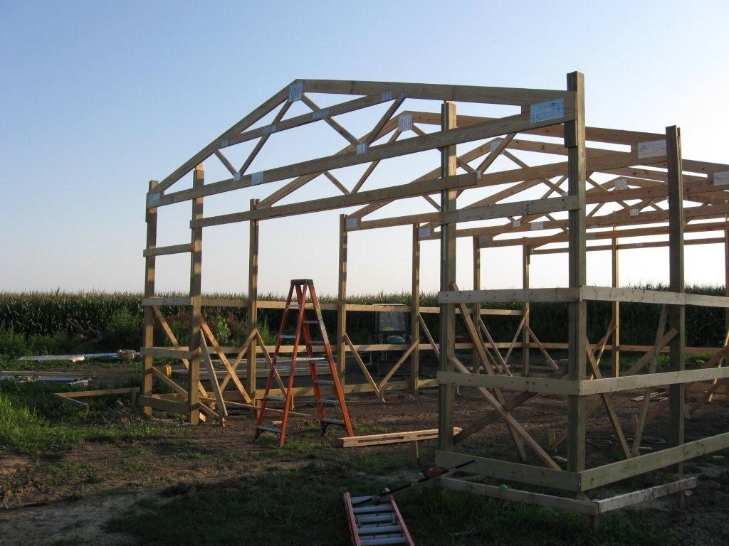

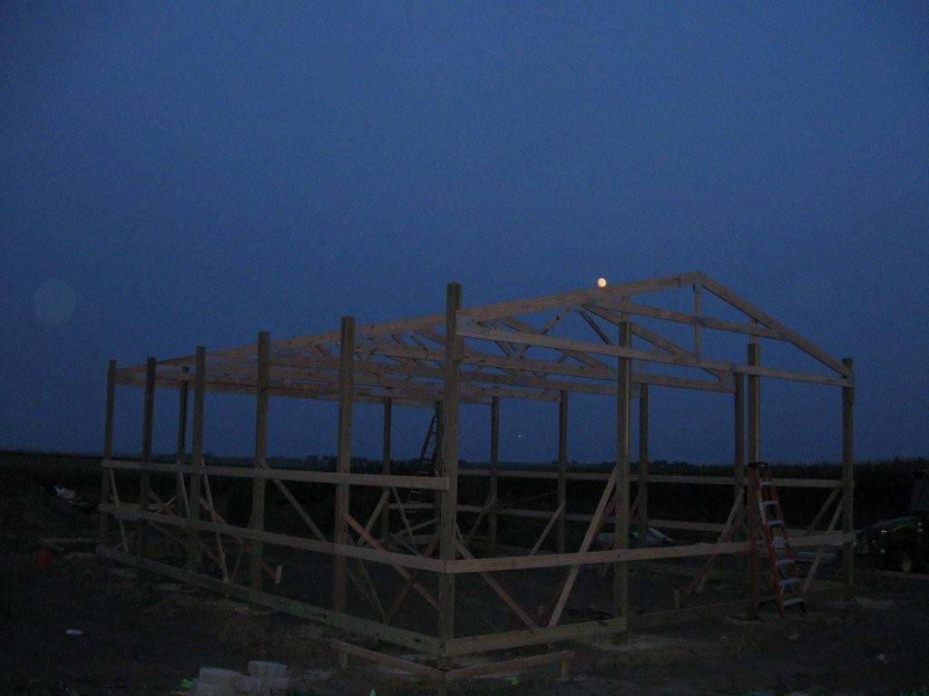

Trusses are set.
Set the trusses tonight. They aren't 100% nailed down, but they're up and ready to be squared up and tied together with the purlins. Borrowed a telehandler from the contractor that's building the house to put them up with, worked out slick. Had a friend from work come out and help run the telehandler while the wife and I guided the ends into place. Went pretty quick that way. Still lots of work to do with all the purlins, the remaining girts, and a few corner braces, but we're making progress.

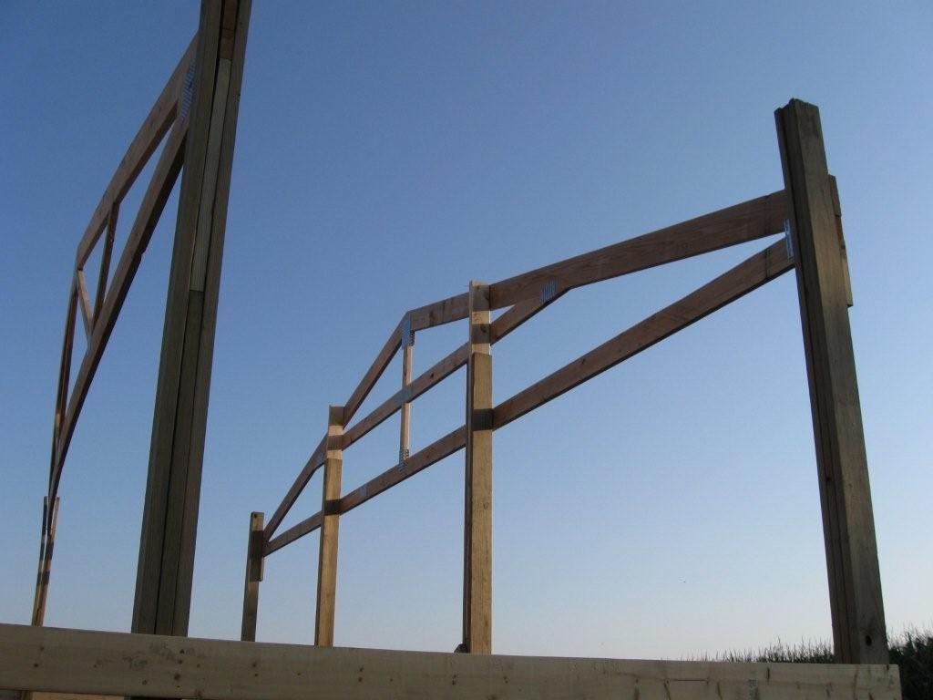

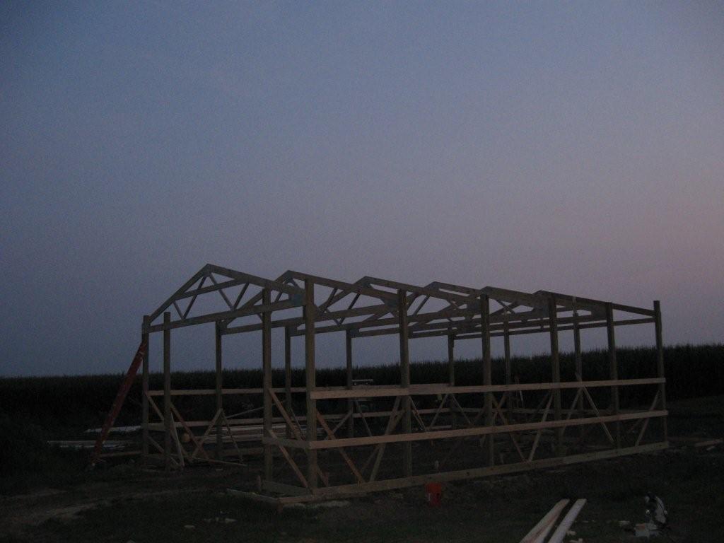

More progress.
Got a little time during the week to firm up the trusses some. Got the endwall trusses nailed on solid and braced with the post extensions on the middle poles the other night. Went out tonight and installed the lower chord stabilizers (2x4s across the tops of the bottom chords on the trusses to prevent flexing) to lock in the spacing and straightness down the middle of the building. Also beat a few more nails in the tops of the poles where the trusses fit down into them to better lock down the middle 4 trusses in case we catch a storm the next day or so. I feel a little better now about the trusses not falling back to earth on me...
Plan is to work on finishing up the wall girts this next week. My folks are coming out on Friday for a weekend visit, so dad's going to help with the purlins up on the roof, since 18' 2x4's 17 feet in the air is a bit tough for 1 guy to do very quickly...
   / Building a Shop
#110
A couple pics from the other night.
