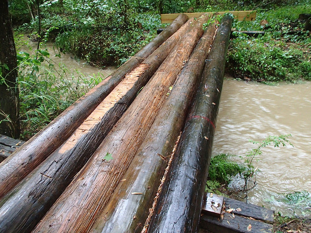

Here's a picture of my in-progress bridge after 5" of rain. Creek is probably 3.5' to 4' deep. It's normally about 3 to 4 inches deep.

I built a bridge 16' long and 9' wide using 3 16' ties for the stringers. They set on a 10' tie in each bank which has 3-4' of 1 1/4 minus rock in trenches 2' wide and 12' long. I had a lot of muck on one side which that overcome as I was able to get down to firm subgrade.
I think you should consider setting back from the banks more as creeks have a way of eroding banks and changing course a little . My set backs are 4' each side.
I take my 1 ton dually truck with 2 yds of aggregate over it and never a creak or movement. My deck is rough cut full 2" clear fir planks. Had to have them milled as lumber yards do not stock rough lumber anymore here.

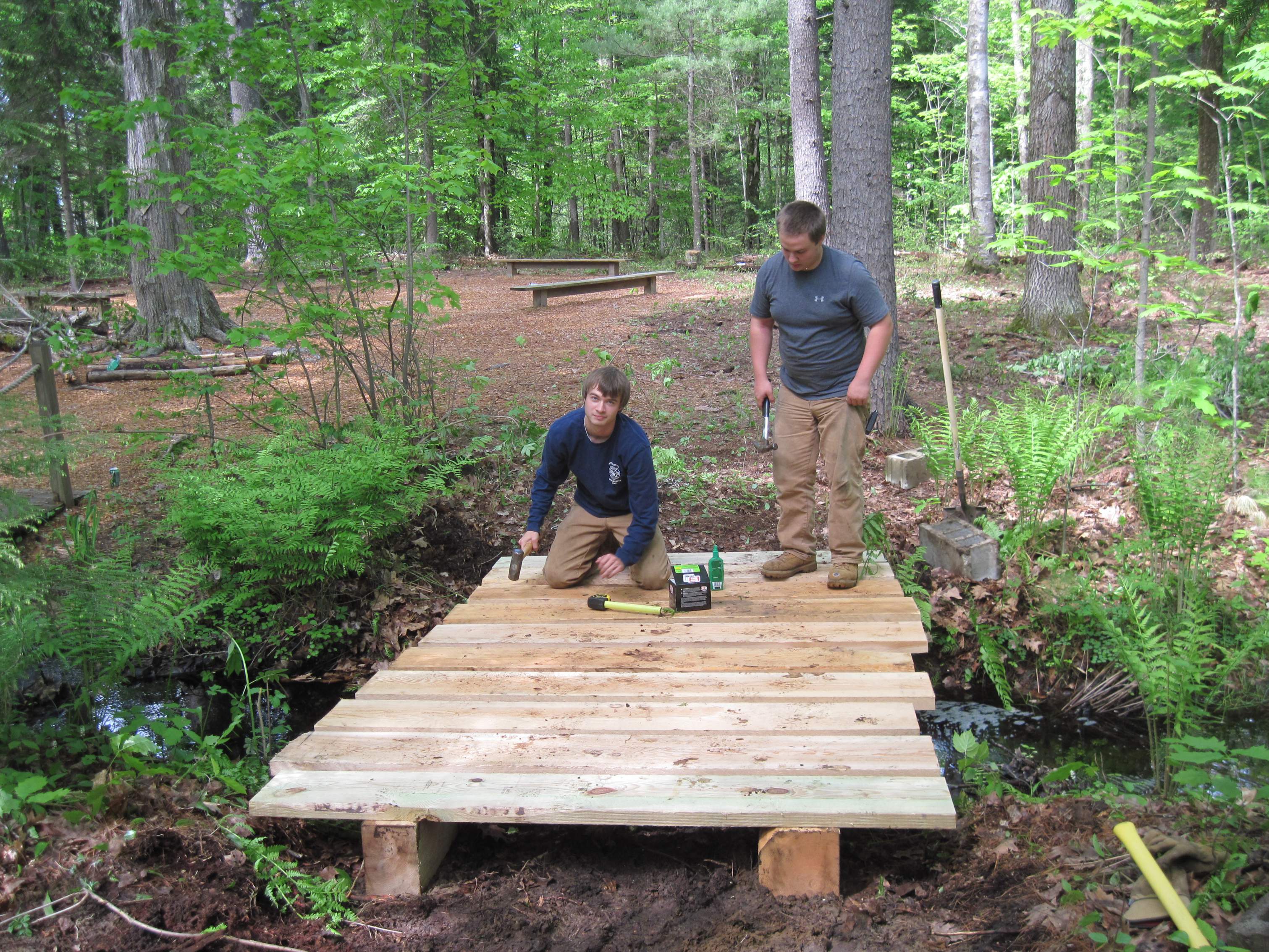

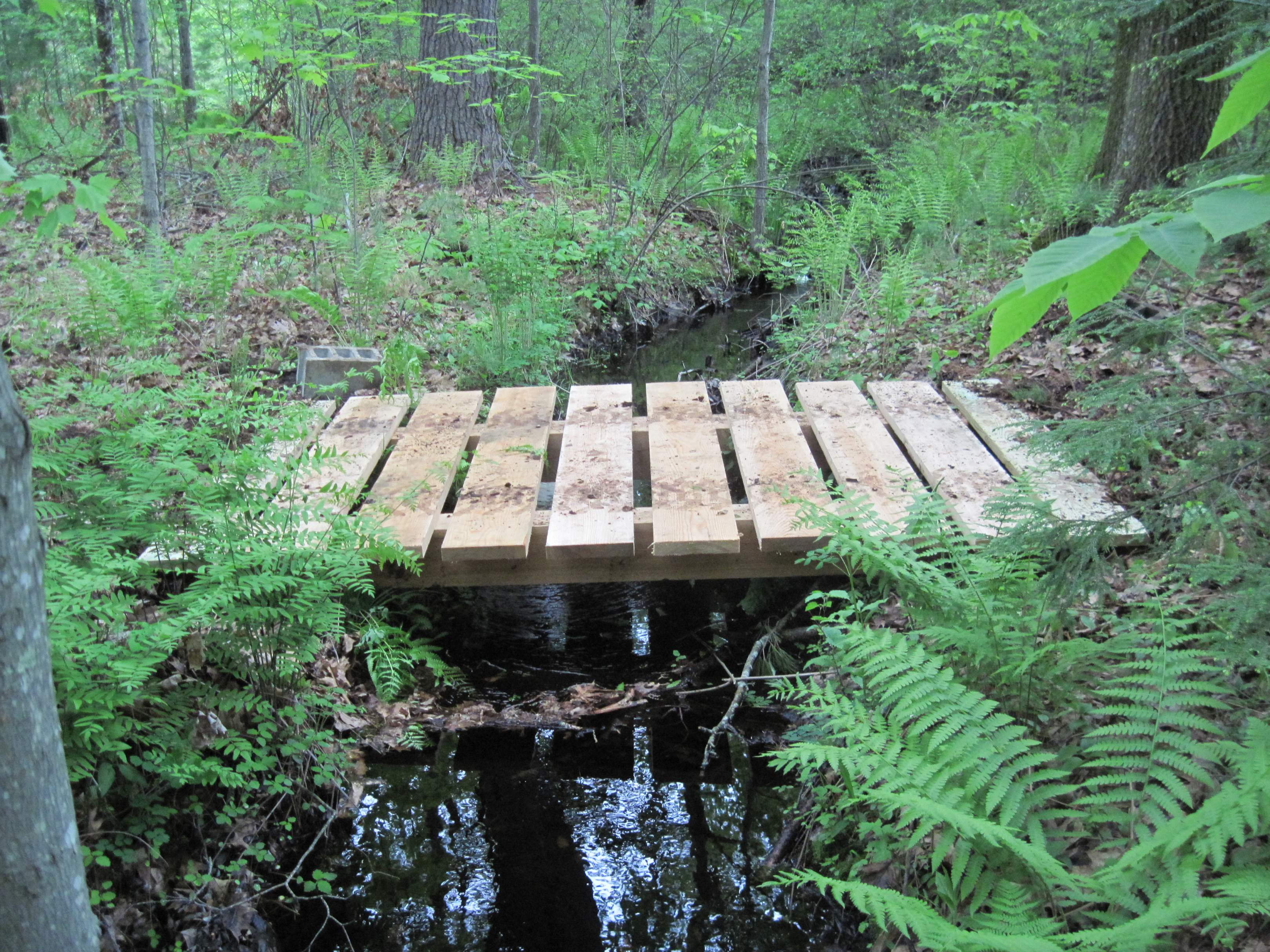

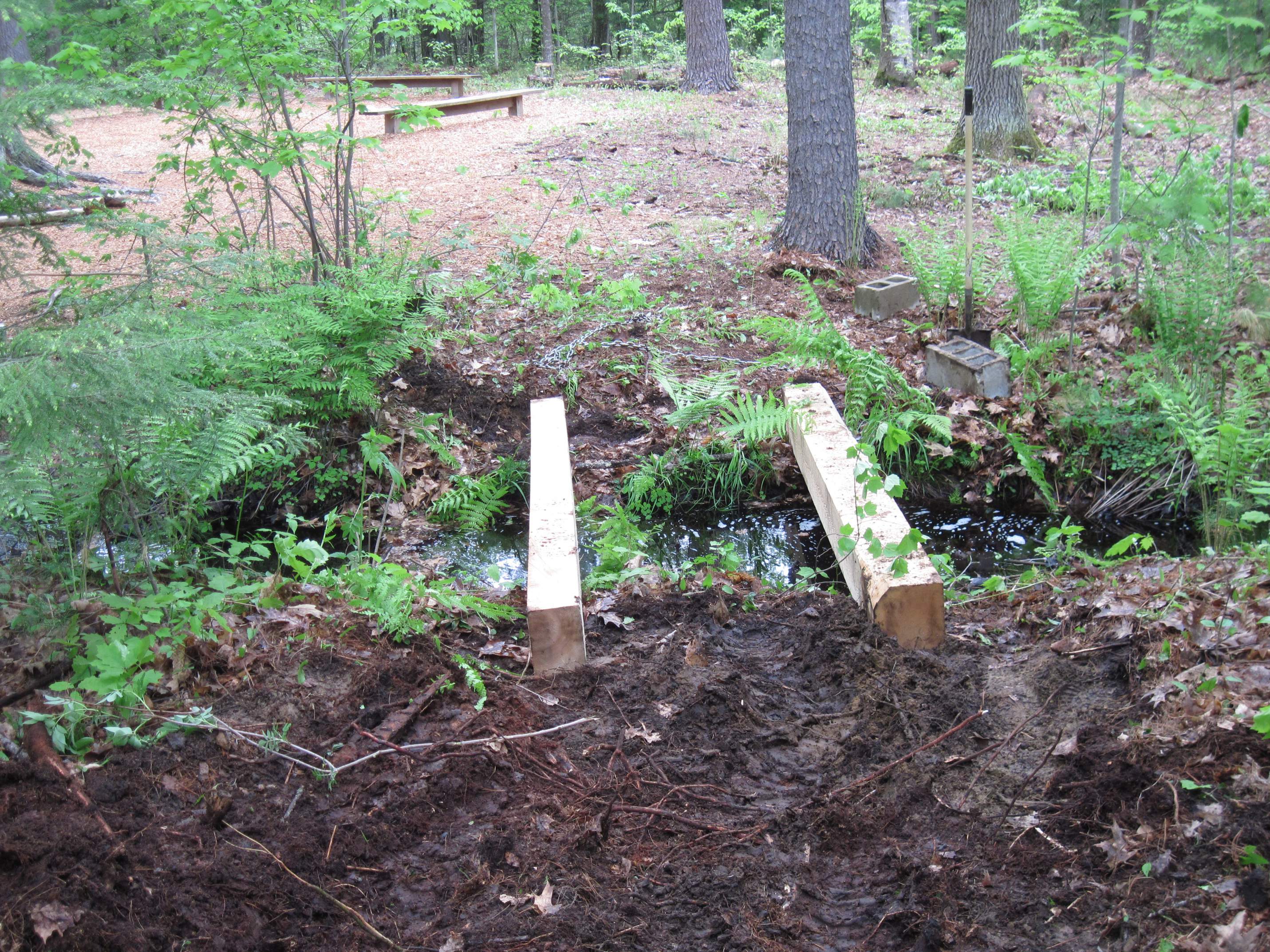

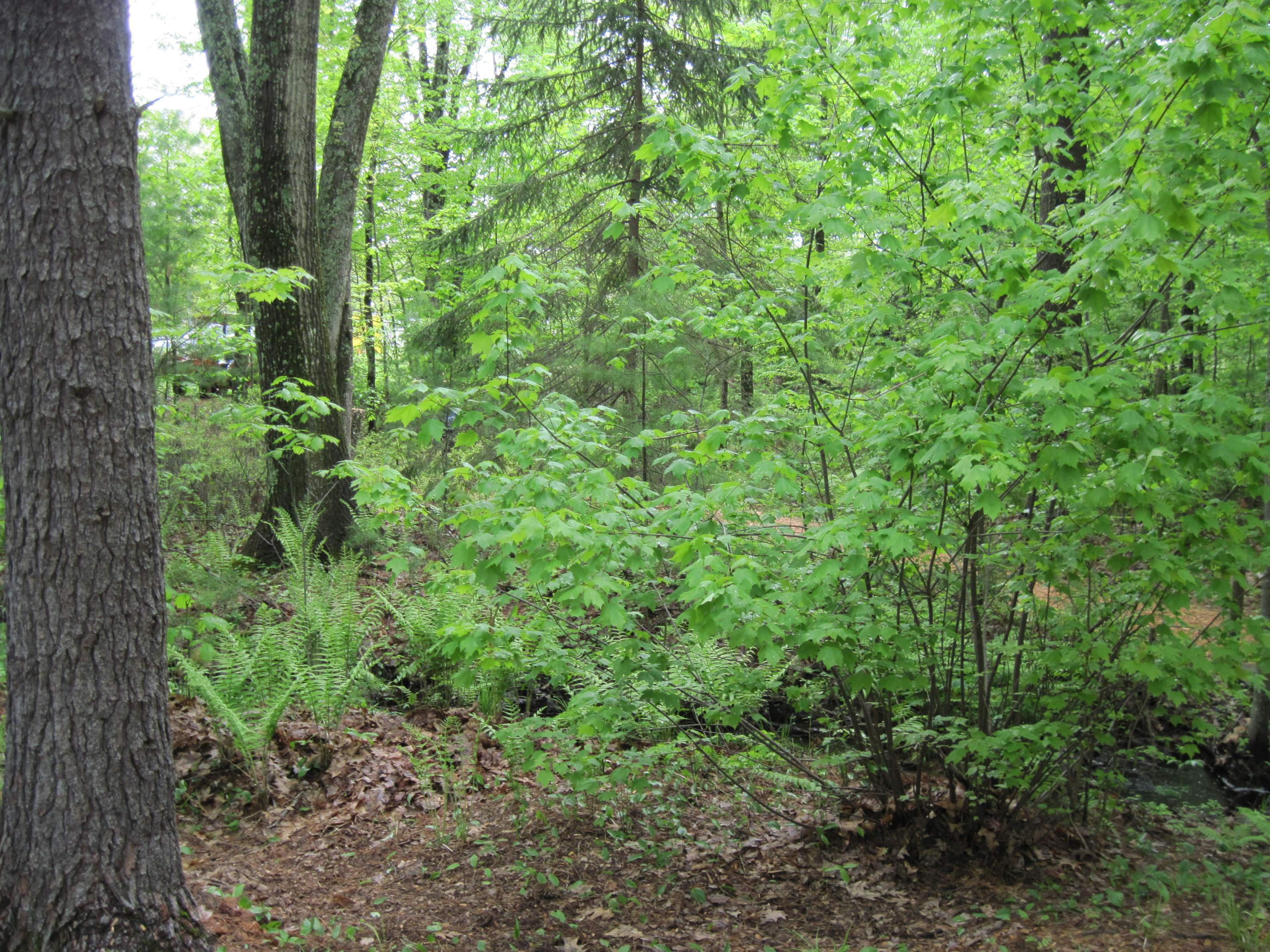

#16
Just an update. Got the bridge finished and it worked out great. I ended up going to a local sawmill and picked up a Hemlock 6x8x10 and a 8x8x10 beam. For planks, we got Hemlock 2x12x12 and cut them in half. When I laid the beams across the stream, I had just about 2 feet of beam on both sides on solid ground.
Since it didn't happen unless accompanied by pics, here they are: The 1st is where I will be crossing,..laying the beams....nailing the planks.....& the finished product

Actually, it wasn't as bad as I thought it would be. I was able to bring them down on the clamp on forks. I chained one end and crept over the stream to place the beam down.
/ building a small bridge #19
You made a nice little footbridge in what looks like a nice area for walking in the woods. Did the customer ask you to leave the bridge behind when you left? All it needs is a couple of handrails and they would be golden.
#20
They already had a footbridge. This was built lust to do some landscaping on the other side. They paid for the materials, so it has been left in place. I may have to go back later this summer for some other projects they may want done.
