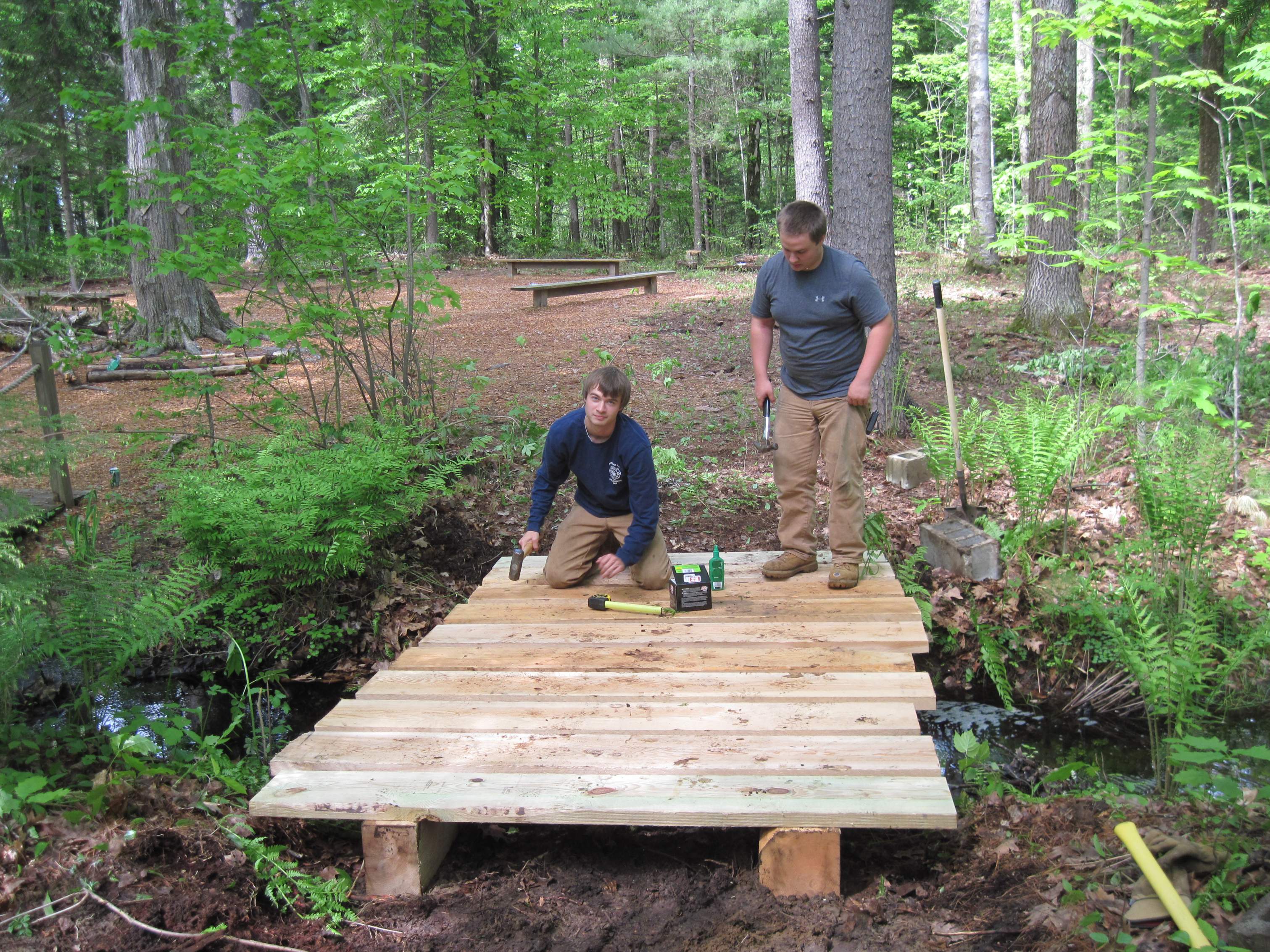

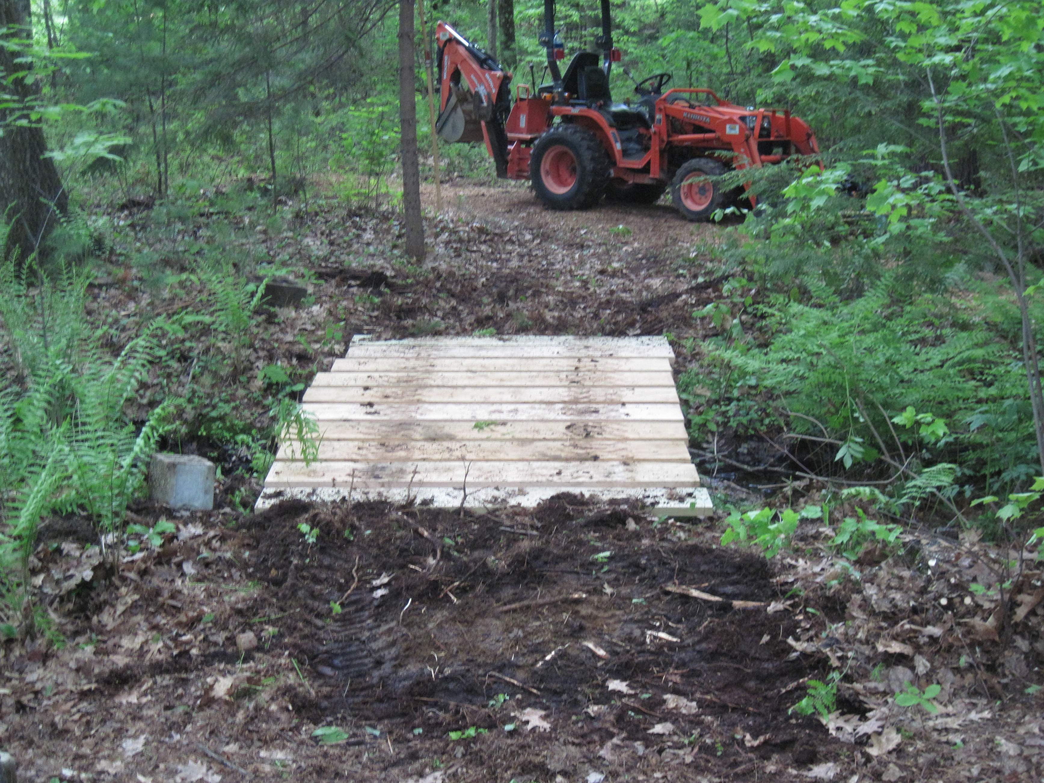

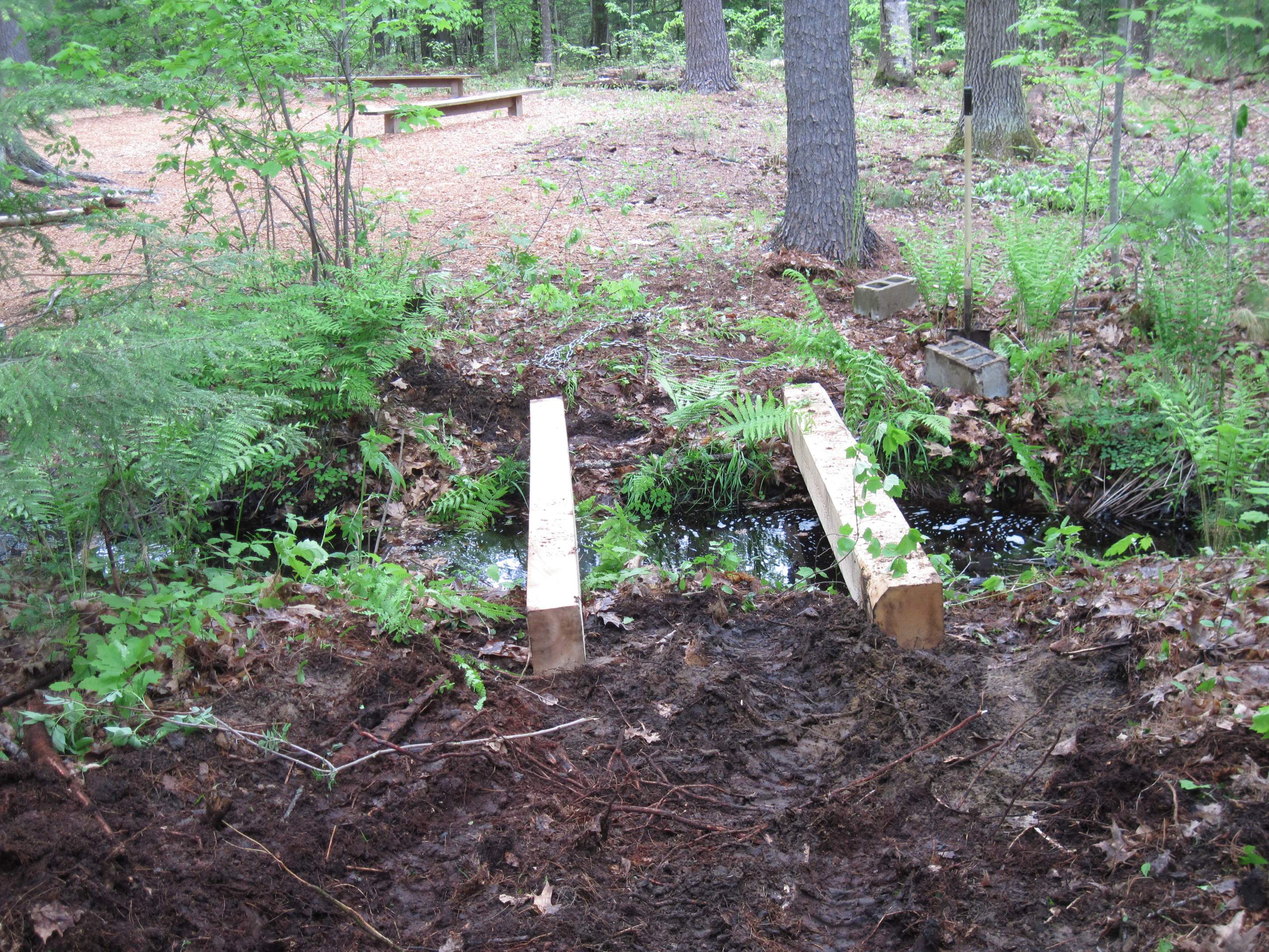

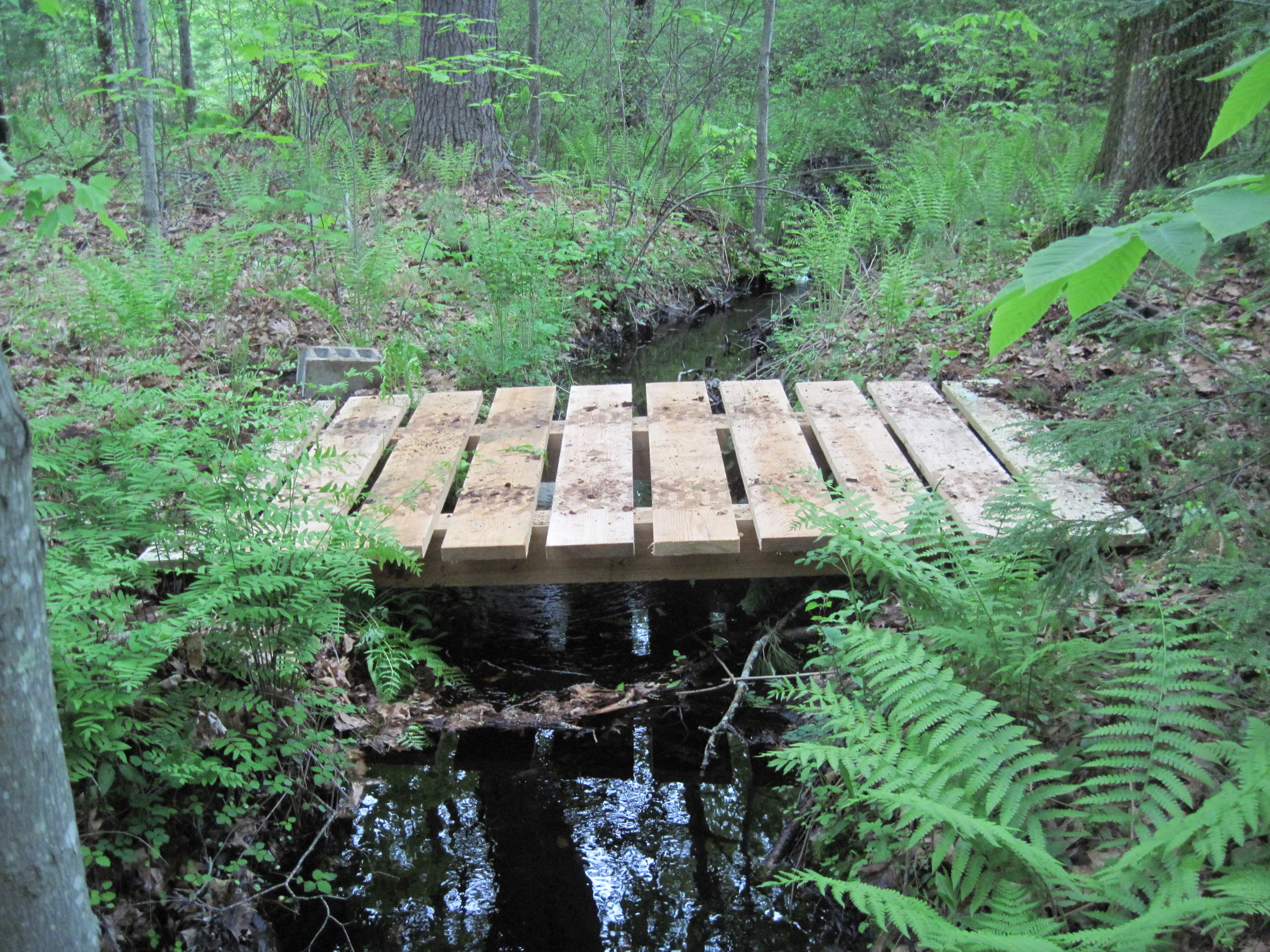

Just an update. Got the bridge finished and it worked out great. I ended up going to a local sawmill and picked up a Hemlock 6x8x10 and a 8x8x10 beam. For planks, we got Hemlock 2x12x12 and cut them in half. When I laid the beams across the stream, I had just about 2 feet of beam on both sides on solid ground.
Since it didn't happen unless accompanied by pics, here they are: The 1st is where I will be crossing,..laying the beams....nailing the planks.....& the finished product

Actually, it wasn't as bad as I thought it would be. I was able to bring them down on the clamp on forks. I chained one end and crept over the stream to place the beam down.

You made a nice little footbridge in what looks like a nice area for walking in the woods. Did the customer ask you to leave the bridge behind when you left? All it needs is a couple of handrails and they would be golden.

They already had a footbridge. This was built lust to do some landscaping on the other side. They paid for the materials, so it has been left in place. I may have to go back later this summer for some other projects they may want done.
