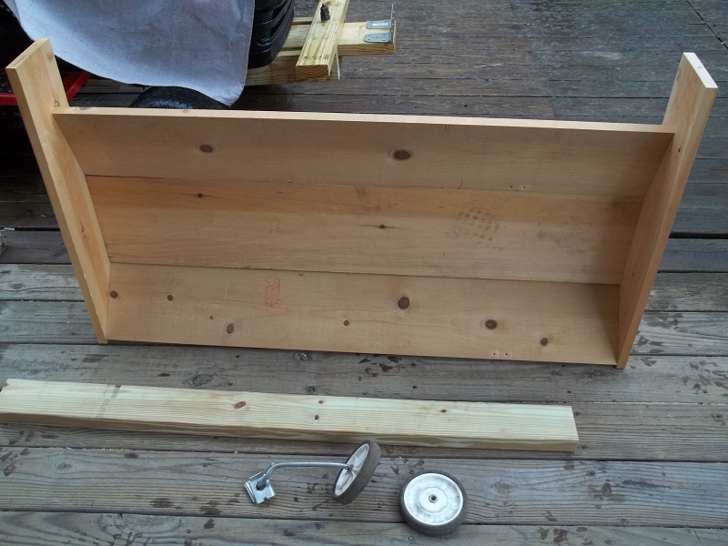

6_BLADE_SIDE
7_SNOW_BLADE_BRACE

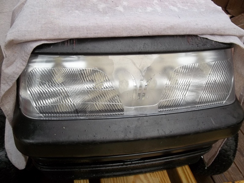

LED_LIGHT

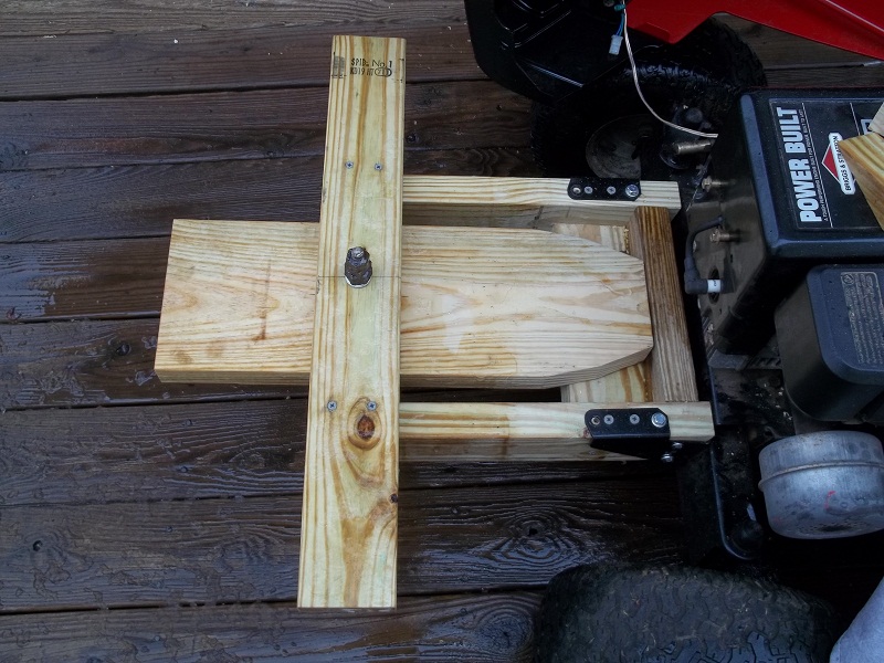

There are a few problems and concerns that i'm facing;
1.

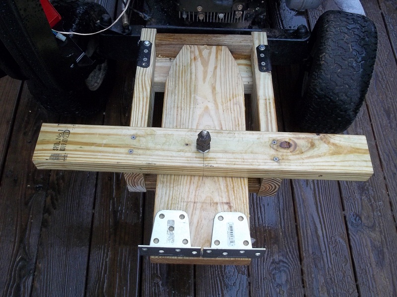

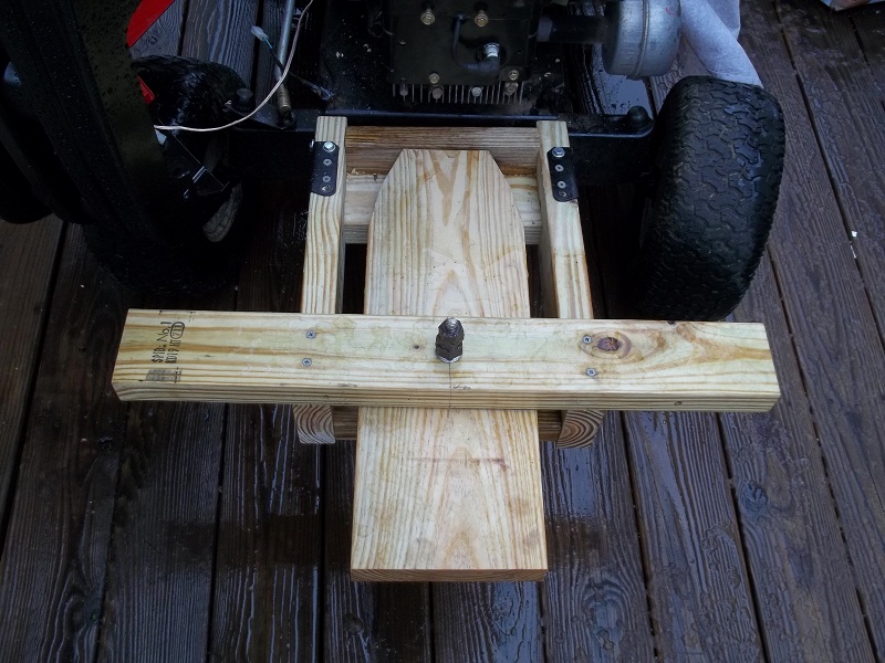

30 degree Angle (Pix number 3) if you look really close, it hit the back of my Bracket, this was designed for taking the force that is from the Blade and transfer it to there for Bracing / Weight. If I cut it, that force will just rely on the BOLT that is BOLTED to the front where it pivet.
I can't turn the Blade because it's too tight. If I cut it off a bit i'm concerned about the weight of the snow :(. My original plan was to put a PUSH PIN there so it will LOCKED to take some weights. But still haven't decided yet where to mount it to. If successful, I can only turn the Blade about 15 degree :(. Please help on this one, LOL
Also, I am planning to add the Motor to this area. This is where i'm planning to mount the Bracket to raise the Blade.

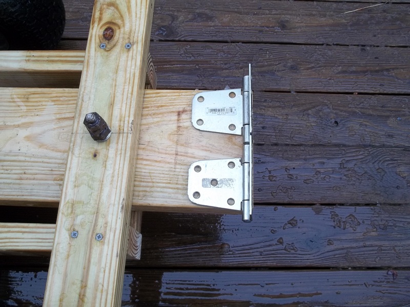

Pix number 2.
The Bracket that will lift the Blade up and down might be too WEAK for snow. With this Bracket, it will give the Blade about 110 to 140 degree upward, which is more than enough to BACK UP or even use the Blade as a shovel. My only problem to this is the WEIGHT of the snow and might be too weak.

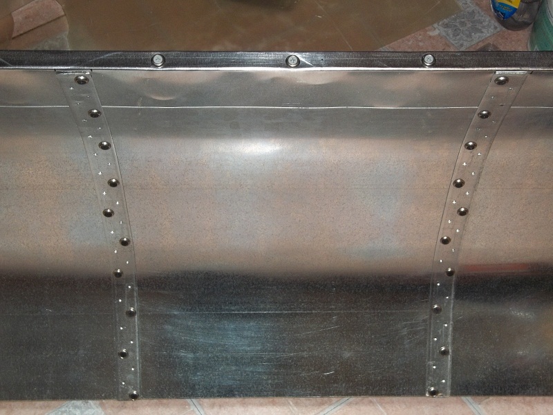

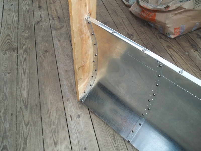

Pix number 5.
This is the Blade, I will cut the top off, not sure yet. I might be able to use it for something... The 2x4 is pressure treated is to mount it in the back where it will take all the force from snow. My only concern is that it might crack the 1x10and 1x8 boards since it's not pressure treated woods, just plain old Pine. The reason i use this is because of Weight issues. Too heavy to lift for backing up for a 12V motor even without snow. I can get a Winch, but that is money i don't want to spend, LOL. i want it to be FREE...
The wheels will be mounted on each side of the blade for moving purposes... about 1- 1/2" up from bottom.

Looks well thought out. So instead of lifting the blade the frame will be stationary and the blade will just tilt via the hinges? If so, that shouldn't take too much power to do. looks like you could trim the center wood for more pivot without compromising much. You need it strong on the grain line by the pivot bolt, not a big deal at the pointed tip that moves. These are my thoughts for you.
1)Screw a piece of 1/8" thick aluminum sheet metal to the pivot board between it and the frame. Run the pivot bolt though the middle of it and counter sink the screws used to attach it to that same board. This does 2 things, keeps the wood from splitting easily and makes for a slippery surface for the wood to slide on when pivoting. Without something sandwiched between the 2 pieces of wood it will not move easily because of the swelling wood and rough surface.
2)Make the frame so when the plow is tilted down that the back below the hinges rests against something strong. The hinges should be ok as long as all they do is tilt the blade and not bear any pressure from pushing snow.

I am afraid that your sides being fastened to the ends of the 'blade' will not hold together.
I suspect the first load that wants to tilt the blade will tear them out.
Suggest that the verticals be behind the 'blade' and they in turn be the hinged point.
I would not be all that concerned in creating a dished style blade but would rather suggest a straight flat pusher and I doubt your front end is heavy enough to prevent a snow load from skidding your tractor sideways.
In other words go for a flat straight push.

Answer to 1)
In the hole where I put the Bolt through, I have Washers and also where I drilled the Center hole of the 2x8 center piece. I cut a 1 3/4" water copper pipe and jammed it in there. This will help to make the Bolt move freely inside, also there are Washers sandwiched between the 2x4. I thought about the Wood spliting, gonna put a piece of Metal on top and bottom of that, you read my mind Mike... Did not think about Weather and Moisture Swelling, thank you for that thought Mike :)
Answer to 2)
When the Blade / Plow is down. it will rest on the 2x8 Center piece where you see the Bolt at. Although the Hinges is only for raising, it does rest but it does take a little bit of back and fourth motion. I did it this way just incase I have to replace the hinges or the Plow Blade. My only concern is now I hope the Blade don't hit something hard and ruin the non-pressure 1x6, LOL

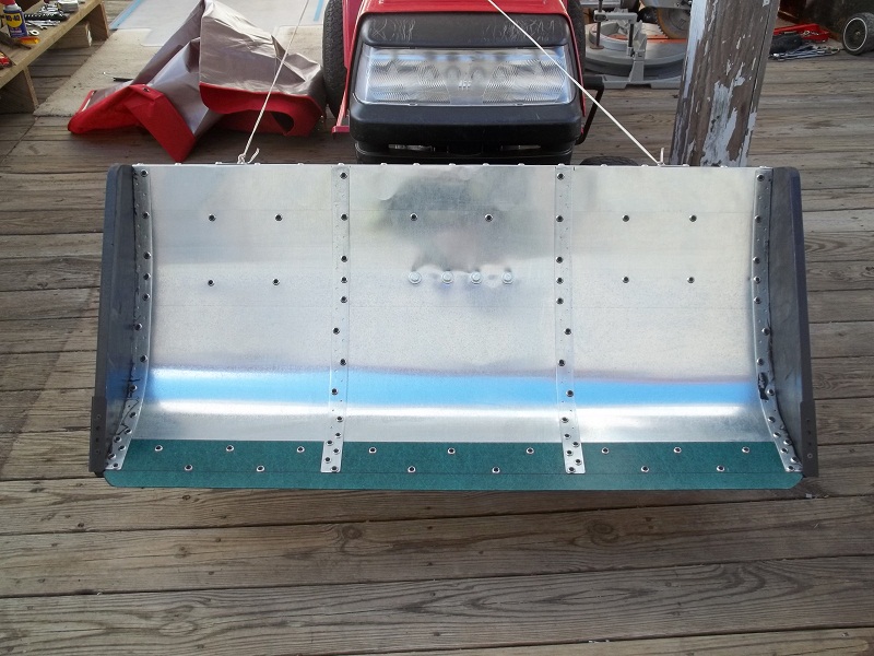

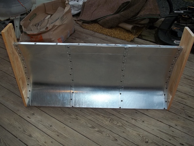

OK, so the Xmas is over..
Kinda busy plus it's cold out, I only did the Blade.
Had to spend some money to make it last longer.... What is the point making something that would NOT last :(
I bought a sheet of 20"X10' Galvanize Sheet, and some screws to make it look better, also some Paint to finish it ($30.00 total).
I figured, if I'm gonna get Shovels... Might as well buy the Galvanize Sheets and try it. it came out pretty good I must say. The Blade is about 23 1/2" so I had to double it, than brace it with the Brackets for heavy duty snow, LOL. Now it weight more than I expect it to be :(
Will post more Pix tomorrow afternoon :) Sorry for the delayed :p
Please Advice if you see anything wrong ;)

Very Impressive set up! I always thought about making one as well
/ Building a Snow Plow :) #14
It looks like you will not have enough angle available to plow left or right. I would also trim the end of the plow's perpendicular vertical support so the spillage isn't obstructed. You may have to add strength at this area by making the 1/2" (?) X 1.5", (?) to 1/2 X 4". Good luck and drive gently.
