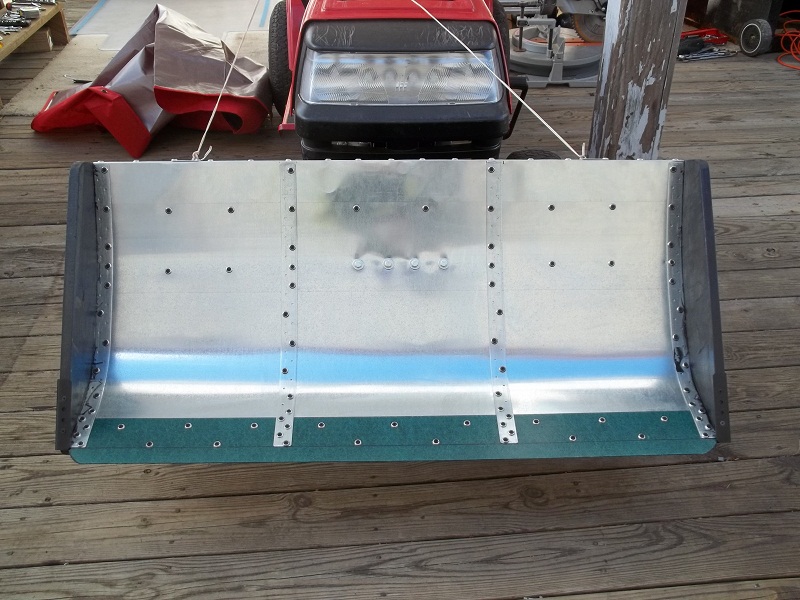

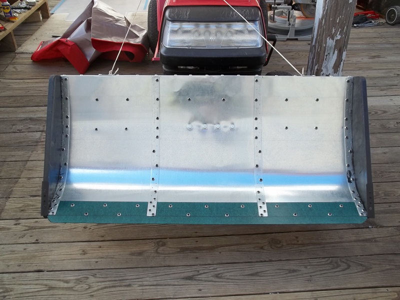

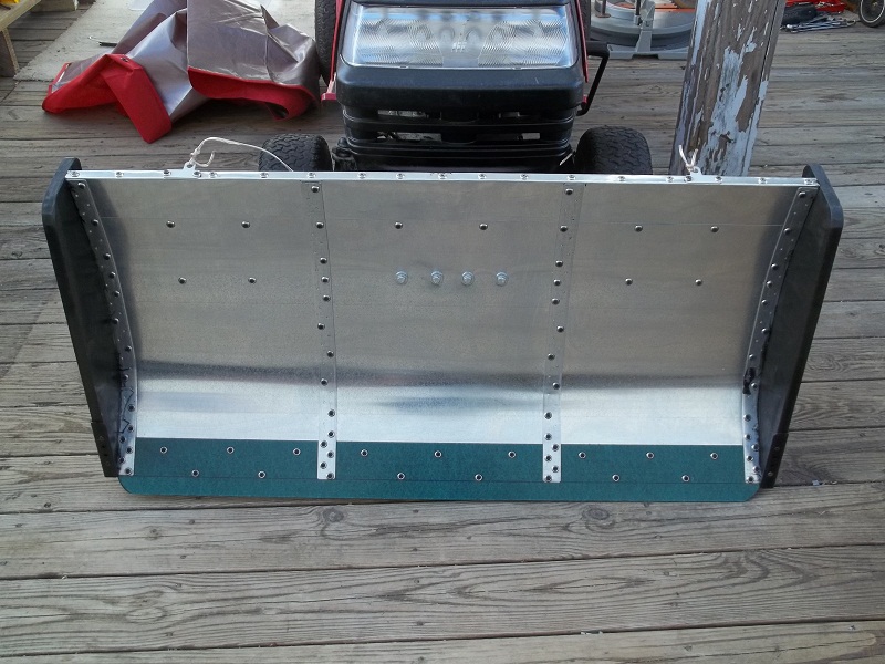

OK, so the Xmas is over..
Kinda busy plus it's cold out, I only did the Blade.

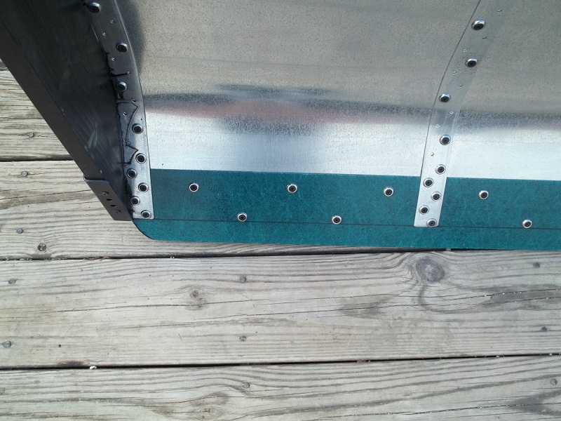

Had to spend some money to make it last longer.... What is the point making something that would NOT last :(
I bought a sheet of 20"X10' Galvanize Sheet, and some screws to make it look better, also some Paint to finish it ($30.00 total).
I figured, if I'm gonna get Shovels... Might as well buy the Galvanize Sheets and try it. it came out pretty good I must say. The Blade is about 23 1/2" so I had to double it, than brace it with the Brackets for heavy duty snow, LOL. Now it weight more than I expect it to be :(
Will post more Pix tomorrow afternoon :) Sorry for the delayed :p
Please Advice if you see anything wrong ;)
Before and After Pix below

Very Impressive set up! I always thought about making one as well
   / Building a Snow Plow :) #14

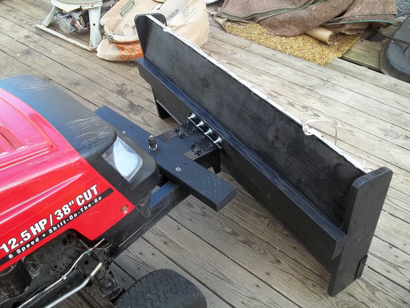

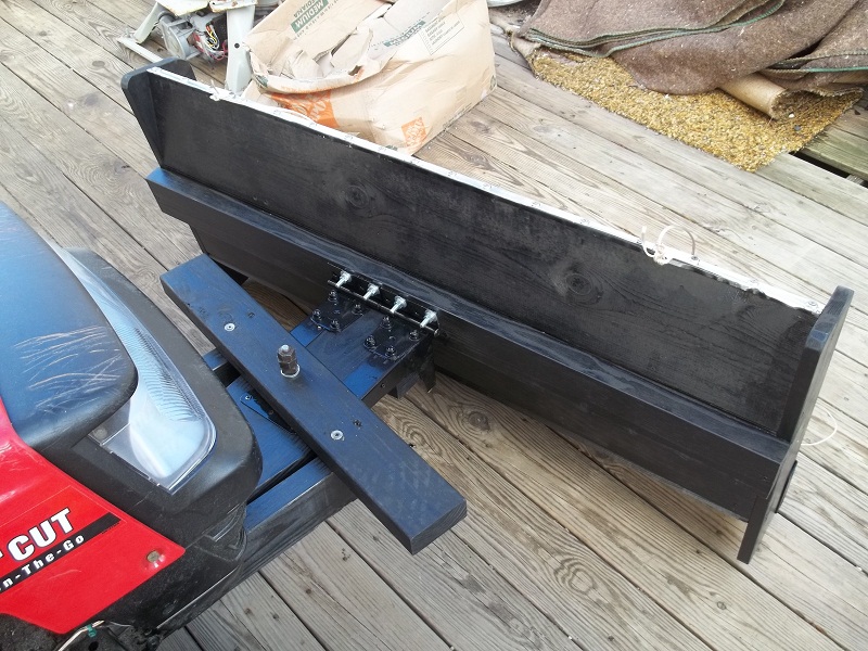

It looks like you will not have enough angle available to plow left or right. I would also trim the end of the plow's perpendicular vertical support so the spillage isn't obstructed. You may have to add strength at this area by making the 1/2" (?) X 1.5", (?) to 1/2 X 4". Good luck and drive gently.

Yea, the Angle kinda stinks.... :(

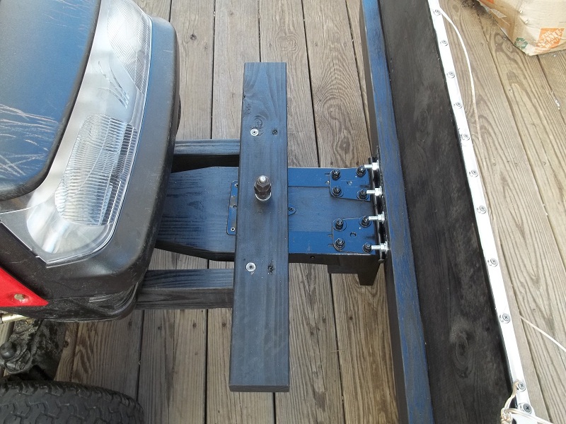

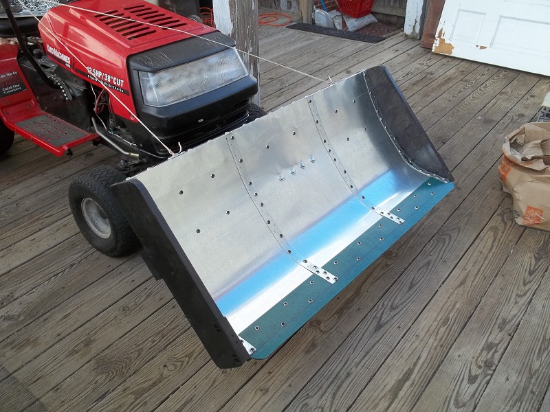

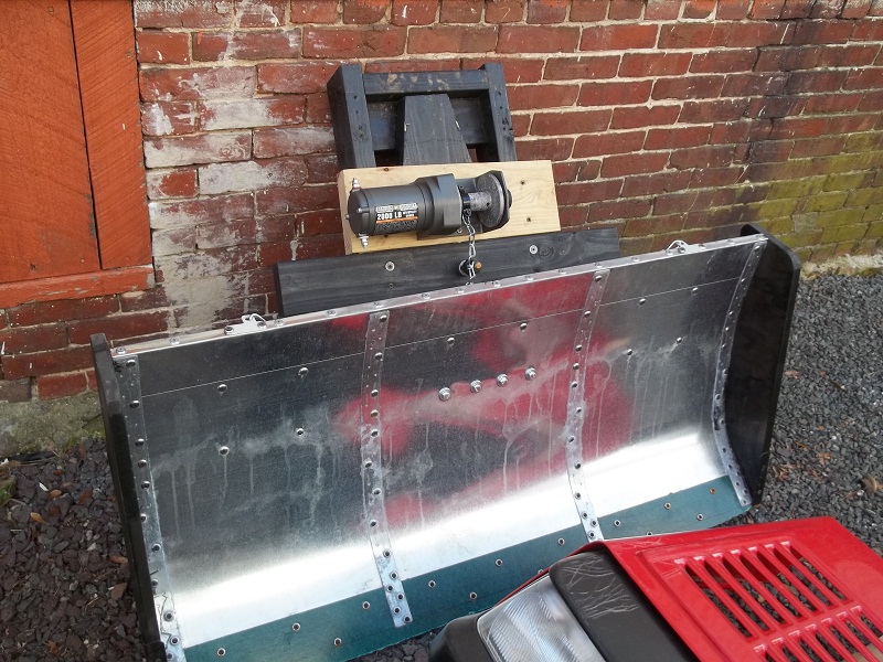

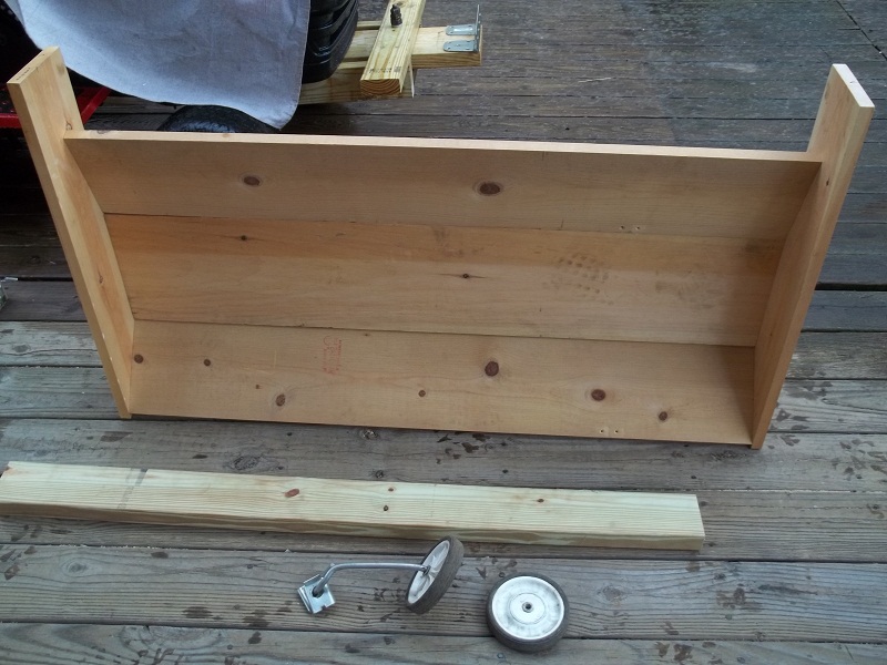

I also wanted to trim the end off too, but haven't think throroughly just yet. Here is the Updated Pix, waiting for a Winch so the Strin you see in the Pix is where the Chains are and the Winch would pull to raise it. Please look at the Pix and see if you can help me on anything, any comments is Greatly Appreciated!

I am not a wood person but I am very impressed. That angle may be enough for light to medium snow, I think it will work but it may not last long is you strike ice or an abject. Since your strings can hold it up if I were you I would abandon the winch idea and go with a reinforced diagonal bracket on the plow and a clamp on the deck adjustment handle. However you will need to incorporate some kind of swivel to permit the angle of the plow and the pitch of the adjustment handle.
On a side note, you may consider selling that plow and assembly to someone who admires wood products. You have done such a beautiful job that it is probably more valuable as art to a carpenter than a functional plow.
#17
Thank you for the Nice Compliments Zork! I was going to try and use the Winch from Harbor Freight since it was Cheap $50 Bucks. If all failed, I would get a Snow Plow for my MTD and use the Winch for Automatic Lifting.
On the Swilvel part, I was going to use a Spring Loaded Pin and add a 12V Motor to it to pull it up and release the Pin. My only problem to that is I need a 3 Point Holes somewhere on the Bracket so the Pin would Lock into each hole. Still haven't got to that part yet because my 12V Motor I got suck too much Power from the Battery.

Yes, the 3 holes are for the Auto Angle.
1- Left
2- Center
3- Right
This method is to Lock in the angle of the Blade, also take extra Force too not just where the Pivot is.

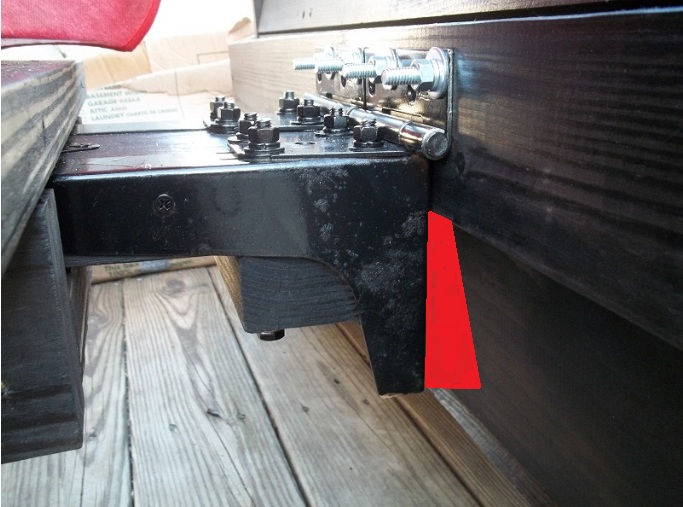

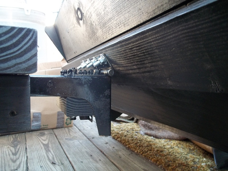

It is visually impressive, you do nice finish work. My concern is what is to keep the bottom of the plow from being pulled under the mount where the hinges pivot?
