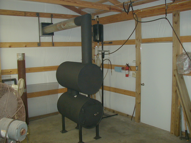

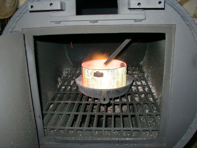

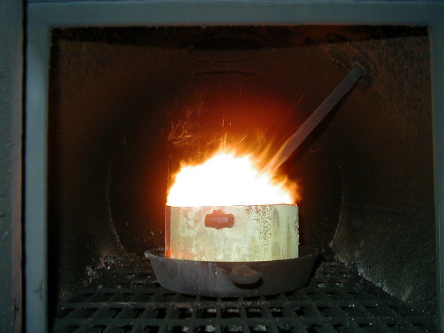

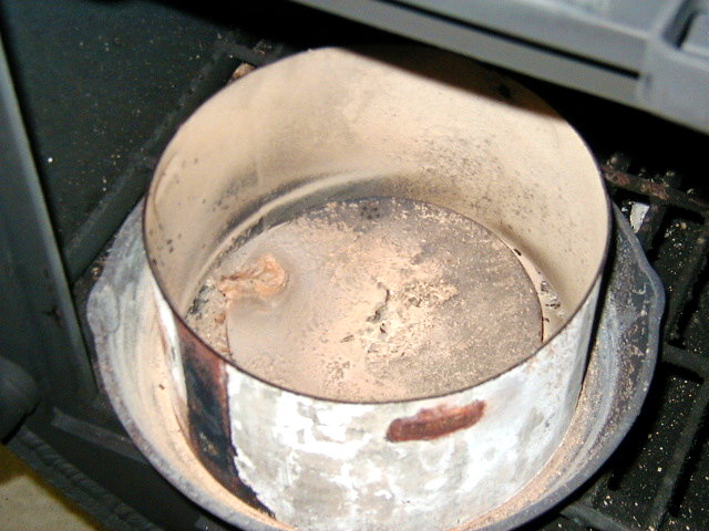

I have a few pictures during a test I did on Monday. I used air induction again. I was able to control the burn on Low, med and high and also had a clean burn which you can see in the pictures. I did add a air pressure regulator to my oil tank. I added a 8 inch diameter piece of my flue pipe around the conical so that I could control the flame and get the conical hottier. I could not get a picture of it, but looking down inside while the fire was going, the conical was fire red. In the one picture where you see the brown/tan spot, I used 2 ounces of kerosene and a paper towel to start the fire. I will not use the paper towel again cause it was hard as a rock to scrap off the conical. By the way, I sniped a air induction blower off of ebay. As soon as I get it, I will be installing it. Its 115 volts and the motor turns 3400 rpms.
Don...the pictures are proof of the pudding that air induction can and will burn clean and as long as you have the air and fuel ratio right and you have a hot flame. I dont have a picture of it, but I was getting zero smoke out of my exhaust pipe outside. All I could see was steam (white). Also, in the pictures, you can see how clean the skillet is, the 8 inch diameter pipe that is layed around the conical is. That was a 6 hour burn test. The ash that you see, that is still inside the stove, is from some firewood I was testing and also used to burn the green coating off the stove.

Nice job! It appears to me that the only reason you need a conical is for the initial start up - something to hold the kerosene while it heats up. If the conical gets fire red hot there is most likely no liquid in it at all during most of the burn. The main reason Roger Sanders used the conical was for liquid vaporization which kept the hard deposits out with his drip feed method. It looks like you are getting a nice clean burn and variable heat with your design.
