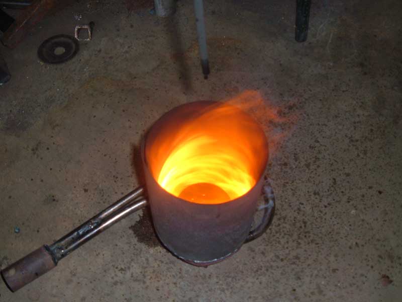

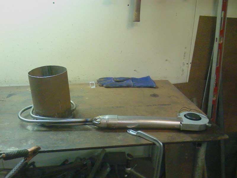

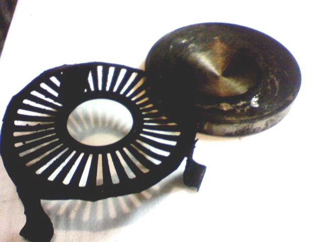

   / Building a waste oil burning stove for my shop #103
Here are a couple of test burners.
The first one is about 4 inch diameter fed with the air compressor turned down really low
The second one is 6 inch diameter but I cannot find the pictures of the test burn that I did with it but it worked about the same as the first one and I was able to vary the air fuel mixture to get a clean hot burn with no visible smoke.
The "conical" is 2 thick 2 inch washer with some rod welded between them to make sort of a barbell I figured when one got dirty I could flip it over and have a clean burner surface.
The largest problem was regulating the oil delivery. Just using a gas valve is extreemly hit or miss.
This thread has helped a bunch for ideas to regulate my oil flow.

   / Building a waste oil burning stove for my shop #107

Been there, done that with more than one build. What I'm trying to do is make a reliable burner that is simpler,- not more complex. If we could take a poll of all continuously used waste oil heaters I think we would be hard pressed to find one that takes less tinkering to keep it burning than Roger Sanders design. From what I hear, a few of the forced induction burners are so finicky to keep burning cleanly that many are abandoning their use. Roger did a lot of trial and error tinkering before settling on the design in his article (read it again from the link in the first post of this thread). His final design uses no electricity, is super easy to clean and start up, uses fuel efficiently and has variable heat output. Unless you need a very high BTU burner to heat a very large area this sure looks like a simple way to heat a shop.
Rodger Sanders design oil pool works and he is a great guy for posting it. But keep in mind it is a soot and ash maker because of the low temperatures. If that is all you want, believe me, thats great. But if you are looking for a reliable, hot, clean burn, with almost no ash or crud buildup. You need lots of air.
I attached a quick sketch (sorry about the quality as I am headed out the door in about 10 mins.) This is a proven design and a easy build. The oil and air are metered. The chamber gets very hot and holds the heat which is key to burning all the soot and crud. I used 1 ton brake drums but any size could be used if you adapt the design around it. I'm thinking heavy truck drums would work well, but you need much more btu's to make it efficient.
