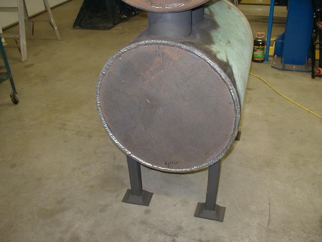

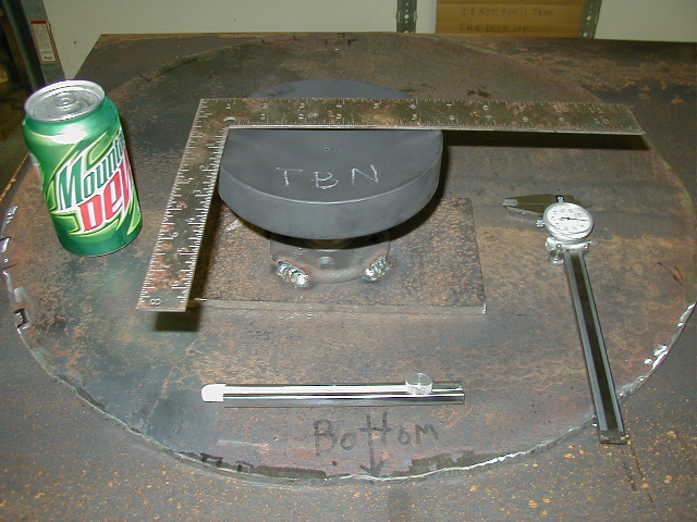

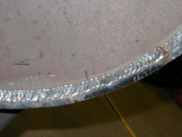

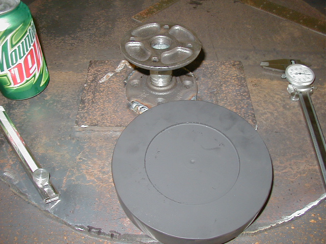

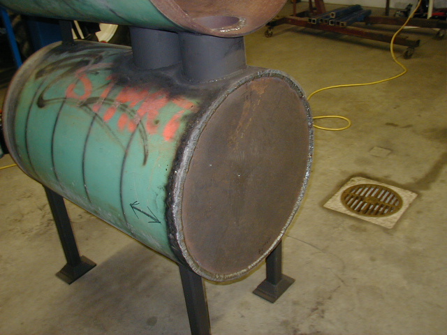

These picture are as far as I got today. The end that I welded up today. That took me almost three hours to weld. I kept hitting the duty cycle on my mig welder. So, to keep my welder from kicking the thermal overload out like I did twice today. I could only weld for about two minutes and had to stop and let the welder cool down for about 10 minutes. My mig is only 100 amp welder (Lincoln Pro 100 ). So, to be able to weld 3/8's steel. I have to weld like this--->ccccc. I got the conical cleaned up and I only painted it to keep it from rusting. I also got the grate supports (angle iron) welded in. I welded some 1/4 thick steel to the grate itself to keep it from warping. Remember, I'm still setting this stove up to burn firewood incase I decide I dont like the performance of burning waste oil.
Thanks,
Cliff

Nice. did you turn that conical? Hope you keep giving us updates.

LetsRoll,
That thing looks beautiful!! Nice work. If i understand correctly, you draft air in the proper ratio with the amount of oil flow?
Is that correct?
In a standard oil burner they check smoke output & temp. to adjust air, but also, the old tiemrs can tell by looking at the shape and color of the flame.
On this burner, will you have a "view port" or another way to see if the air/oil mix is efficient?
Again, great work, looks like a winner!

SkunkWerX said:
LetsRoll,
Is that correct?
Yes and no. Oil flow is not my main concern (flame quality). The quality of the burn is what I'm trying to control here. When I can control how the flame looks (efficient burn) and how much heat it puts out (overall temperture). These two will be what I'm shooting for or what I'm chasing after. As of now, I have small clue what the air and fuel ratio should be. I have a ball park idea, but that will need to be fine tuned. When I get this stove done, the first thing I have to do is burn it outside cause there is a hard plastic coating on the outside the bottom and top barrel. Starting it up outside my shop will burn this coating off. Once the coating is burnt off. I will start taking notes for a hot burn and low burn. How much oil will be dripping into the conical on a low burn per hour and the same for high burn. Also taking notes on how much air is being allowed during low and hot burn. Also noting what lower and upper limits of air for the low and hot burn. After I get these notes writen down. I will turn the oil flow off and let the stove cool down. Then I will try firing the stove up and see what it will take to start the stove with no or little smoke. Just trying to see what the best method would be. Which I already know I will not be able to do. But I'm going to give it a try or look more into it. Cause I really want this waste oil burning stove to work to my standards.
