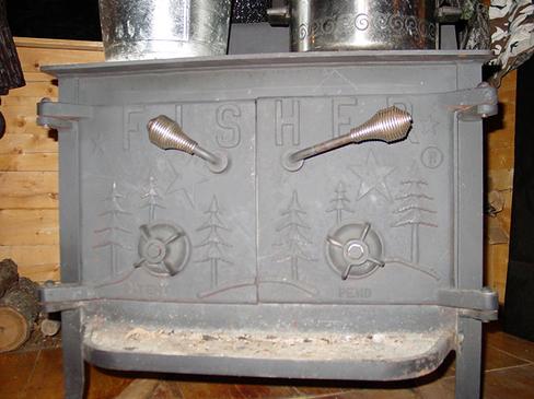

First let me say sorry to LetsRoll for taking over this thread - your work looks great and it has inspired me to look into this so Thanks.
I currently inherited (when I bought this house) a wood burning stove. A simple Fisher steel box. I was all set to hook it up when I read all of the stuff about insurance issues etc.
After reading more stuff, although it is more of a pain in the a-- and I will lose a bunch of therms, a remote external boiler hut seems like the way to go for safety and insurance reasons. I plan to fabricate a tank around my current stove as well as drill a couple of 1.5" holes and weld in some heat exchange tubes. To simplify things, I am going to design a non-pressurized system with a breathable expansion tank.
Per earlier comments, I cannot argue with the pros, I will put the pump on the hot side. You guys have more experience than me with these things. Based on things I have read and heard, with a good fluid flow, the temp won't get that high in the system.
I am expecting to have to use a anti-freeze 50/50 mixture because the system will not always be in operation .... Bad idea???
I found this image of a Fisher model similar to mine. Let the Frankensteining begin!
Letsroll - Lets see how your project is coming along. As mentioned, you get full credit for inspiring my future efforts!

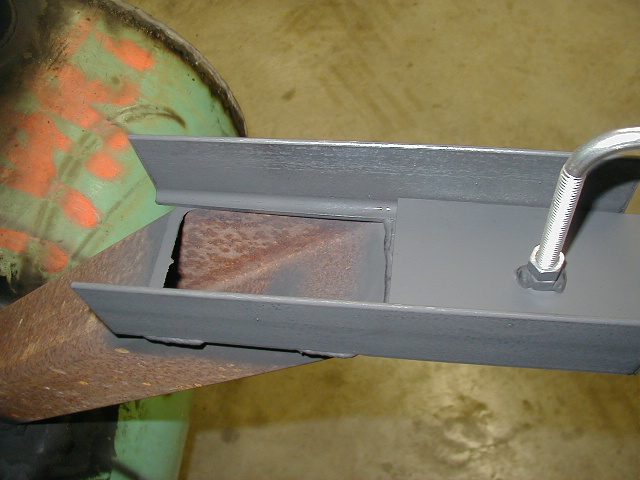

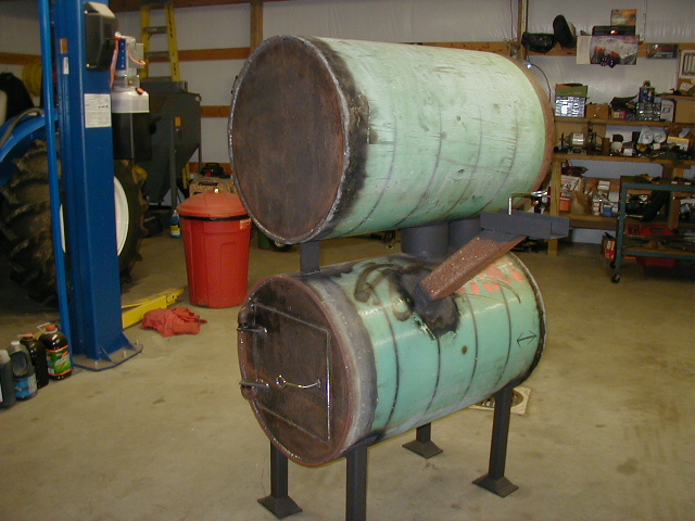

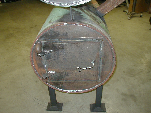

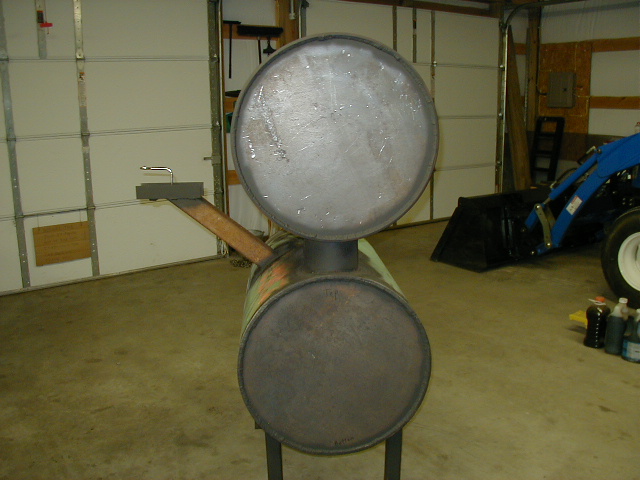

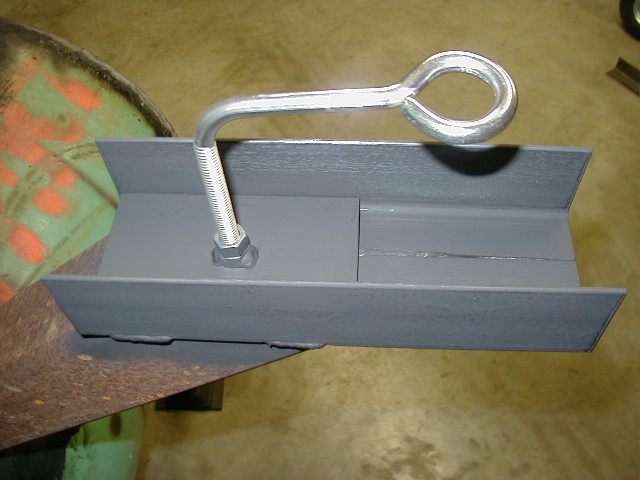

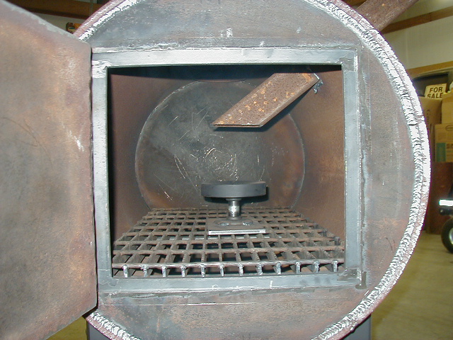

Dec 1 (Saturday), and Dec 2 (Sunday), I got to work on the stove. Saturday- I worked on the stove for about 16 hours (7am-11pm). Sunday-after we got home from church, I worked on it for about four hours. I've pretty much have the stove itself finished. I just have to drill a hole for the oil line going into the intake pipe. I still need to cut a hole for the exhaust pipe. But that wont take very long to do. Finishing the stove itself is were I wanted to get this weekend. As of right now, I'm not sure if I want the exhaust pipe to exit my shop through the roof or the side wall. Also, I'm not sure were I'm going to put the stove at. Right now, I'm just thinking about the best possible place to save space since my shop is only 30x40 (1200 sqft). I have an idea were I want it at, but I have to decide then were the exhaust will go (roof or wall). If I go through the roof, I'm not sure how I will seal the pipe going through the sheet metal. The sheet metal is not flat, so sealing is a concern here. I'll probably just end up going out through the wall. That route will take allot of time. But, I know I will probably feal better taking that route.
As for the stove, I just wanted to finish it so I could use it before winter is over with. I ended up not putting in a door for cleaning the top barrel. I will do that this coming spring or summer. I also did not put in a peep hole so I could see how the flame is looking. If I need to look, I'll just open the door. As for the intake pipe, I did install one. You can see it in a few of the pictures. I added a plate so that I can control the amount of air entering the intake pipe. Next to do is work on the oil tank. So, that will be the next step that I will hopefully get done soon.

I love the cheesey door hinges! I'm going to use that idea the next chance I get.
Are you planning on running your fuel tube down the air intake?

Those door hinges is what I had laying around the shop. They worked out rather well. Yes, the oil line will run down the air intake tube. I just have to drill a hole for the line to pass through the tube. I just have to decide the size of the oil line to use as well.

LetsRoll, Without implying it won't work, why did you bring the air in at an angle without any downward transition? Have looked at the plans & hope to build one sometime. The author stated he has an oil supply on a hill behind his house to supply pressure for flow control. A couple of weeks ago I scored 2 -7 gallon paint pots with regulators & guages from the dumpster at work. Will incorporate into the design. Keep your progress coming. BTW, That's one beautiful stove. MikeD74T
