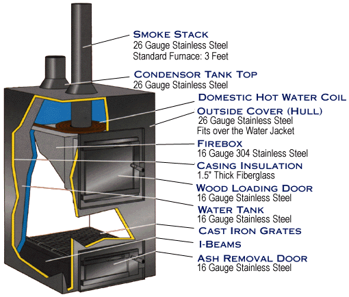

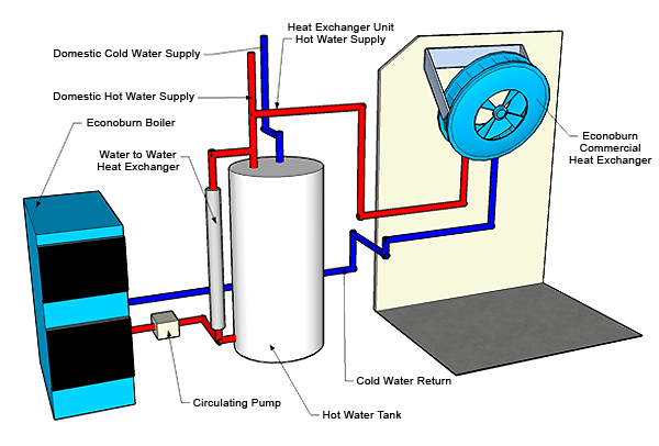

   / Building a waste oil burning stove for my shop #40
I found these two images / diagrams that clarified things as well as caused more questions. Why would you want to put the circulation pump on the "hot" side? I would think that it would cause less stress to the pump if you were to put it on the cold side and push rather than pull the hot water.
I also read on one of the systems that it operates under normal atmospheric pressure ... basically an open system not pressurized.
