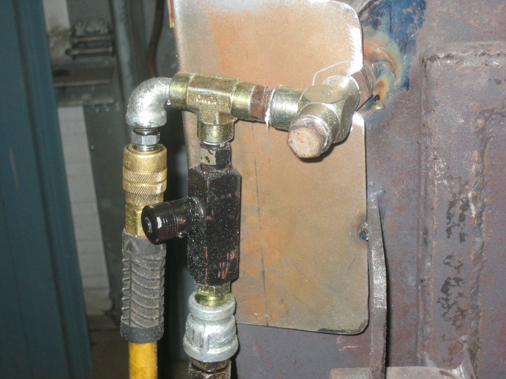

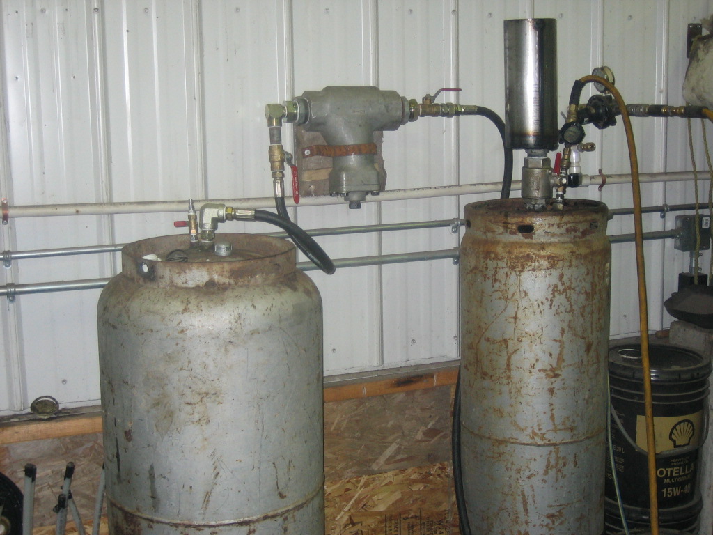

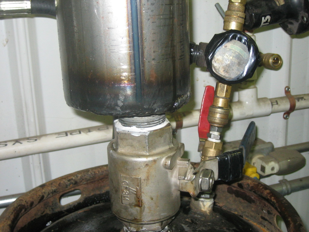

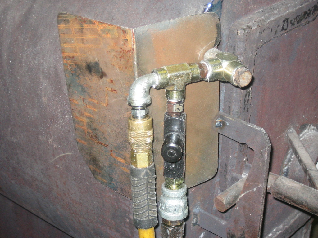

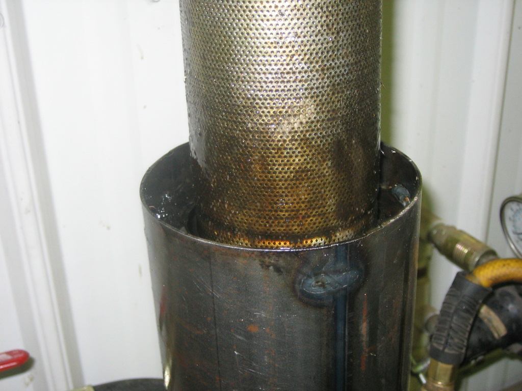

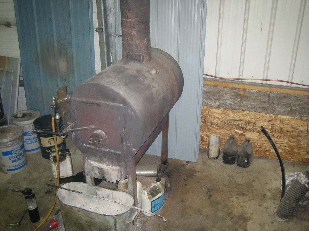

As for feeding the conical, why not bring the oil line up from the bottom into the center. That way the flame is not trying to coke the oil in the line.
The following pics are what I have come up with so far to feed oil to a wood fire. I going to see how my supply last to see if going straight oil is justified.
I have a 100 lb lp tank for the dirty tank and a 200 lb?? for the secondary tank. Oil is poored through a strainer and a 2" ball valve into the first tank. Which is then sealed and pushed with regulated air into a finer strainer and into the second tank. From there it runs through a hydraulic filter, a hydraulic flow control valve, at @ 45 psi, it then goes into a mixing chamber were 5 psi of shop air is introduced and the mixture is pushed through a pressure washer 30 degree nozzle to atomize the mixture somewhat overtop of the flame of the wood fire. Once the stove reaches 500 degrees the oil burns on its own above the fire. The flow control valve must be set below 1 1/2 turns when the stove is cold and reduced to 1/2 a turn once its up to 500 degrees. If more oil is fed the stove temps will climb up over 900 f
Warm weather has prevented me from testing it for more then 2 hours at a time.
Ken
