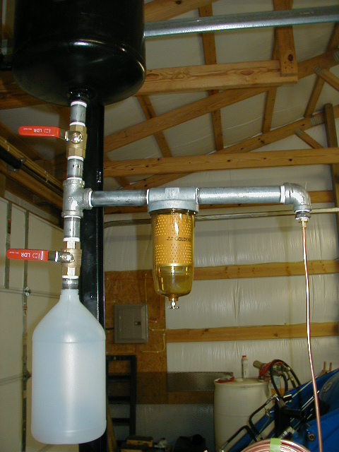

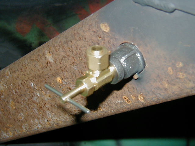

The oil tank I was planning on using, ended up being junk. The inside was rusted pretty bad. I ended up finding several small rust holes in it. The place that sells 55 gallon barrels real cheap, was closed on Saturday. So, I have to wait and get one Monday. I have all the fittings, copper lines, ball valves and needle valve, plus a fuel/water filter. My oil drain setup will go like this. Coming out of the bottom of the tank is a 1 inch pipe, then a 1 inch ball valve, then a 1 inch T. At the end of the T is a trap with a 1 inch ball valve for draining trash and water. In the middle of the T fitting, is another pipe that will go to a fuel/water filter that also has a water drain at the bottom of it as well. Coming out of the filter, is a 90 degree elbow that goes down to the 1/4 inch copper/brass line that will go into the air intake tube on the stove. Attached to the 1/4 inch copper/brass line is a 1/4 inch needle valve. Right before the 1/4 inch line reaches the conical, the line will drop down to 1/8 inch line. With this setup, I should be able to control the oil flow to the stove as well as controlling the trash and water. If I run into a oil flow problem, I might just put some fittings at the top of the tank for a air nozzle and a air pressure guage. Then I can hook up a air hose and pressurize the oil tank. I have a portable oil tank for collecting oil when I do a vehicle oil change. When this tank is full, I put the drain hose into a empty barrel and put about 5 to 10 lbs in the tank. The air pushes the oil out of my portable drain tank into the empty barrel. This setup is what all mechanic shops use and none of them have had a problem. So, this is were I stand at this time. If my old compressor tank would'nt have been rusted/junk, I would had a chance to fire it for the first time this weekend. All well, I should be able to fire it outside this coming week/weekend. I'll keep you guys updated as I go along. Sorry, no pictures this time. :eek:

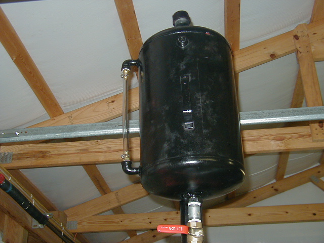

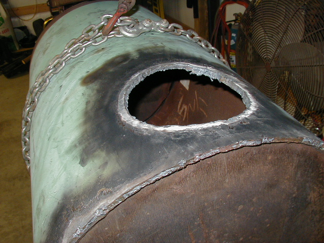

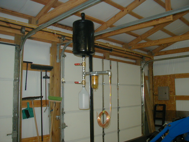

Just to let you guys know were I stand at this time. I have the oil tank finished, I have the feed line inside of the stove also. I also have a hole cut into the top of the stove. My plan was to drag the stove outside this weekend and hook up the oil line from the tank. The tank is a 10 gallon air tank that I had laying around my shop. The air compressor tank turned out to be junk, so I used an old air tank. I went to a company that has empty 55 gallon barrels, but they were out of them at this time. So, instead of waiting for more to come in, I moved on cause I wanted to get this stove project going. I might still get a 55 gallon drum this spring. Anyways, this weekend was not the time for me to get the stove outside and get it going. It has rained/stormed all weekend. As of right now, I ready to do some burn test to see how well my stove will perform during a low and hot burn and how well I can control the process. All well, I just have to wait until this coming weekend. I need a full day so I'm not pressured for time. I have a few pictures of the oil tank and stand that it is welded to. On the side of the oil tank is a clear tube. This will tell me how much oil is in the tank. I wont have to climb up to the tank and look inside to determine much much oil is in it, just look up and see the oil level in the clear line. As for the plumbing, the bottom ball valve is only for draing water and trash that collects in the drain pipe. I also have a water and trash filter to collect anything that gets past the drain pipe (drop pipe). One thing that I didn't do was add a air fitting and guage like I said I was going to do. I was going to add them incase oil flow was a problem. I have a threaded bung at the top of the tank, but I put a plug in it. If oil flow comes to be a problem, I'll remove the plug and insert a air line fitting and a guage. My tank is rated up to 150 psi. 5 to 10 pounds of air pressure wont be a problem for the tank, if oil flow is a problem. I also have a picture or two of the oil line, needle valve and the oil line to the conical. The last picture is the hole that I cut into the top barral of the the stove. This is were the flue and damper will be welded too. Since I need to drag the stove outside, I have not welded the flue pipe to the stove yet. I'm adding a damper just incase I'm not satisfied with the performance of burning waste oil, I'll just remove the air intake tube and start burning wood. But, I'll have to cut a air intake hole in the door for the firewood to burn right. Hopefully, I'll be satisfied with how the waste oil will perform.
Enjoy......:D
Thanks,
Cliff

As far as separating out any water from the fuel, won't the water float on top of any fuel you are likely to use? Even if a little water somehow got to the burner it would probably not stop the stove.
It is the other way around. Water is heavier than any fuel and therefore will fall into the bottle that he has straight down from the tank. You do do very nice work!! I am curious about the test firing!!

Don't forget you need a low pressure regulator to maintain your desired air pressure on top of your oil. (Maybe you have it already and I missed it in your description). As the level drops, so does the pressure and so changes the burn. If you don't have one you can increase the ratio by adding another large buffer tank to the top side of the oil tank (connect it with an air hose). But still, for a long burn a regulator would be best.
Looks great, keep us in the loop!
