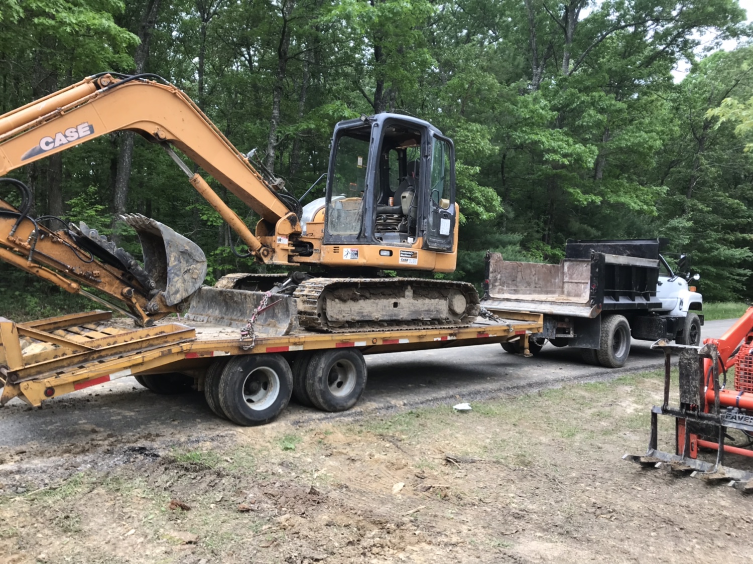

I don’t think my trailer bottoms out. This was probably over the axel weight and it didn’t bottom out.

I’m glad you are happy with your trailer. The underside of the decks above the two tandem axle equalized spring suspension trailers at my workplace aren’t scuffed up by the tires and the axle tubes do not beat against the frame. Your photo clearly shows why I will never be a fan of multiple torsion axles on a trailer. More photos will not change that.
We do not have to agree and clearly we do not. I merely took the opportunity to use your pic to emphasize my point, thanks for posting it.
