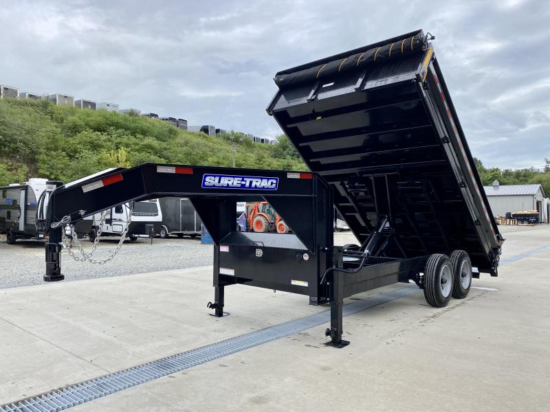

On the trailer shopping front:
I found a Sure Trac 16ft x 102” deck over, fold down sides, 17.5” rims and tires, 16,000GVWR trailer for a good price. It has an 11,000lb payload which is less than I wanted, but it doesn’t include any tongue weight. Add tongue weight and it really has more like a 13,000lb payload. Has an oversized scissor hoist, dual 12k jacks, a very handy tray under the bed with a spare tire/wheel and corner stabilizing jacks.
I may move on it, but I’m comprising on my original 6-7 ton payload.

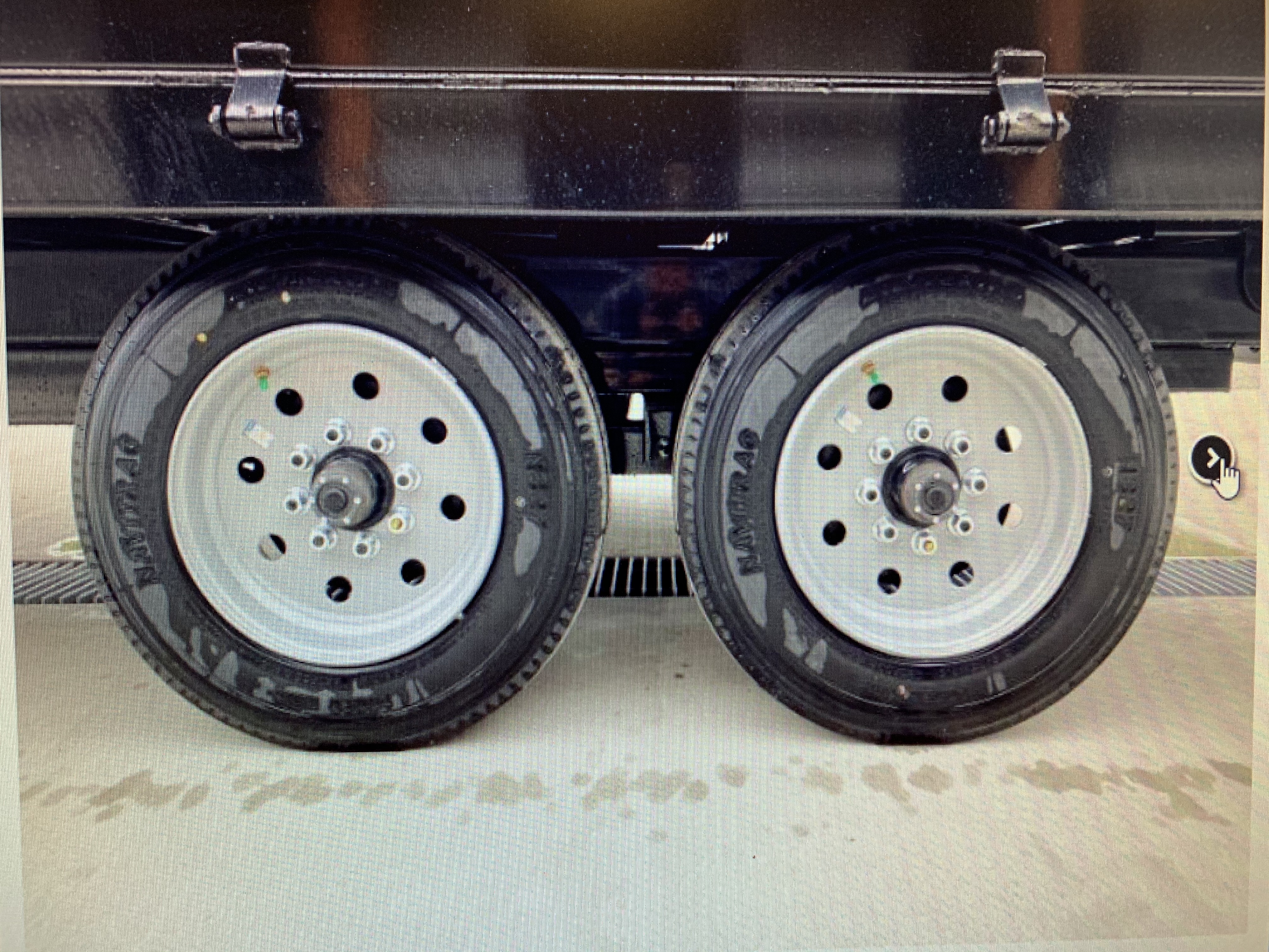

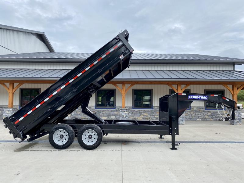

oil bath hubs 8k axles
The one in the picture is a 14 footer. They have 2) 16 footers coming in for $12,995
I feel my wallet lightening and Im really liking the look/feel of this trailer

The only thing I don't like about that one is that the spare tire is underneath the bed. If you have a flat tire with a full load on you're going to be in a world of hurt.

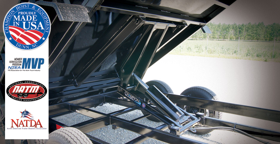

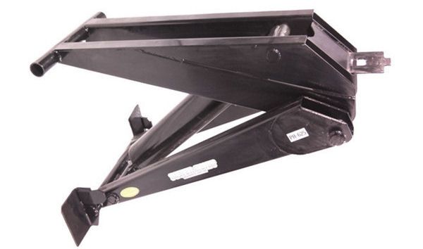

Pick the bed up. I like it, I can't lift my 17.5" spare up on the gooseneck, I have to use my loader, they are 100+ lbs. Then try and walk around on the gooseneck frame, scary dangerous. I see it has bolt on jacks, nice. Mine are/were all weld on and inside the tool box, poor design. I see it has a 12" gooseneck riser but maybe only 8" horizontal? Kind of hard to tell in the picture. If it is 10" that's fine. Again, hard to tell in the picture but it appears to use a light duty scissors frame and only one tail gate cam lock. Sorry about the armchair quarter backing, Lol Over all looks good.
Note the channel frame v/s the tube frame in the pictures.
  • Trailer hoist brochure front2 (1).pdf

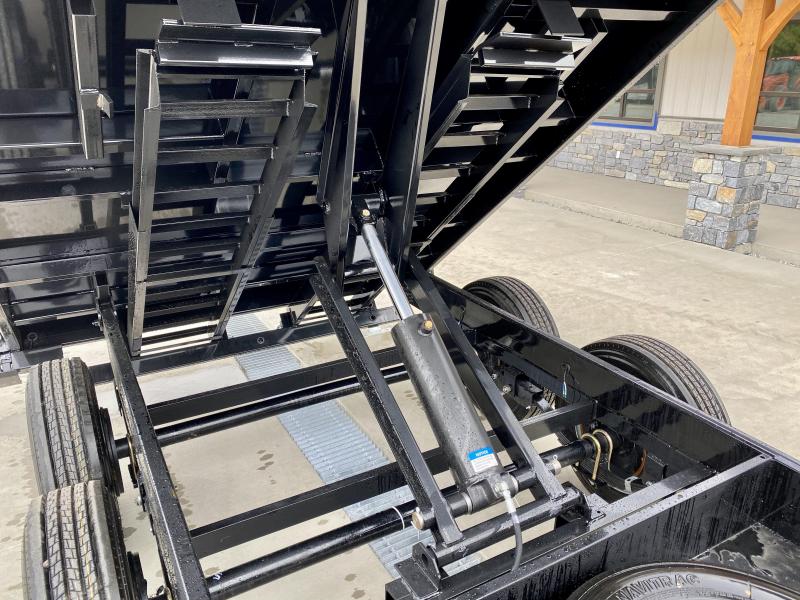

The hydraulic cylinder in the 16 footer is a 6x15. Heres a few more pics
Dealer says 16 footer has a few more reinforcements. You talking tube main/bed frame? Sure Trac claims it has a tube main frame.
Hoist looks like channel.
No, I was talking about the hoist frame. When the hoist is collapsed, the cylinder is pushing horizontal against the hinge pin that's attached to the channel scissors frame, huge power there until it starts up. It wants to push the pin right out the end of the channel and will over time if you use it commercial like I do. 10K miles on my new PJ and only 5 months old. This is mostly short hauls so a lot of dumps.
Yes, I noticed the tube main frame and even doubled in front of the front axle, that's a good frame, strong and light. It also appears that the axle u-bolts straddle the frame so that helps too. It gives more clearance. The u-bolts are what hit first on my Lamar I-beam frame, the flange is wide. Some day as the steel ages and gets brittle it will crack, then ya got a repair to do.
For a homeowner that only use their trailers once in a while it is mostly a non issue but for me it is serious. Spring suspended axles all make contact with the main frame at some point some more than others, especially off highway use.

Ah nice, I was looking at the tag trailers and must have missed that one. I like how they have the larger 3 3/8 brake azles also.
Without seeing the build quality, 13k isn't bad for them. The question i have is the deck width 96" between the side or overall width?
