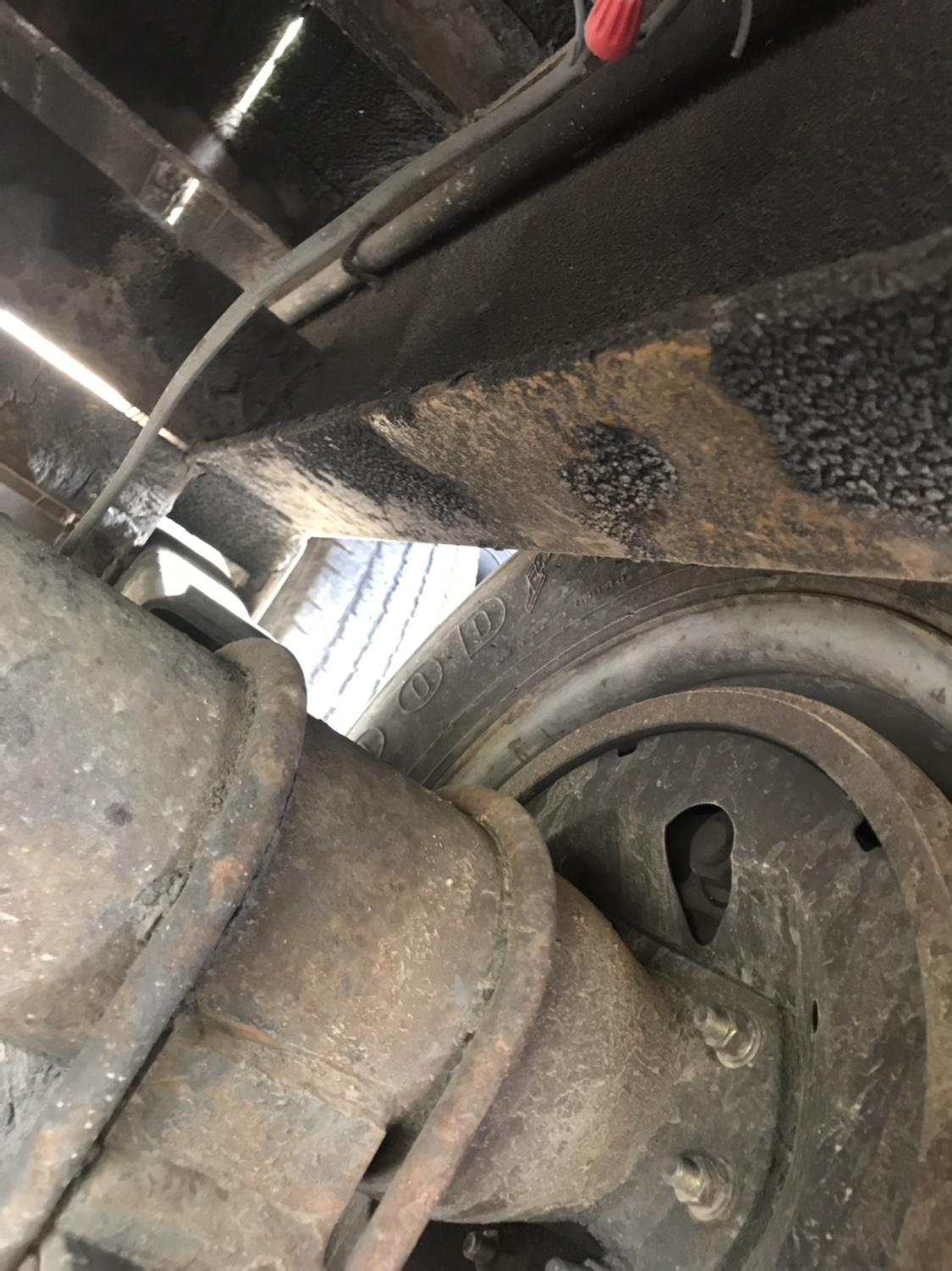

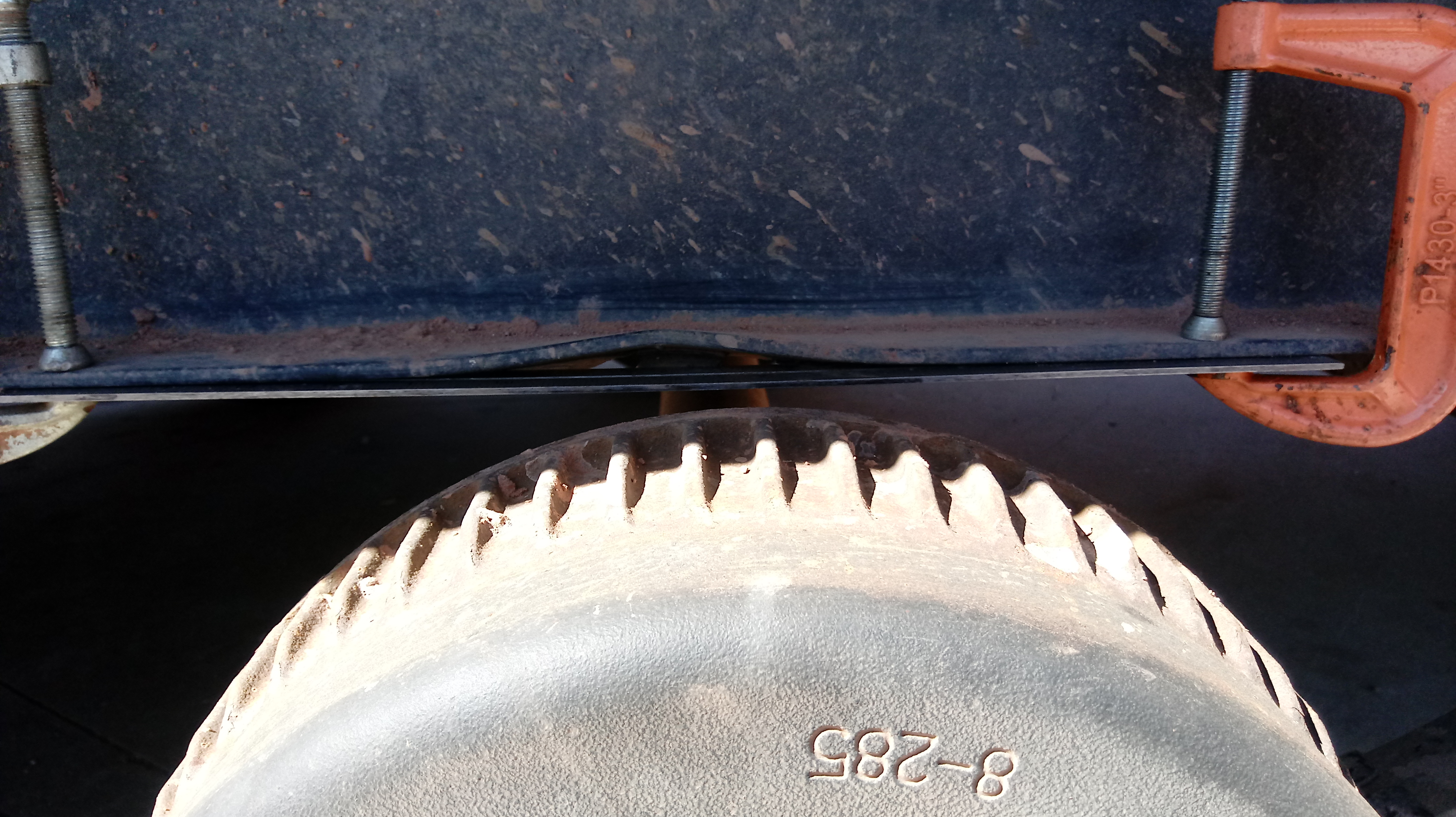

The picture I was talking about is this one of my Lamar spring trailer. Sorry, my bad, I posted it on another thread not this one. See what happens when ya get old:) But note the frame damage. And yes, I do like my torsion and yes you don't have to, Lol
I do understand not all spring trailers are the same, longer or shorter hangers, frame type, axle size, u-bolt size and spring arch all play a part. Maybe my Lamar is just a poor example. Thanks for the comments.
Here’s my spring trailer. There’s no evidence of the axes having ever hit the trailer and I cross ditches all the time. IMG_9111.JPG
