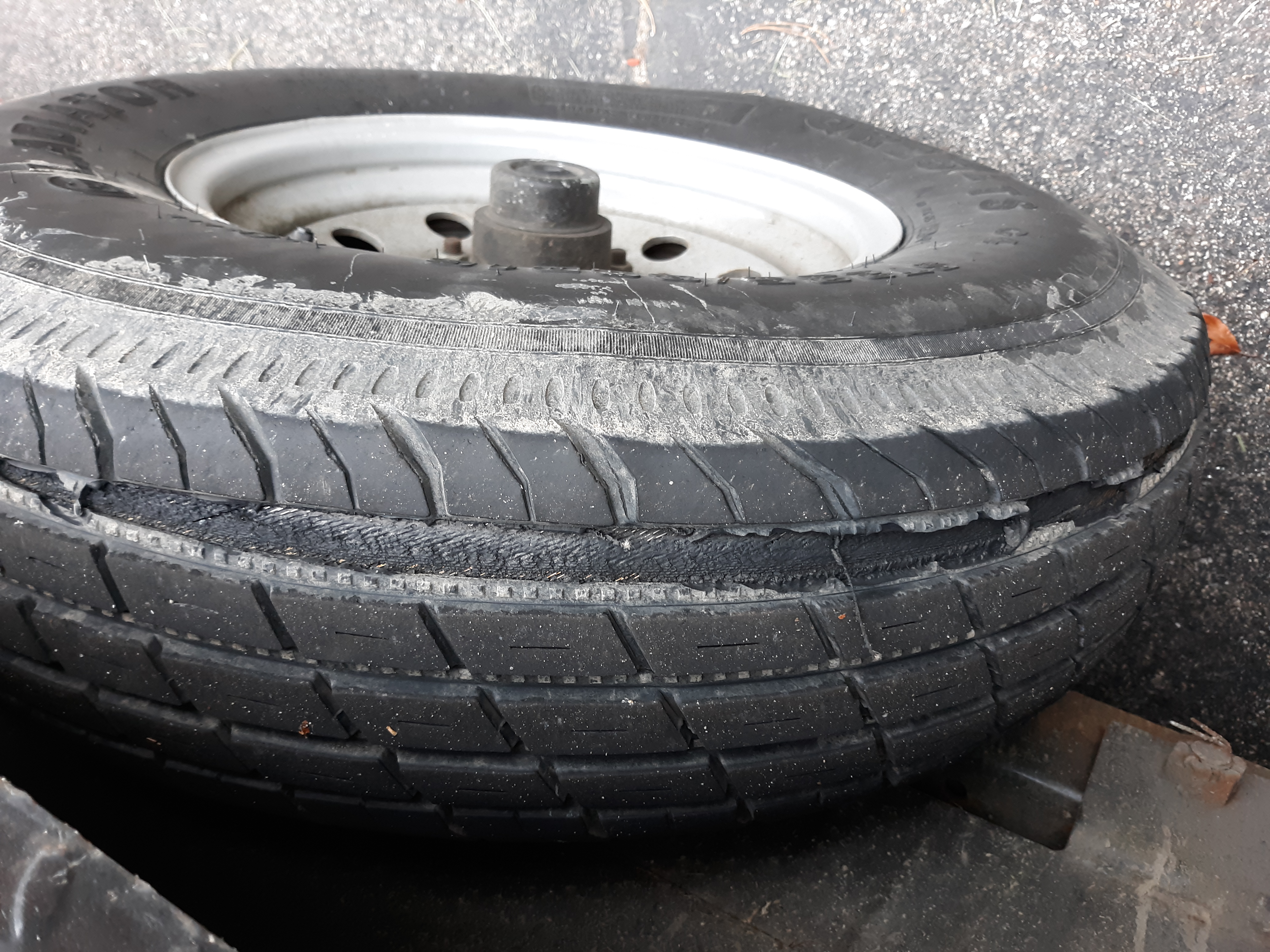

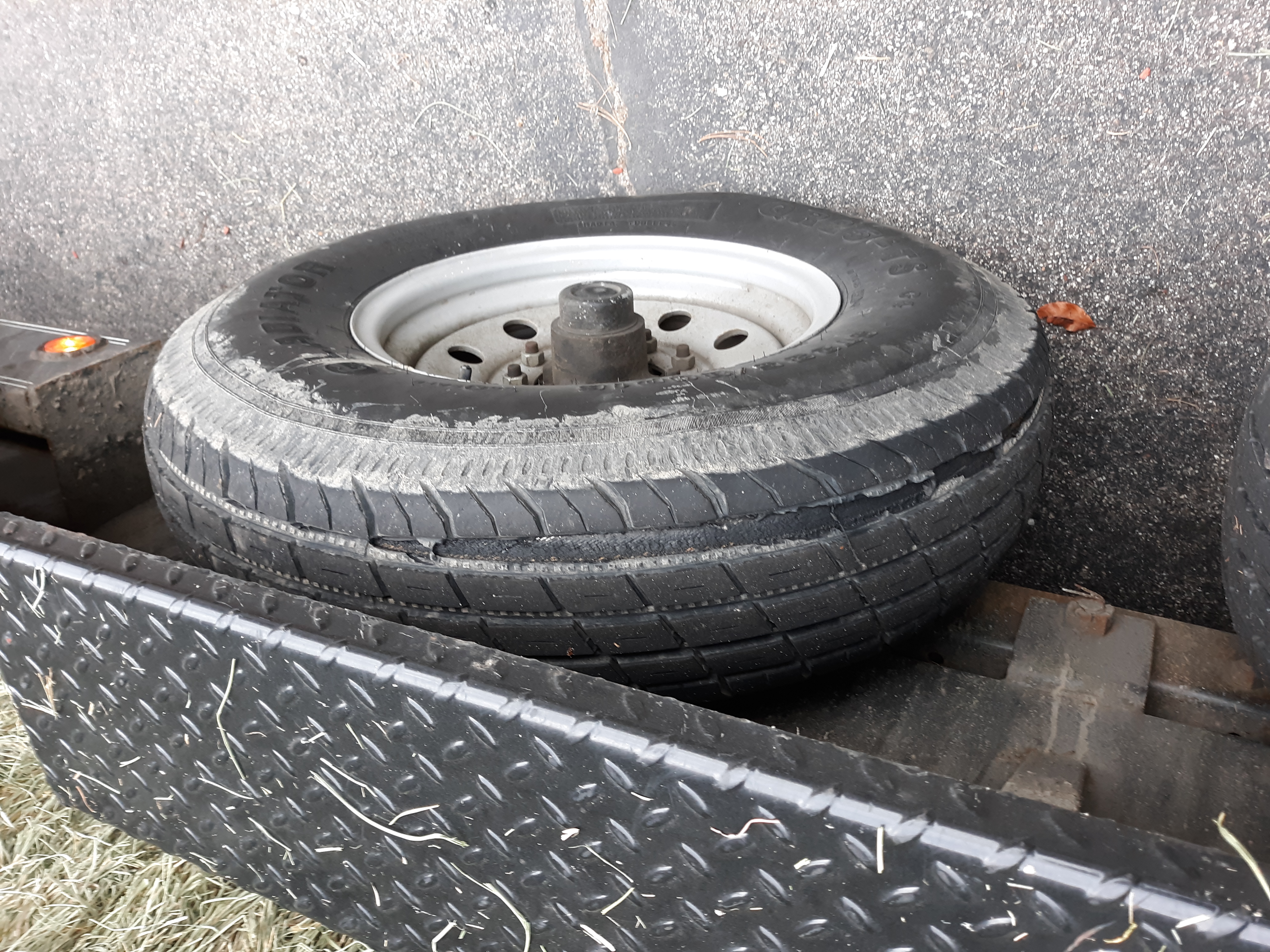

Lost a tire last weekend still holds air..... trailer flat.jpgtrailer flat2.jpg

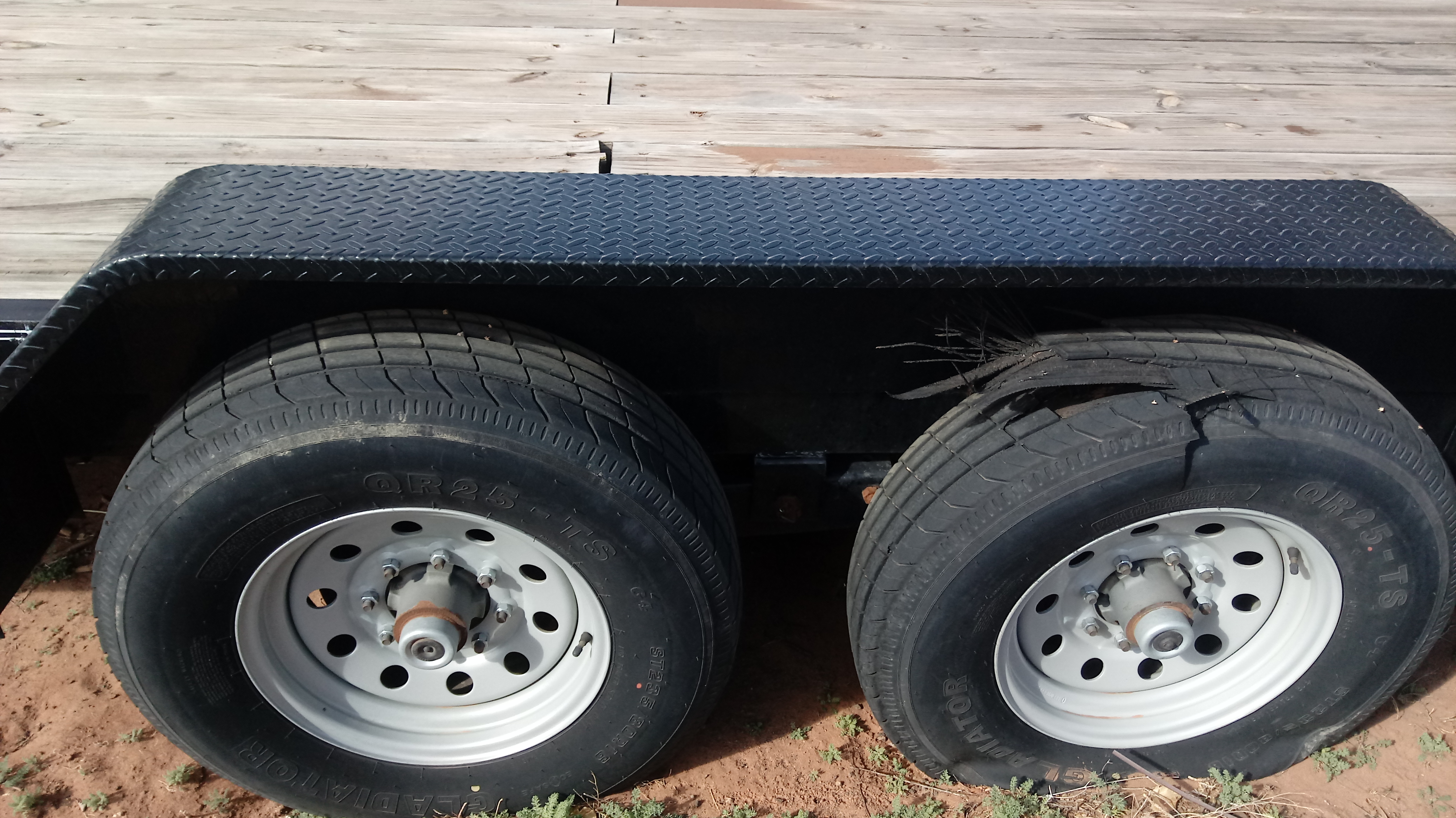

I could handle, but be annoyed with 4800lbs.
But 4000lbs is out of the question.
Might as well save $4,000 and buy a trailer with 8k axles.....which I may very well do.
I don’t think most of the people selling these trailers know what theyre doing. :rolleyes:
My guess is it is a typo or the salesman don't have a clue. The upgrade 14 ply 4k tire is for 7k axles v/s the standard offering of 10 ply @ 3520lbs.
   / Building an 8遅16 gooseneck dump trailer
#174
Yup. They actually speced the standard tire at about 3600lbs. Their “ upgrade tire “ was 4000lbs :ashamed:
Im thinking, a single 3600lb tire on a 10k axle????? Really????
Thats the tire rating on my small trailer! :ashamed::thumbdown:

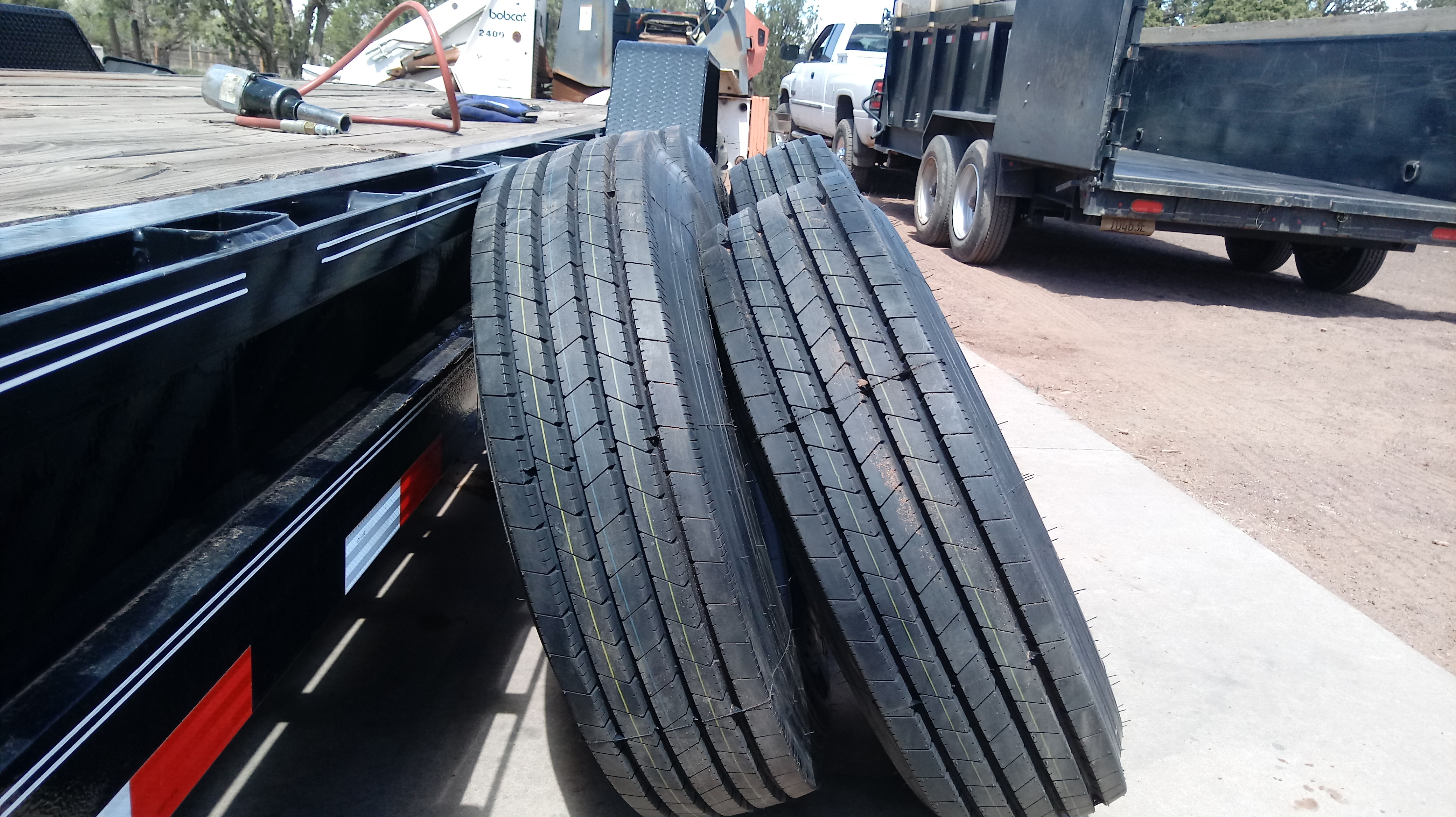

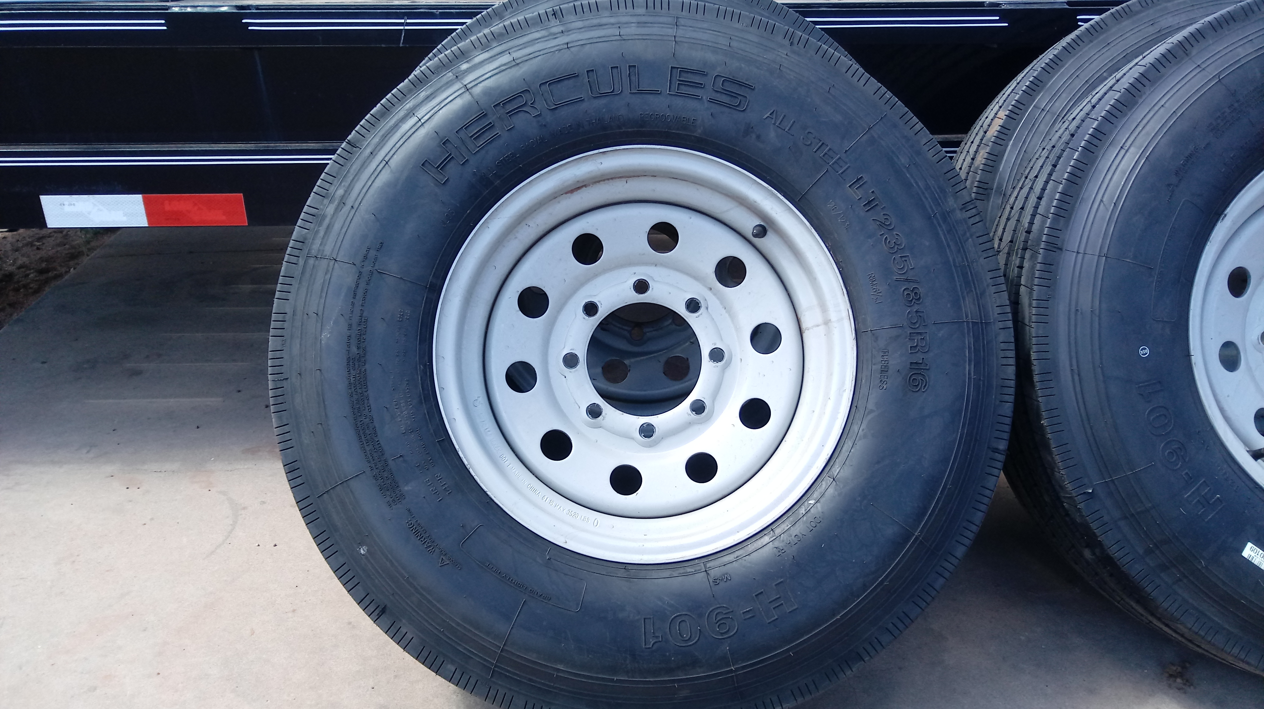

Now I will start looking for new tires, Maybe 17.5 size USA made and new rims.....
   / Building an 8遅16 gooseneck dump trailer #176
You will like 'em. Kinda spendy from scratch tho. Here are some high grade ones:
Rickson Wheel Manufacturing
If you don't mind Chi-com, these are an okay tire/wheel and reasonable, free freight. They are oem on my Lamar and PJ in the 17.5. Kinda goofy link but it is good.
Attention Required! | Cloudflare
When mine went south, oem 235/80x16, 10 ply, I went to these 235/85x16, 14 ply. I don't use the trailer much but so far so good, about 2 years old now.
   / Building an 8遅16 gooseneck dump trailer #177
What would a 17.5 rated for 5k or more and a rim for a 8 lug 10k axle cost? My 10 ton trailer has 5 pretty good tires and needs 3 but I could run the 5 good ones on my 14k trailer if the price was right. Edit I just saw the link above. I’d probably pay $250 a tire but for $400 a tire plus needing a wheel I believe my trailer is going to stay dual/tandem. If I was running a bunch of miles I’d give it more thought but I’m not.
