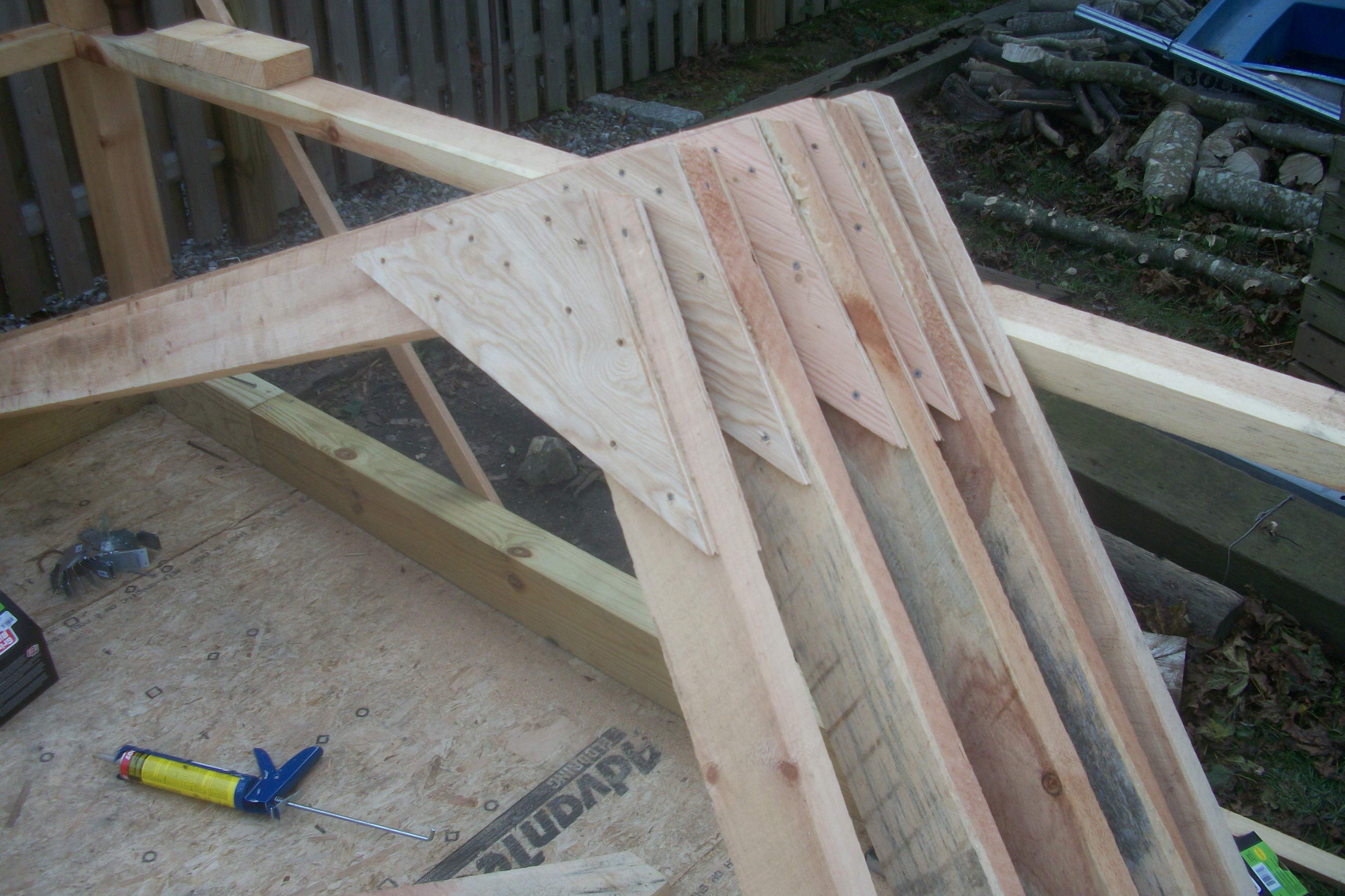

The floor should hold everything together IMO and the collar ties will strengthen the roof. If you don't think the collar ties are enough you can always cut plywood into triangles and nail them from the collar ties up to the peak. Looks great!
10-4 on the plywood-see attached pix. this is on a little 10 x 12 post and beam shed and the rafters are only full dimension 2 x 4's-and no ridge. the plywood is 5/8ths, glued and screwed.

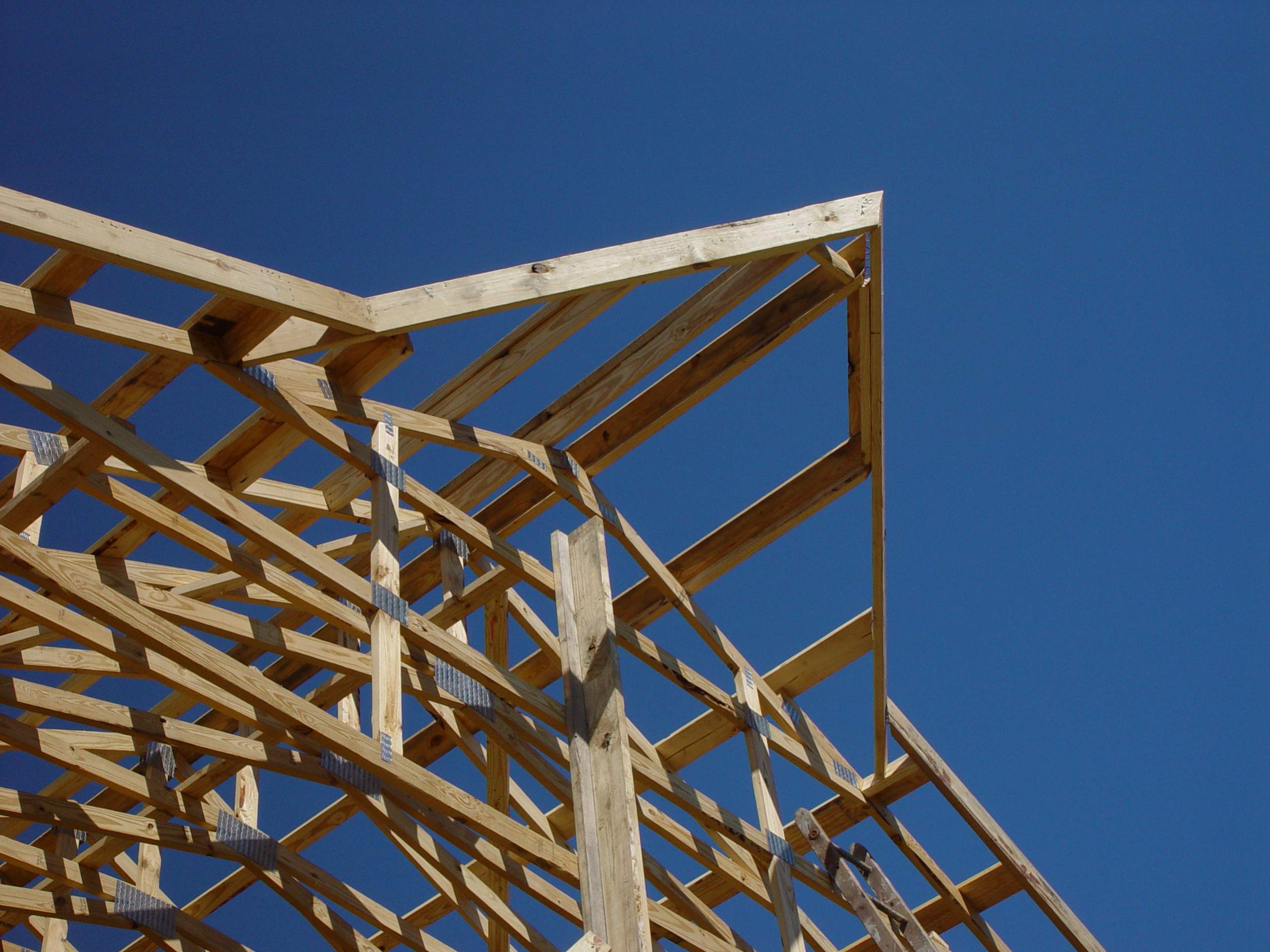

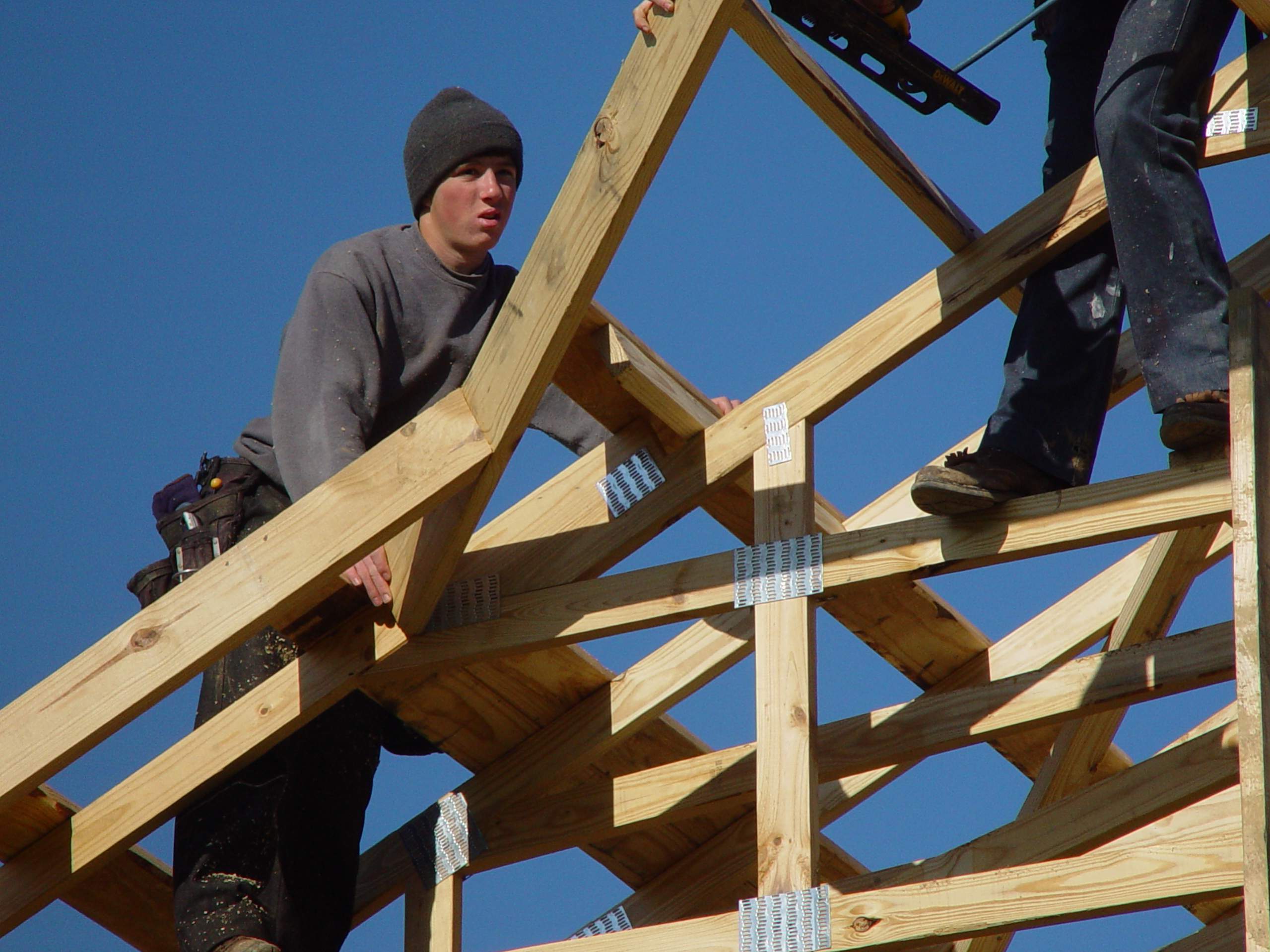

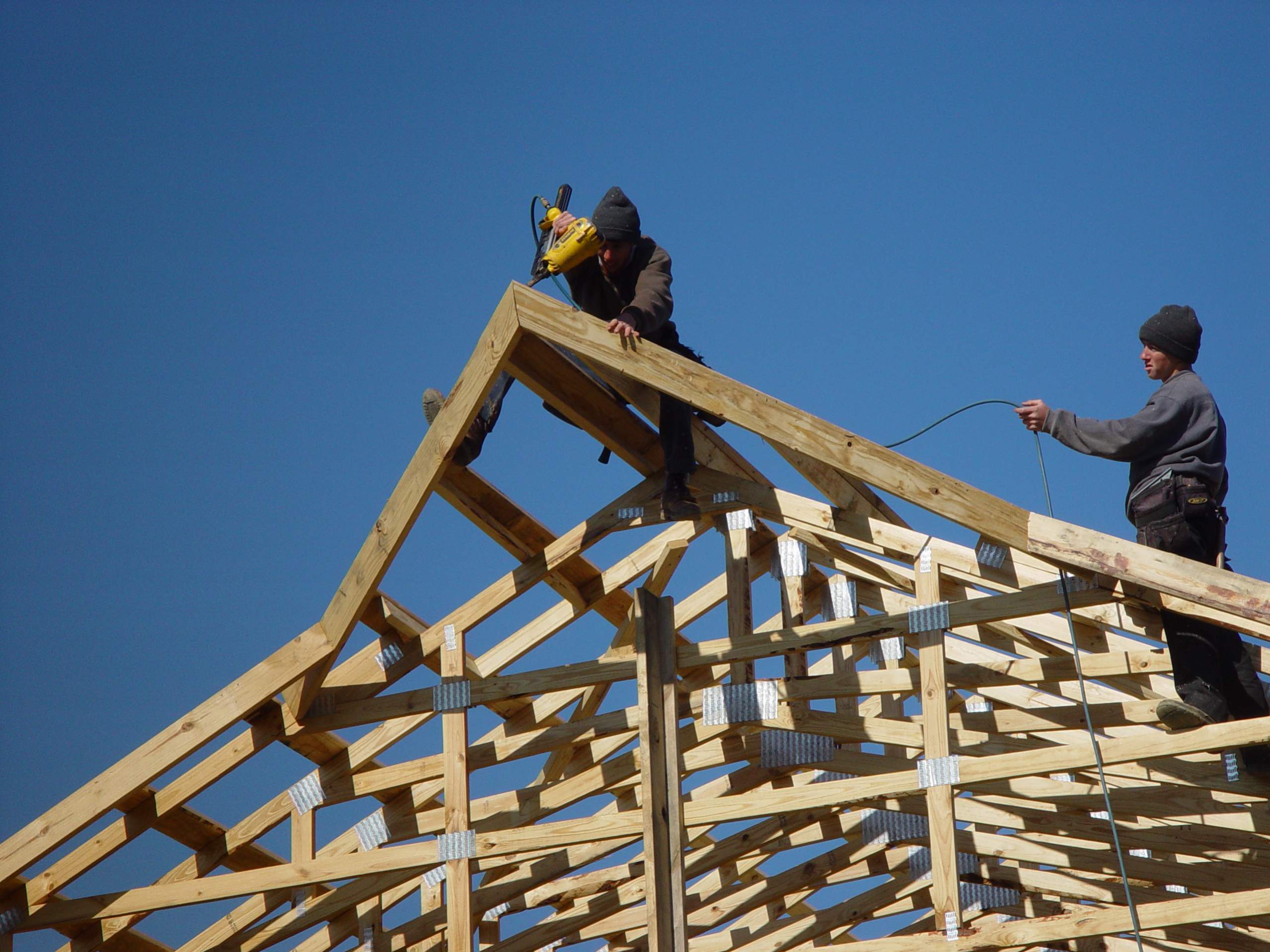

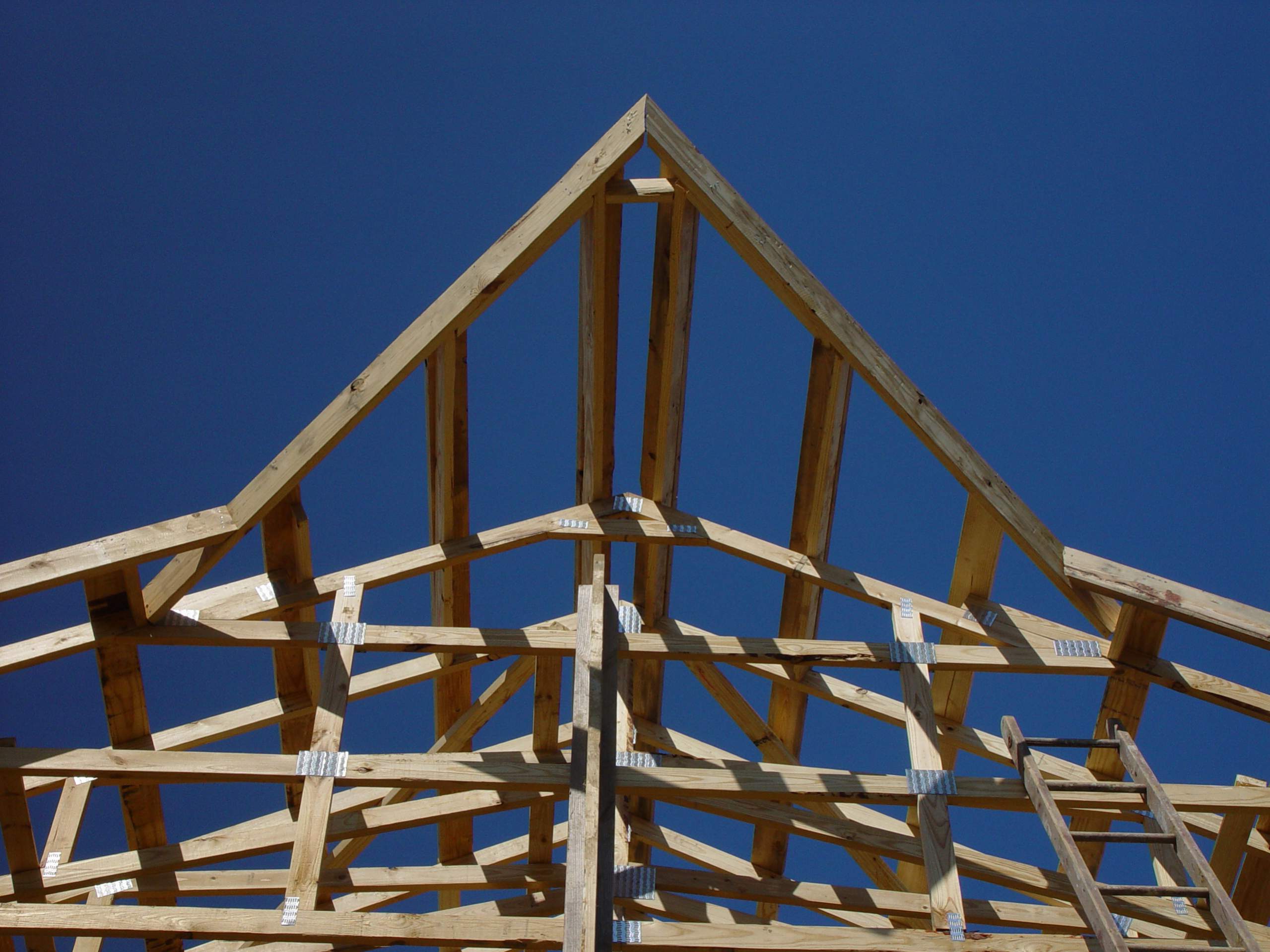

Maybe something like this? I'm open to all suggestions. I've never seen this part done before.
I didn't know the actual name, always called it a birds beak. Had the truss co build it in upon ordering. Allowed a 2x4 to be placed on edge to overhang and create the detail. might have a few more pictures if needed.

Thank you. That was very helpful to see how they framed it. I can see how one would have to use vertically oriented 2x4's if there is no ridge beam to carry the load. Since I'm using plywood gussets, I could just use larger pieces of plywood and notch 2x4's vertically into the 2x8 rafters like on your pictures. The tops of the 2x4's need to be flush w/ the tops of the rafters because of the plywood decking, unless of course I use skip-sheathing. Maybe since I've planned it with a ridge-beam cut into the last 2 "trusses" I could stay with just notching the 2x4's horizontally as on my Sketchup drawing?

Just when you thought this thread was dead because I hadn't updated in over 2 weeks, here are some new pics so you can see the progress. Everything is slow when I have to work on weekends and evenings.
There are metal T-plates and L-plates behind the plywood gussets for strength in the inside where the pushing-out lateral forces from the rafters and trusses will be:
Notice how all the 6x12 glulam beams are now in place. Not all the gussets are nailed up yet. Also, installed the header for the 16' wide front door (10' head height). You can see the 1x12" pine siding stickered on the right.
First truss built. You can't see it well because it was dark 2 nights ago when I finished, but there are pockets for the rafters to sit in, which act as a template. 18 more to build -- probably some tomorrow if possible. I have to work today and all next weekend. :(
