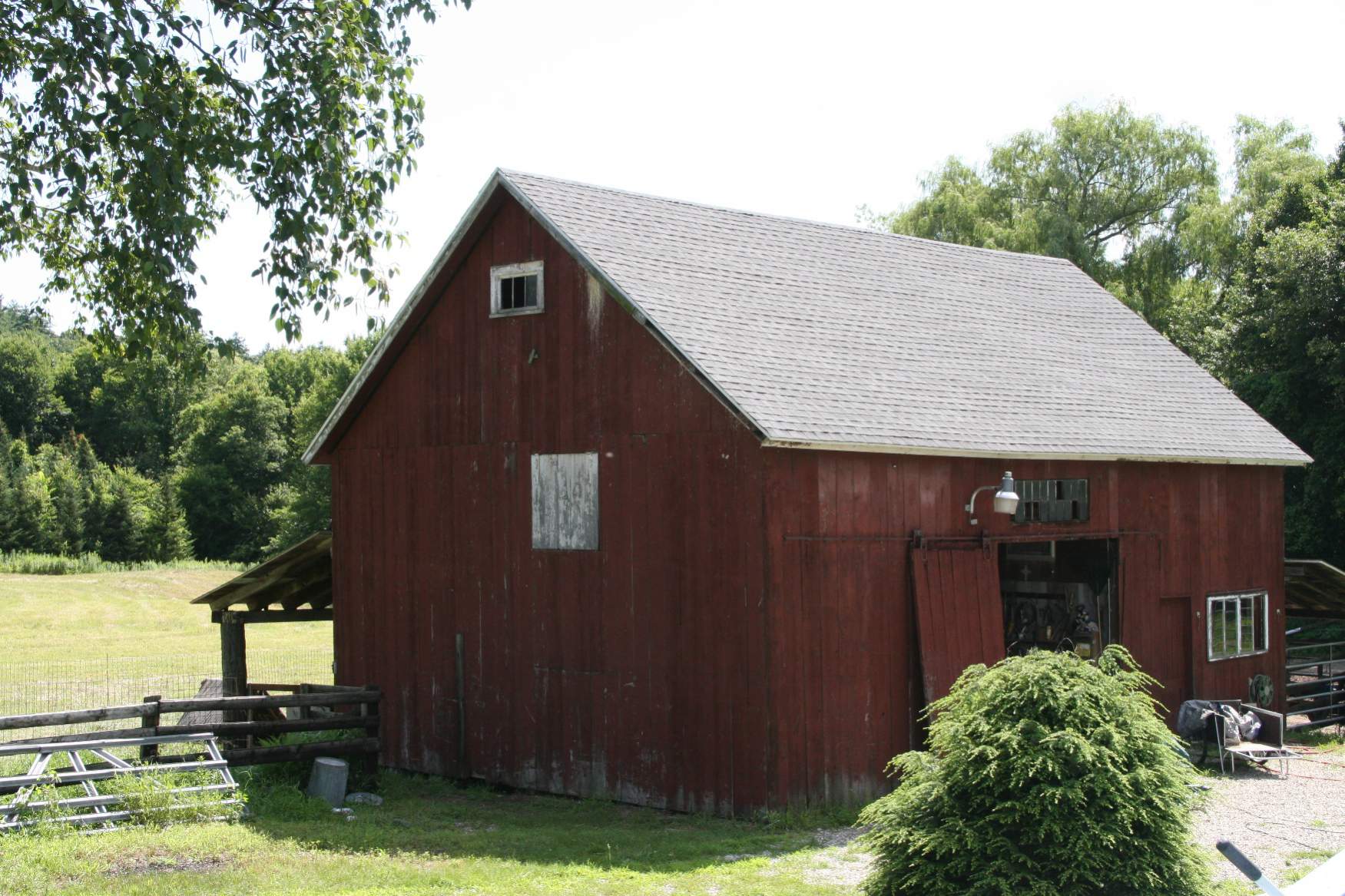

Gorgeous! All of it--the setting, the home, the project: wow! This thread will never be 'dead' because there will always be folks like me discovering it anew. Early on you mentioned planning a hay trolley system. I recommend that you look at the book Haying With Horses by Lynn Miller. It is, despite the title, about all aspects of producing, storing, and handling hay. It's a treasure-trove of info (photos, diagrams, descriptions) re different systems for moving hay, getting it into the barn, and handling it once it's in the barn, including detailed pictures of hanging track-and-trolley systems. We inherited some of that same antique hay-moving hardware with our place, long since removed when they had to shore up the barn roof, however. We are trying out harvesting our own hay this year, even though we don't have enough barn space to store it all. Lynn Miller is out your way in Oregon, as you may know; he's the editor of Small Farmer's Journal which also has articles about haying from time to time. The CT River Valley is full of old tobacco barns, most still in use tho' not necessarily to dry tobacco. My town still produces tobacco & we have several of them right on our road. I get to watch the whole tobacco producing process & it's mighty interesting. Our barn is a small version of the classic tobacco barn. Since our kitchen floor (built 1870s) is made of the exact same planking as the barn, I often wonder whether house & barn were made from a dismantled tobacco barn. Congratulations on your barn! You must be so proud!
Jocelyn the Farm Lady
P.S. It has been painted since this was taken!!
