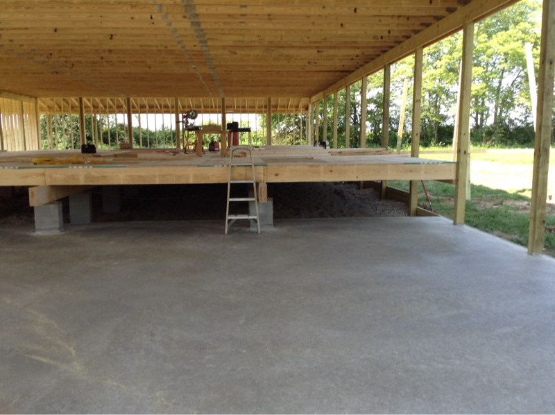

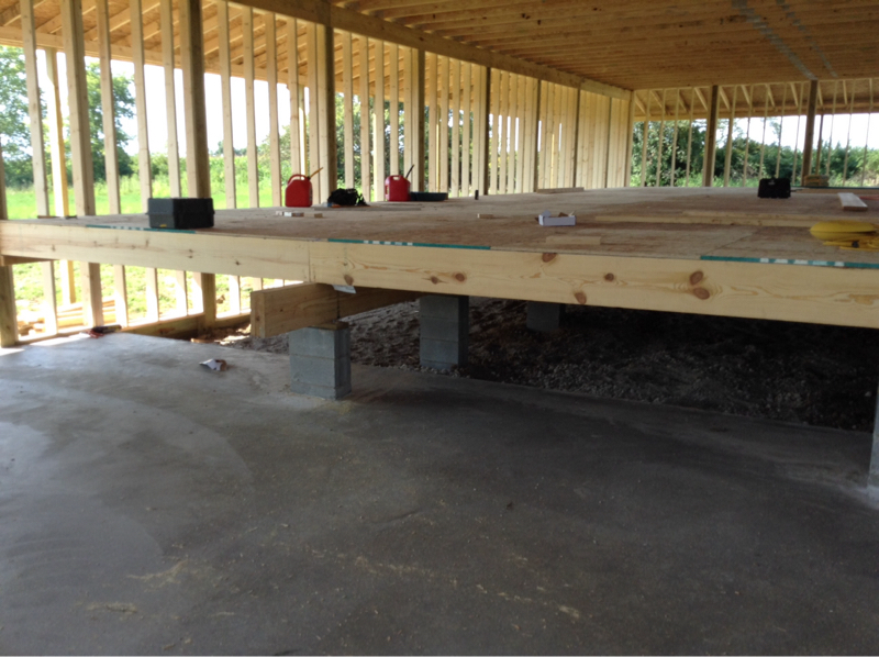

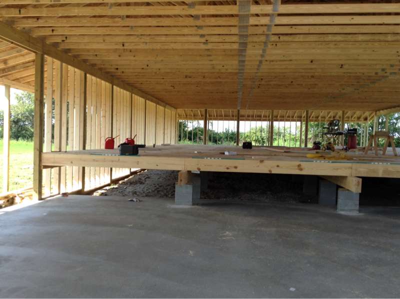

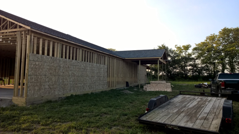

I dug down about 18-24 inches in between the posts about 12 inches wide and filled the area with crushed concrete that compacts and basically turns to an almost concrete state. Tamped that down and then attached ground contact treated 2 by boards about 6 to 8 inches below grade. Then added 2x8s or 2x10s to get at least 12 inches above grade. Dirt will be placed to within 2 inches of the top of the treated boards and sloped away from the house approximately 8 feet out all the way around the house. The crawl space is at the same height as the existing grade. The ground in this area has great drainage and the stone placed around the perimeter will insure if any moisture gets to the perimeter it will drain to the stone and not stand. The crawl space has pea gravel covering the entire area and I will be covering the entire crawl with a heavy white plastic that will come up on the crawl space walls, come up on the pier blocks and all seams and connection points will be taped.
The side walls of the crawl space are 2 x 6 studding that will be OSB on the exterior and covered with vinyl siding down to the treated boards. The interior of the crawl space walls will be spray foamed and I may cover them with OSB or plywood, not sure if necessary yet. The plan is for this to be a closed/conditioned crawl space since it is at grade and not the normal below grade crawl.
I have used PL400 caulk between the stacked 2 x treated boards, but I think I am still going to try and find a waterproofing material to apply to the boards just to help insure at grade level water will not enter between the boards. May not be necessary, will see how it goes. Not really concerned at this point about water in the crawl space, but will be monitoring during the construction phase when the heavy fall rains start, if a problem arises will address then. Bottom line at this point this type of foundation wall is much cheaper than block or concrete.
I spent a great deal of time researching this type of crawl space/permanent wall foundation system. It was first done in the early 60's in MN and they started out not only doing crawl space foundations, but also basements. Those test homes are still in existence and they are outperforming concrete over the long haul.
Definitely not for everybody, but building this post frame/pole barn house is a very cool way to go. Saving a ton of money, no load bearing walls so the wide open space allows for a lot of flexibility.
My biggest concern for the foundation is not keeping water out, it is keeping critters out such as seen in a pole barn. I am hoping the stone based will help deter them from digging. I have other ideas that can be used later if this does not keep them out. And there is plenty of room to work in the crawl if it has to be addressed again later.

Do you have any pictures of this "I dug down about 18-24 inches in between the posts about 12 inches wide and filled the area with crushed concrete that compacts and basically turns to an almost concrete state. Tamped that down and then attached ground contact treated 2 by boards about 6 to 8 inches below grade. Then added 2x8s or 2x10s to get at least 12 inches above grade. Dirt will be placed to within 2 inches of the top of the treated boards and sloped away from the house approximately 8 feet out all the way around the house. The crawl space is at the same height as the existing grade". Just trying to picture it. With that much roof real estate , solar hot water and some backup power would work out well. Now is the time to think about some in floor heating in the bathrooms as well.

Bones1 - I will see if I can a close up of the area between the posts. Finished up getting all the exterior studding completed. This week planning to start putting up OSB, installing two skylights, finishing up the rafters on the sunroom and shingles on Thursday.

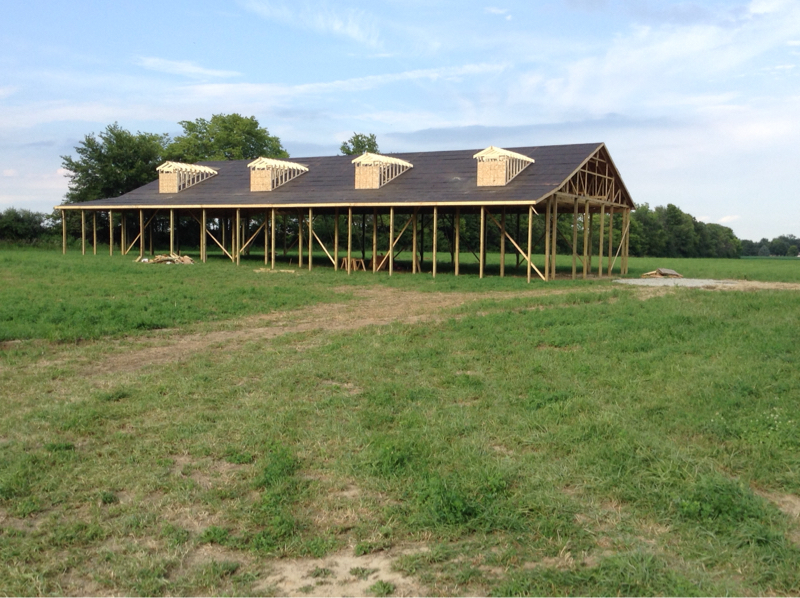

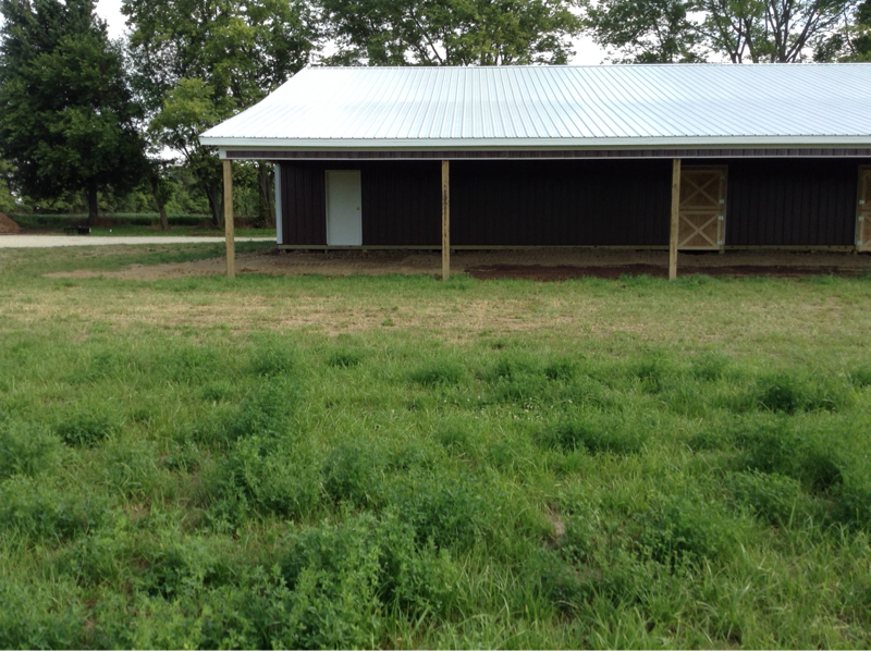

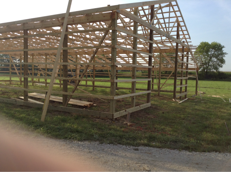

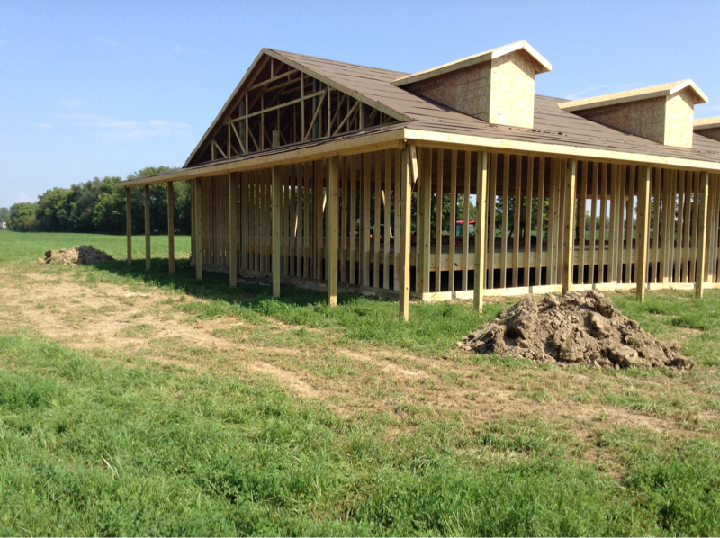

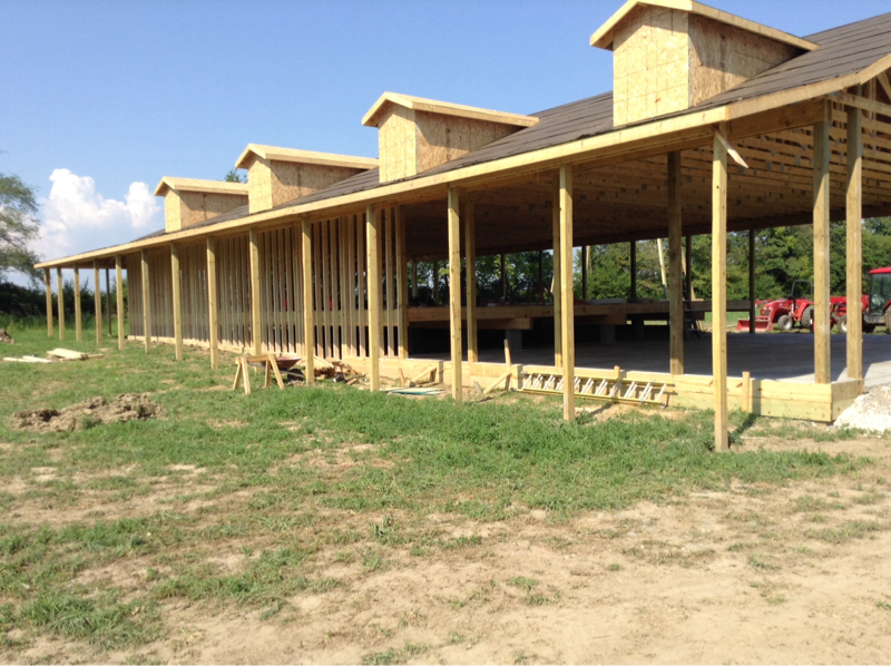

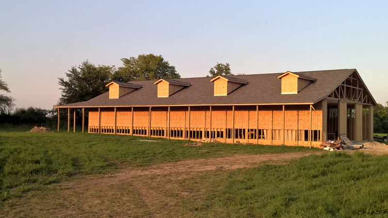

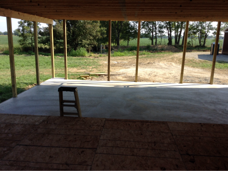

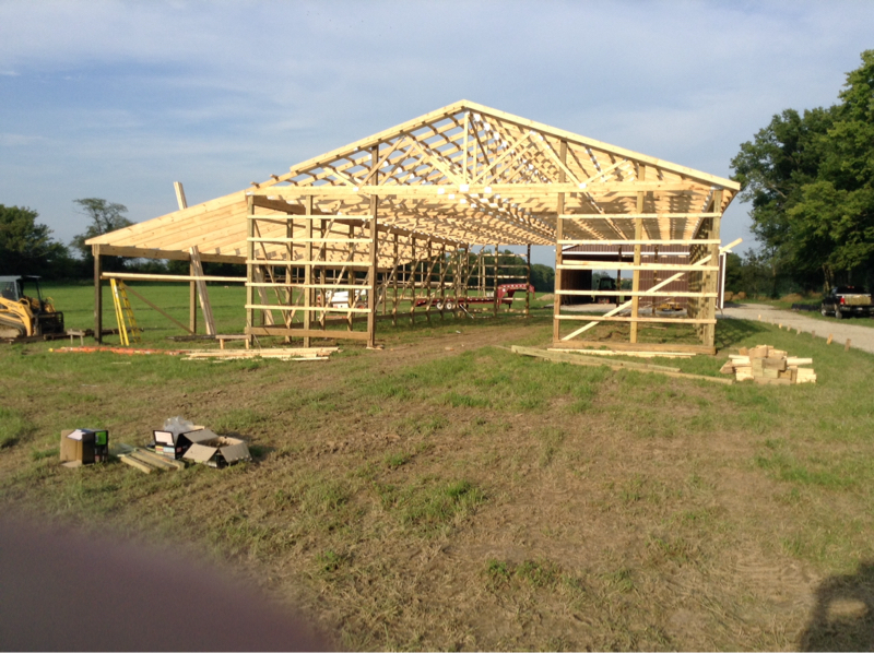

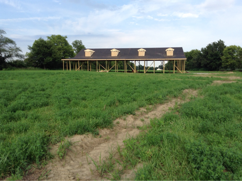

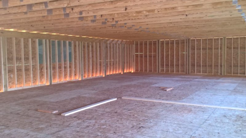

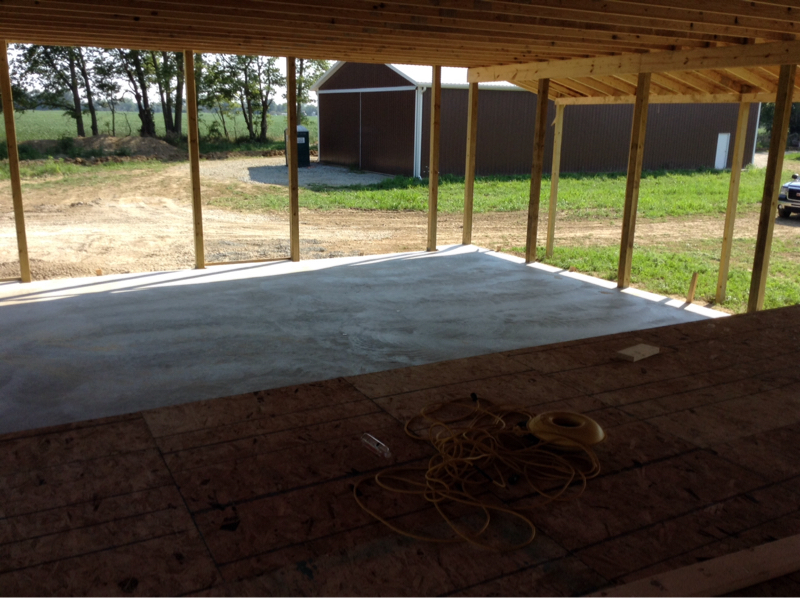

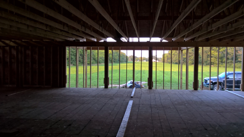

Roof was shingled today, 75 squares and two skylights. We started working to get the OSB on to close up the house. Got the wife inside to begin trying to layout the interior. We have a drawing I did using a design she found in a house plans book. I took what she liked and just made almost of the rooms bigger. It is unique having this open canvas to start out, hope to start putting up walls soon.
A few pics of recent progress are below.
Busy couple weeks coming up to try and get it closed up, so interior work can get moving.
   / Building the Retirement Place #87
YIKES 9K for the roof !!!! I can see that I will have to go another route. BTW I LOVE PICS 3 &4 !!!!
   / Building the Retirement Place #88
You look like you will be in good shape for winter... nicely done!

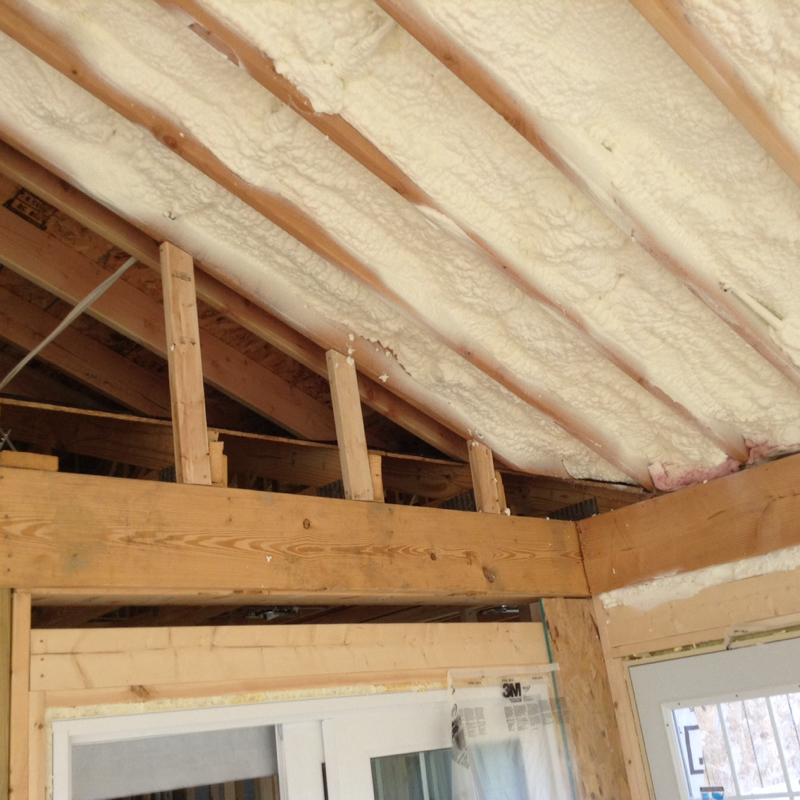

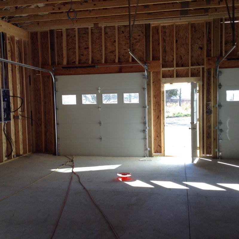

Have been so busy, have not had time to post on progress. Our timeline is shrinking quickly, but things are picking now. We are spray foaming the house this week and will be doing drywall as well. While that is going on we started putting up fence yesterday and hope to finish by end of week. Also have to start the chicken house while we are staying out of house.
We should be starting finish work on house next week. I have a buddy who has been helping me everyday, not sure how we continue o keep going some days. Lots of alcohol is in the future for us to celebrate.
Just trying to get all of the stuff in the walls before drywall, network, tv, phone, speakers, security, etc. the days are long and the company that bought our current residence is starting to do work along the property lines and making it tough to keep the horses calm, we need to get them moved soon.

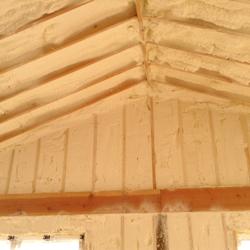

Here are a few pics taken today, will post more once drywall is done. Working to try and get far enough along by end of November that county will issue a occupancy approval.
   / Building the Retirement Place #94
That foam is just beautiful!!! Did you go closed or open cell?
#95
Open cell in ceiling and walls, closed cell in the sunroom floor. Will be blowing in R49 (18 ") in open attic area.
   / Building the Retirement Place #96
How bid was the cost difference between open and closed cell? I know the closed cell is a lot more money, but you get a much higher R value with a lot less of it then closed cell. Plus there is the added advantage of close cell not holding moisture like open cell does.
