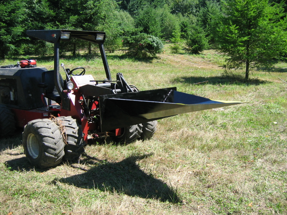

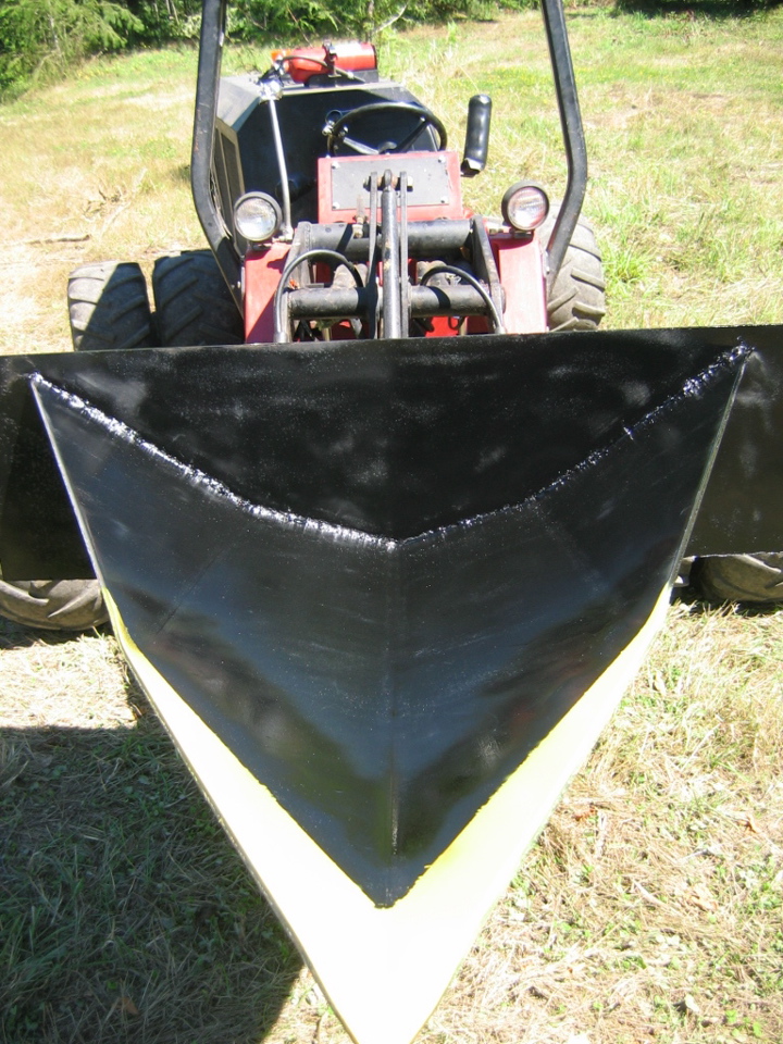

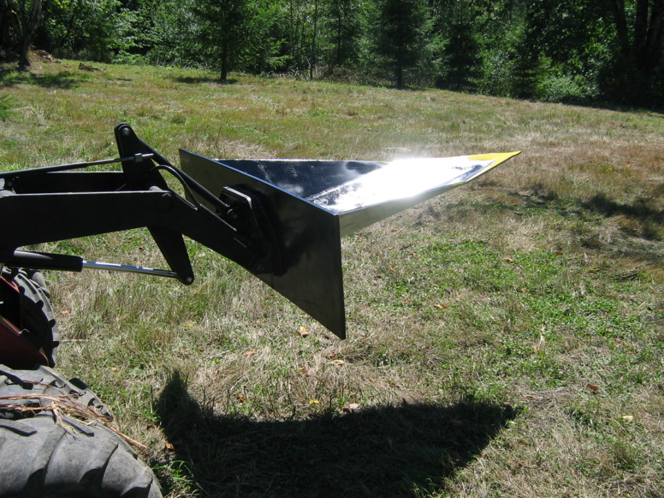

In the never ending list of toys I want, could not find one local cheap...
3/8" steel, Back plate is 1/2" Measure 56X56 flat.
$375 for steel and bending
$65 for quick attach (tractor specific)
$12 for paint
$20 for welding rod
$15 for grinding wheels (so far)
About a day of agravation as this was also my first welding project since high school (a while ago).
Now to see if it will hold up.

I don't know if it will hold up or not... but I sure wouldn't want to be standing in front of you and your machine when you come calling! :eek: Them's the kind of things that nightmares and horror films are made of!!! :D
Just picked up my very similar "stump bucket" today:
$339.00 plus $125.00 shipping. No welding on my part 'cause I'm old & lazy and still don't know how to do a very good job. :eek:

I know this thing looks mean, but it is the same dimensions as the plans here on TBN. I just added the front point...
So far not so good. My land is DRY right now. Like a frickin rock. I can get small trees, but the idea was to get bigger trees. May have to wait until Fall....
I almost bought the one for 339, but I needed to try and get up larger trees.... Still ike that one, though...

I know this thing looks mean, but it is the same dimensions as the plans here on TBN. I just added the front point... So far not so good. My land is DRY right now. Like a frickin rock. I can get small trees, but the idea was to get bigger trees. May have to wait until Fall.... I almost bought the one for 339, but I needed to try and get up larger trees.... Still ike that one, though...
It's not just mean. That thing is downright sinister. Perfect for scaring the neighborhood kids away. :eek:
I had nightmares last night just thinking about it. :eek:

Power-Trac 1850 60 hp All Hydraulic articulated tractor. Rated at 45 degree slopes sideways (thats why I bought it). Upside is amazingly manueverable, all implements in front where you can see them, simple and sturdy as a tank.
Downside is it isl like and Abrams tank, it has a tendency to overheat, has no dealer support outside of the manufacturer, and is all hydraulic so it can leak a bit. Variious flavors of small to large. I am beyond happy with the purchase, although I curse it every day.

Yeah... Thought of that... Problem is we have a water issue on the property (a very old and shallow well for the moment) so I have no excess water for this project at this point.
