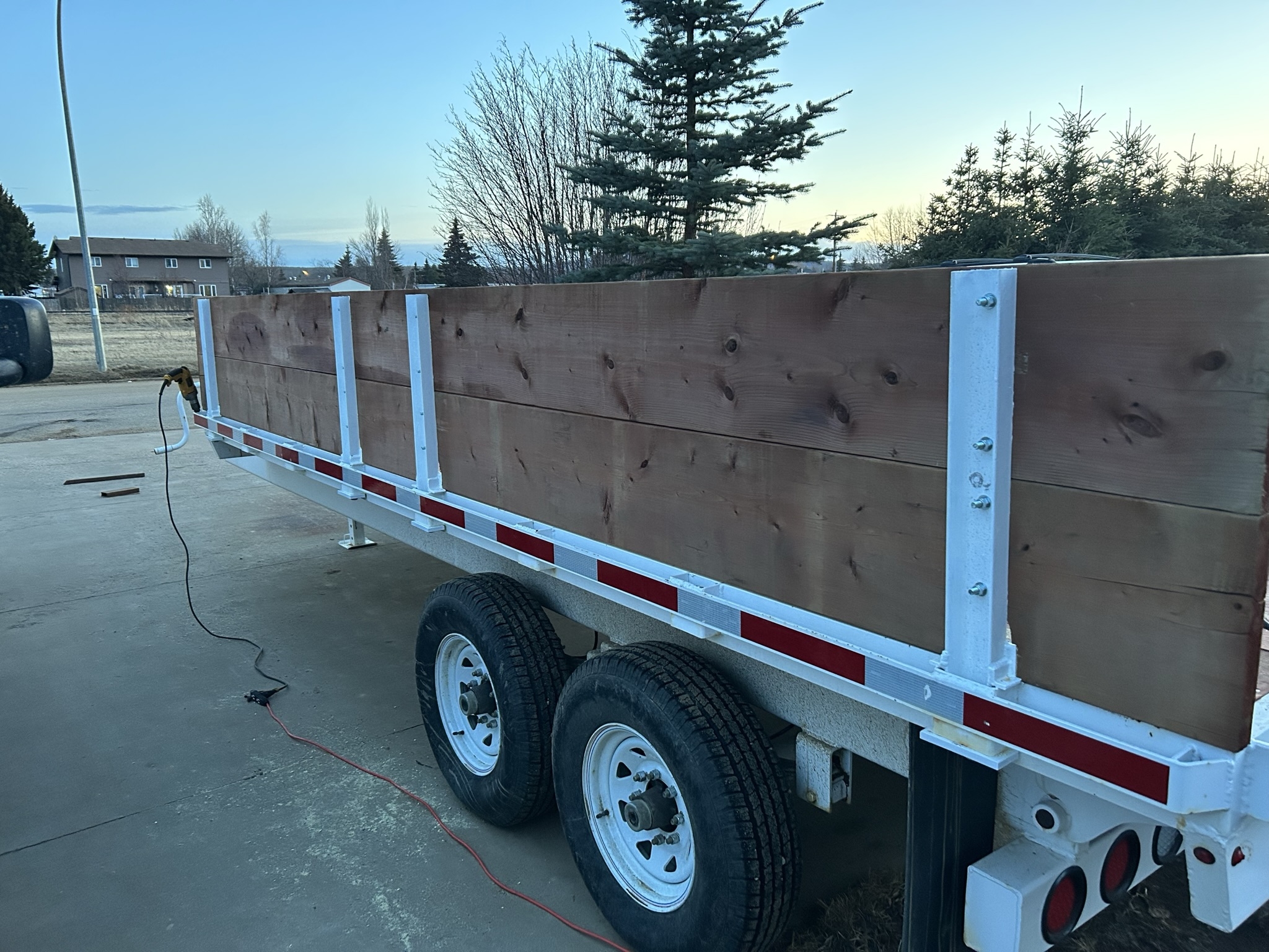

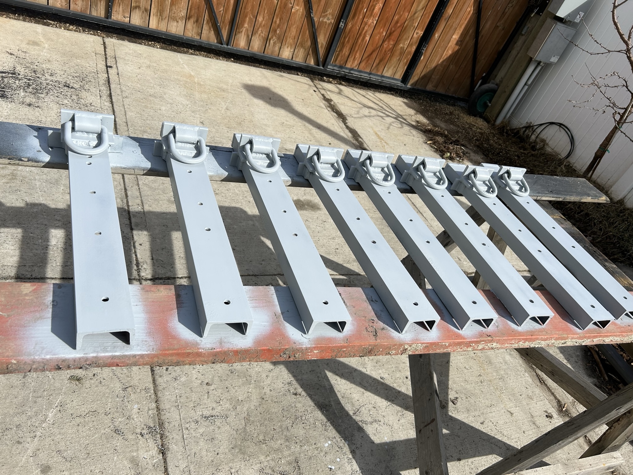

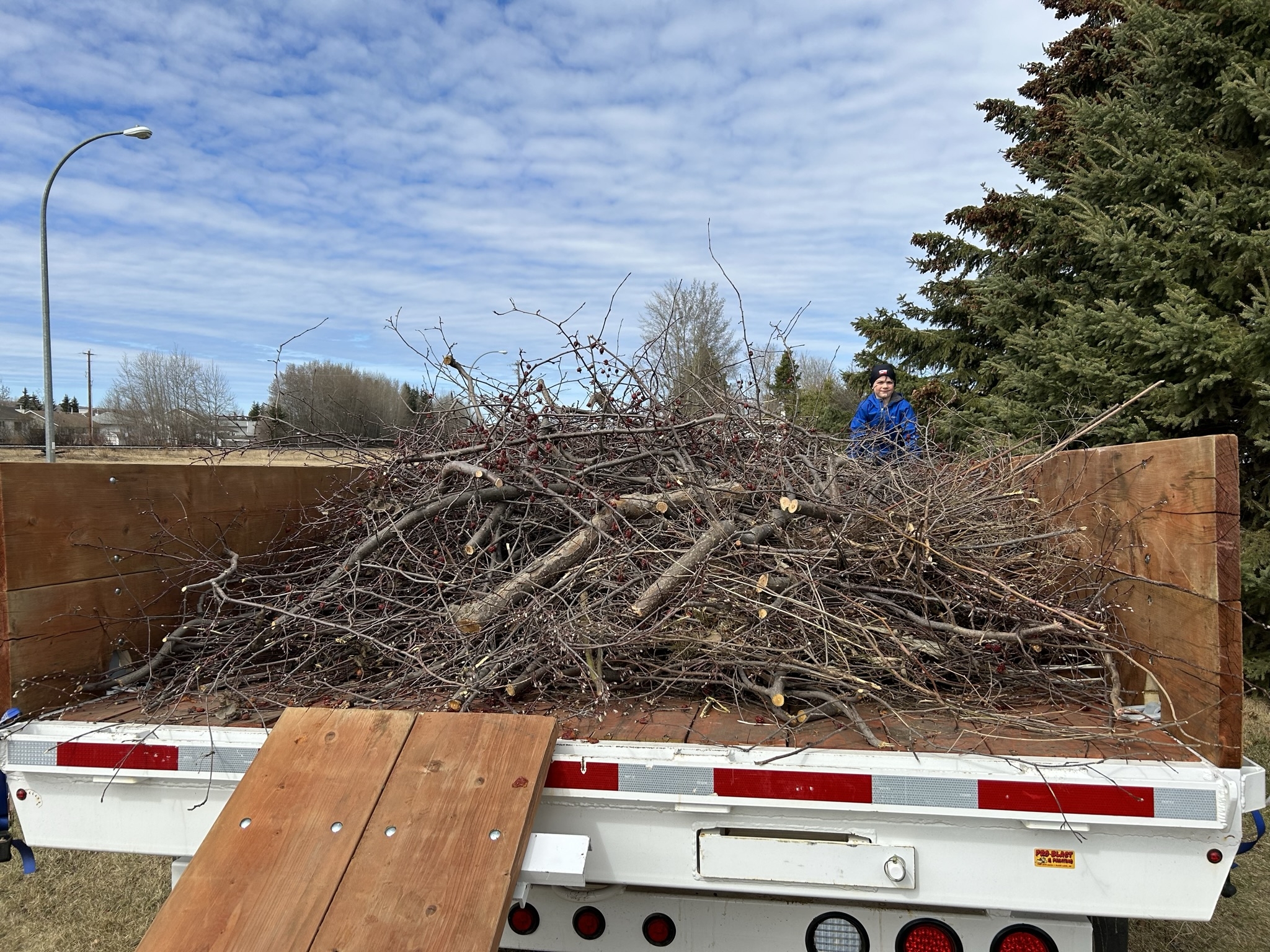

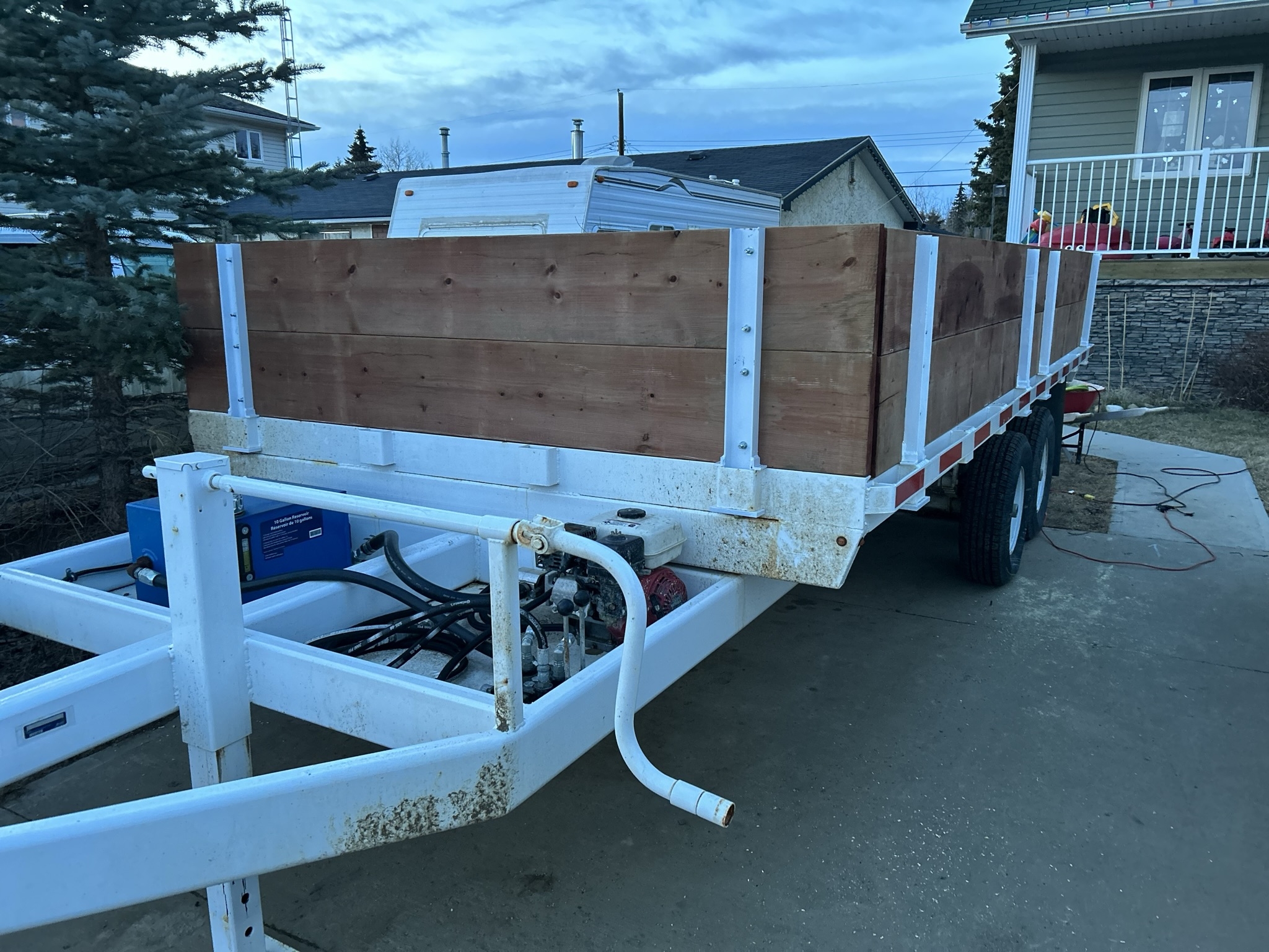

Finally got around to building some removeable sides for the flimsy trailer and hauled 5 yards of black dirt with it, it hauled it and dumped it with no issues. Also hauled a few loads of crap dirt and sticks with it, and keep finding more things for it to do. So far it’s working out very well. I’m going to try to put a video together of it and post it on youtube one of these days… I built tiedown rings into the uprights of the sides so I can still haul my bobcat with the sides installed.

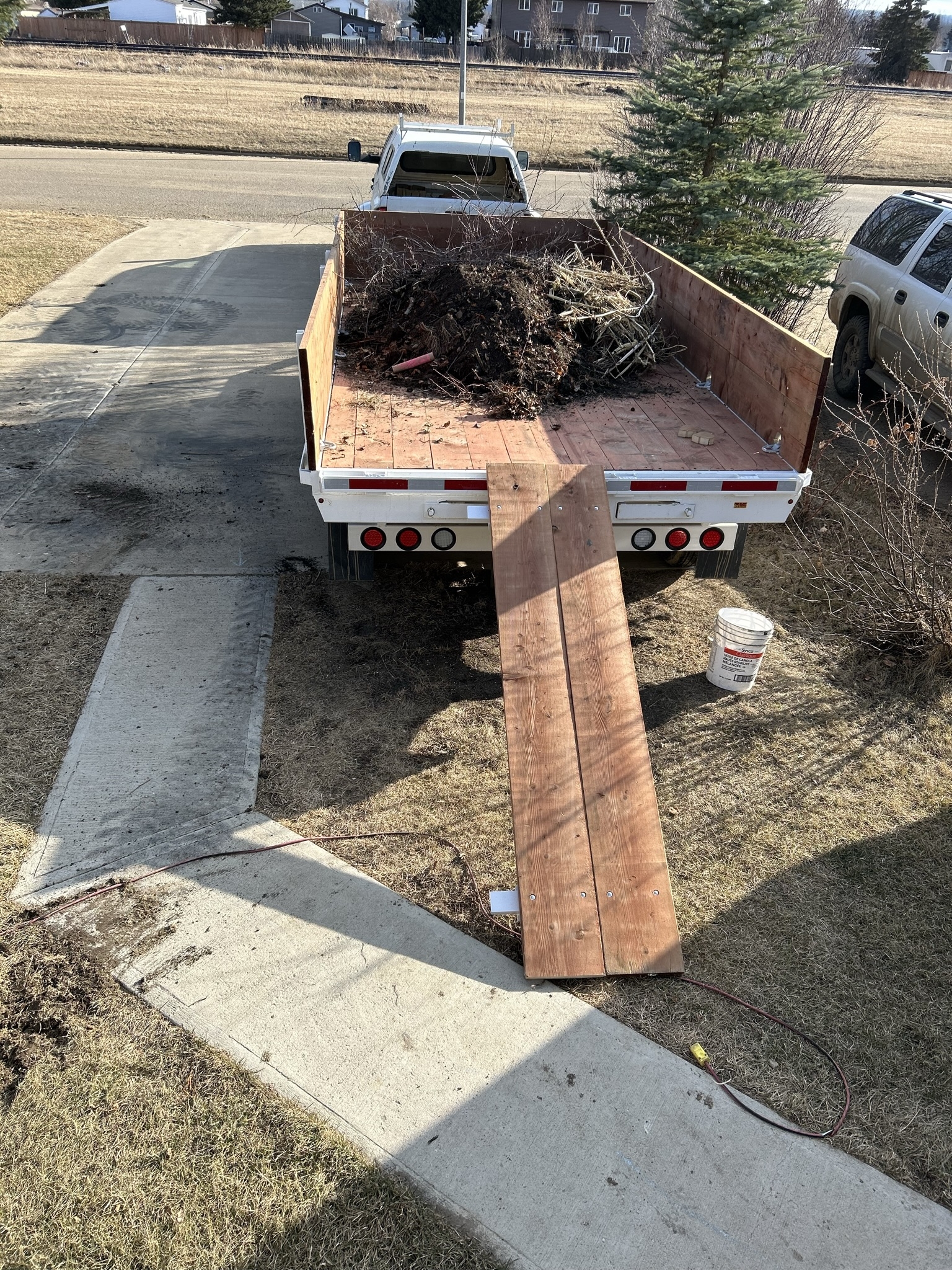

Here I took 4 yards of topsoil to my buddy’s place. This is the first time I had this big a load of dirt on it. I’m happy to report it didn’t feel like the back of the truck was coming up at any time. I didn’t weigh the truck and trailer loaded but it sure didn’t feel like the tongue weight was excessive.

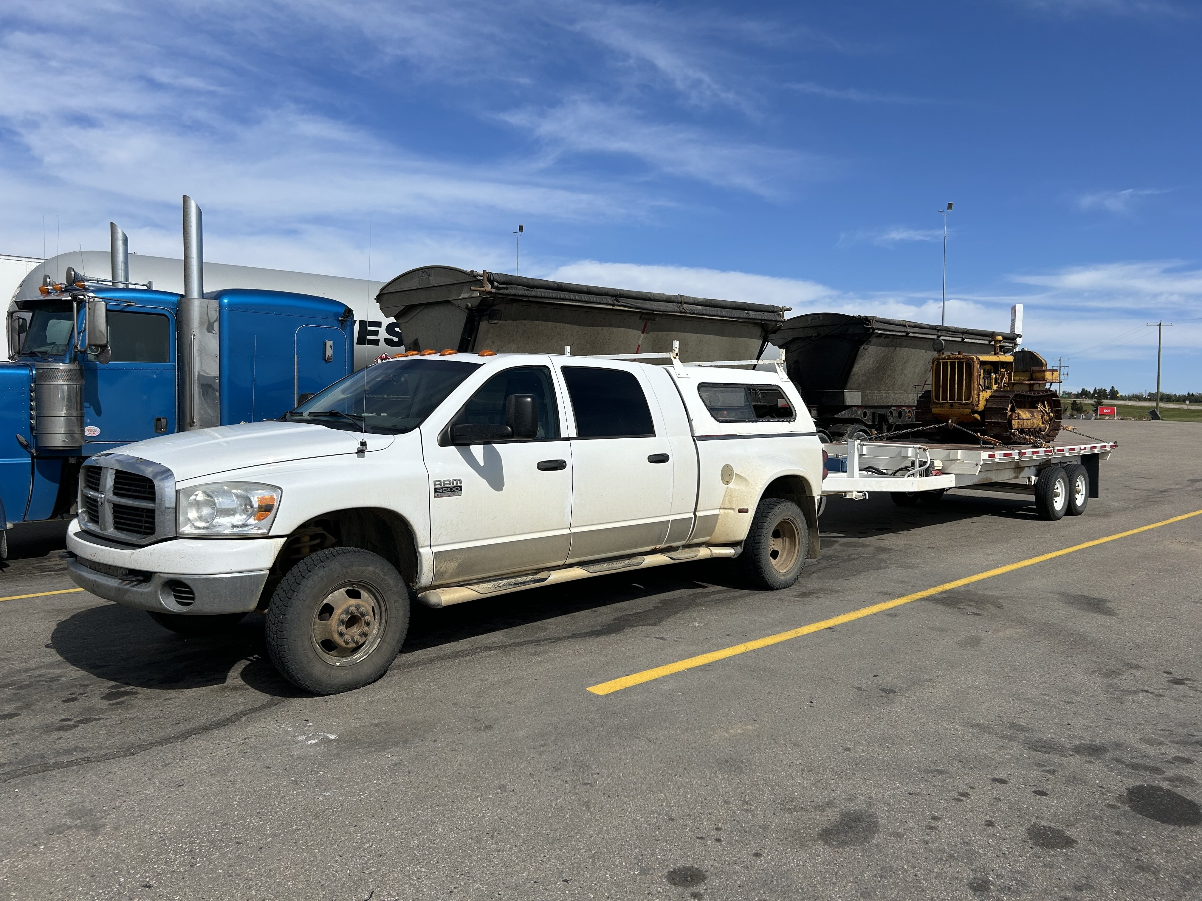

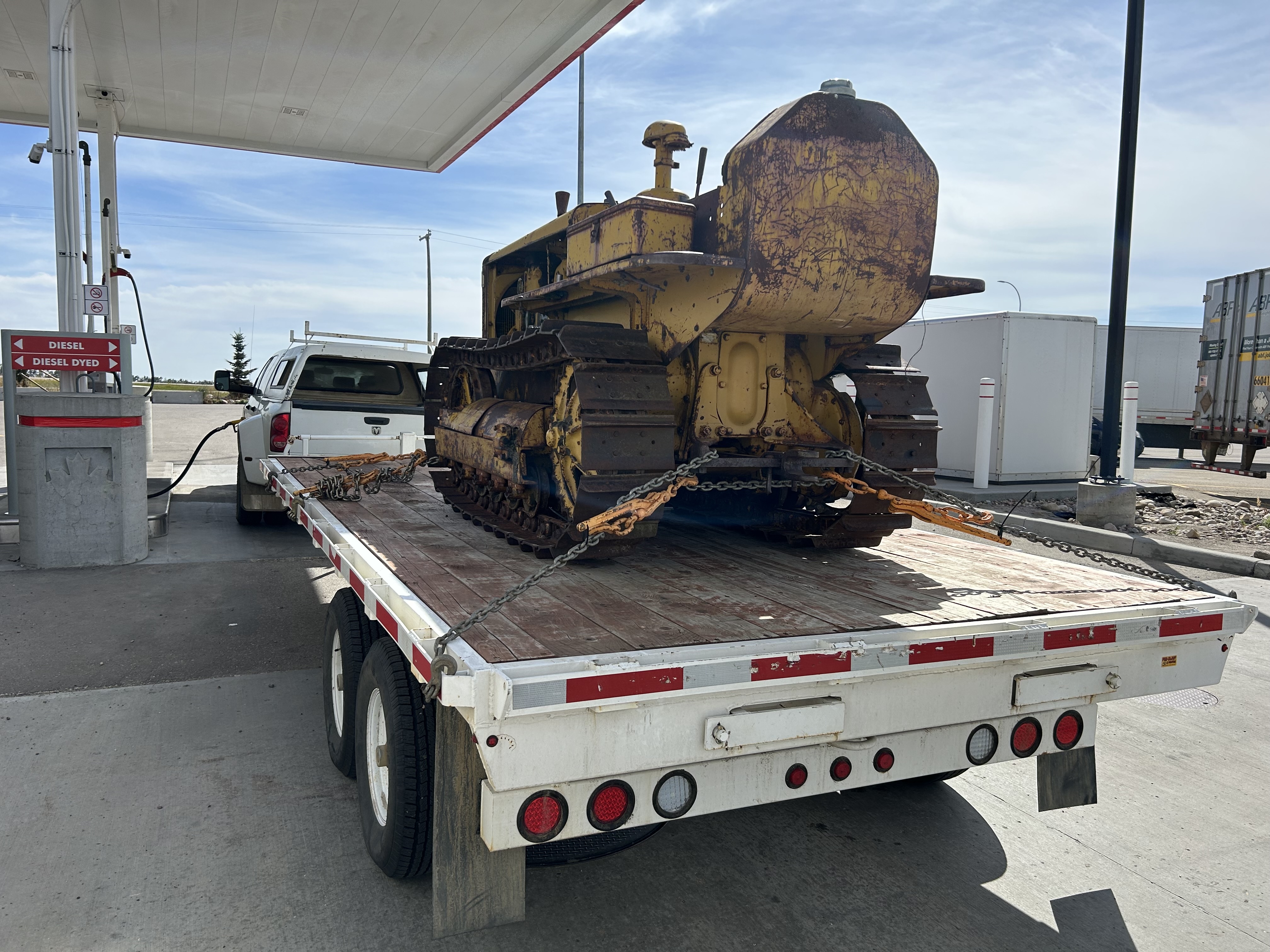

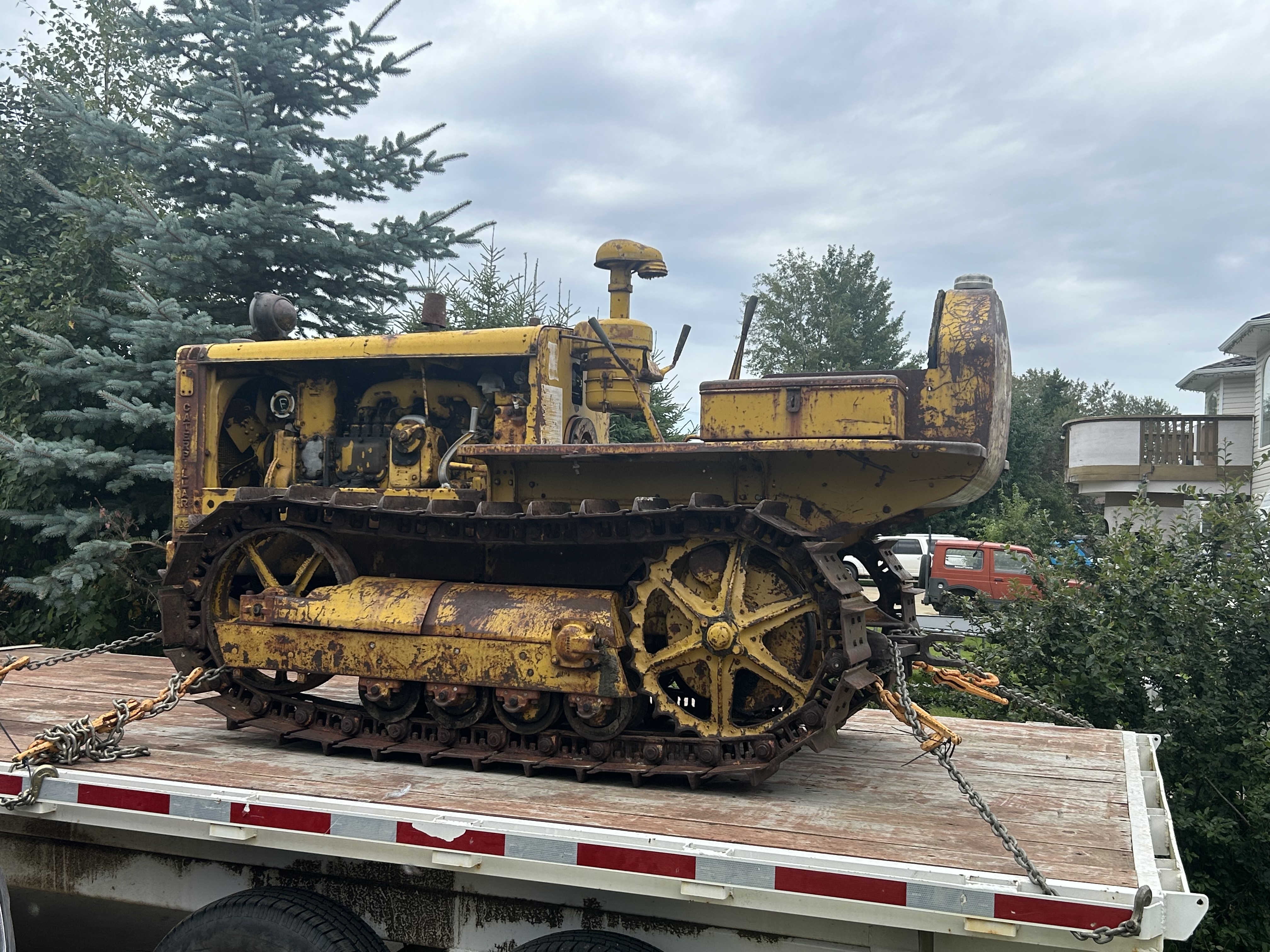

#27

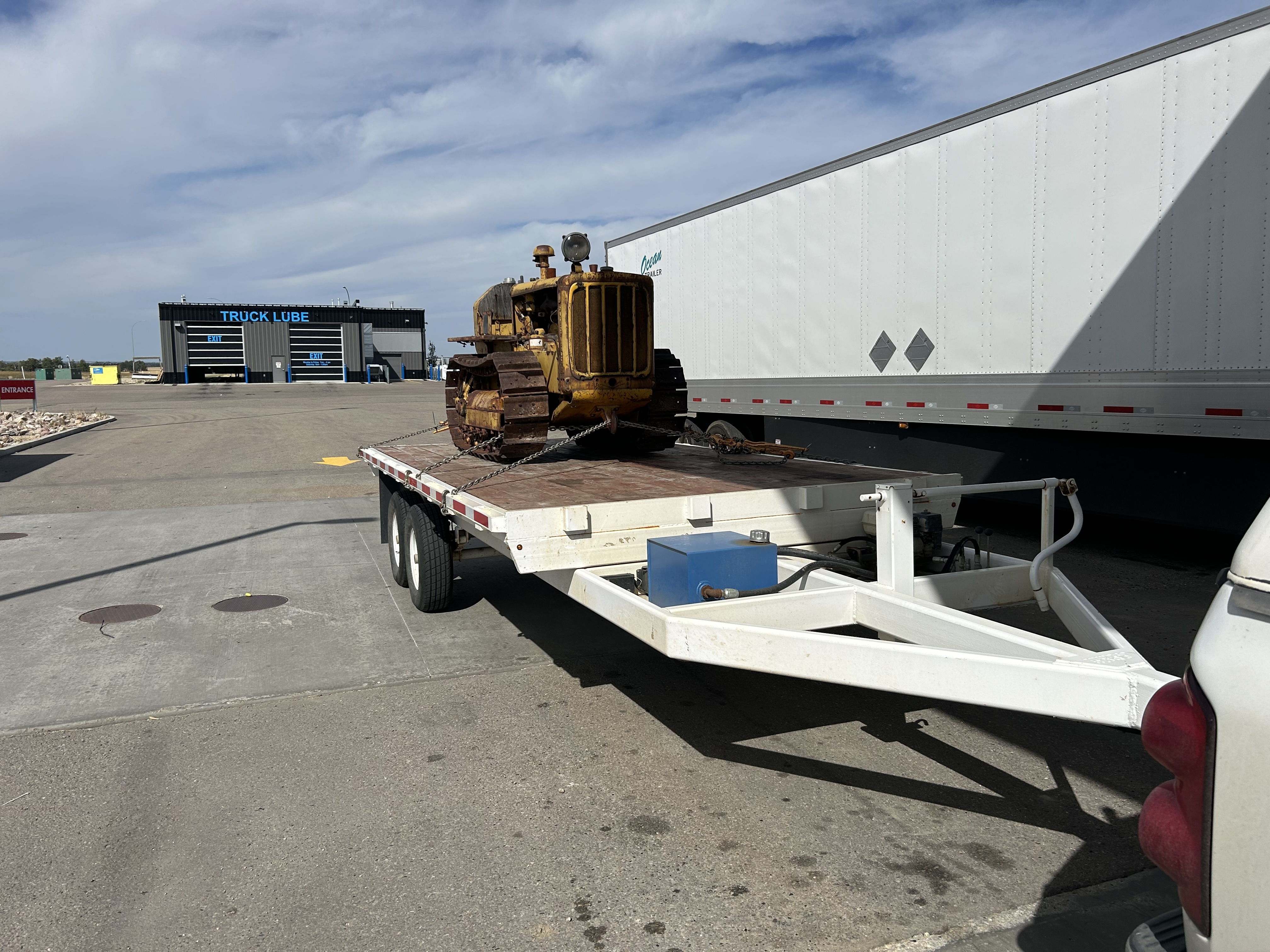

So I recently picked up a D2 Cat and I’m pleased to say the trailer hauled it very well. At first I was worried how it would feel hauling 7000+ lbs 5 hours down the highway but other than pulling a bit heavier it felt no different than the trailer pulls empty. It also didn’t pick the back of the truck up off the ground when loading or unloading. The cat doesn’t run at the moment (apparently it last ran in 1975 or thereabouts) and having the deck tilt up made it very easy to unload!
Here’s some pictures of my new love affair as my wife calls it on the flimsy trailer…
