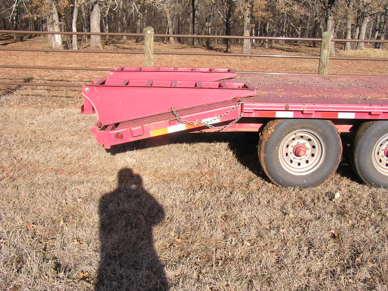

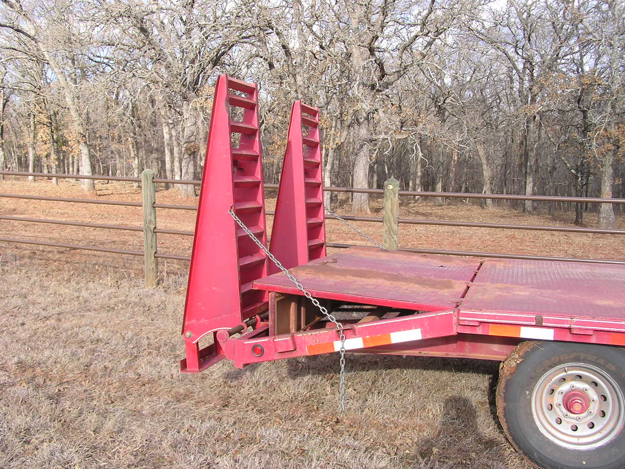

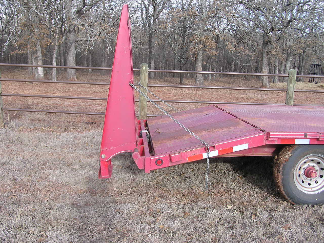

I have owned many trailers in my long lifetime, but this is the one multi-use that I like the best. I use it for all the things that you mentioned, plus more.
You can get it as a bumper pull. I ordered the gooseneck version 10 years ago, with a metal deck, LED lights, the receiver hitch and rear trailer light plug.
It is a Delta 102"x22' total length. I ordered the 4' pop up dovetail, because a 5' dovetail drug on the uneven ground in the hayfield.
