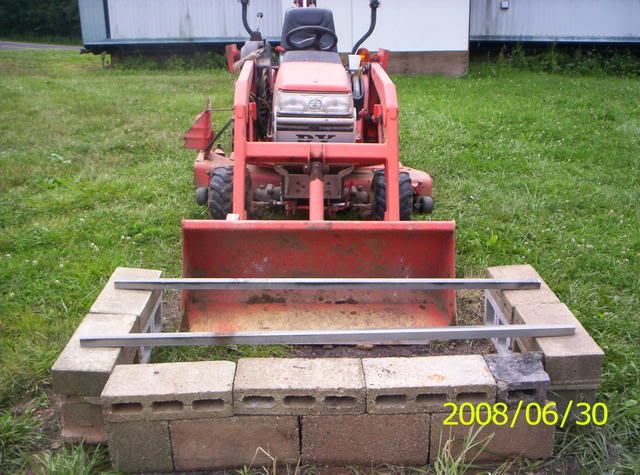

/ BURN BARREL BASE #22
This burning barrel sets on end on top of the 2 metal bars spanning the cement blocks.
The problem I've encountered is the bars keep bending and sagging ; Yet the only weight on them is the light weight empty hollow drum.
The bars pictured are aluminum and didn't work out at all .
I replaced them with 3/4 steel pipe which was a big improvement but they are still starting to bend and sag.
Anybody got any ideas about what I could us for bars to prevent this?
BTW:the span between the blocks is only 54 inches.
When I was usign my open ended barrel, the bars were scrap angle iron, pipe, bar stock, anything iron/steel with some 'heft'. Figured to replace them every year or two. Barrel was usually good for about 3 years.
An open ended barrel with grid under will burn better than any other type of barrel modification or open sided container. The barrel, once lit off, has a draft that would suck your hat off.

My burning barrel sets on end on top of the 2 metal bars spanning the cement blocks.
The bars pictured are 1&1/4Th inch aluminum C channel spanning a 54 inch gap.
I had to replace them because they were not stout enough to support the barrel.
I replaced them with 3/4 inch steel pipe but the pipe is starting to bend and sag too.
What can I use in place of the pipe that won't do that?

It appears you are getting the steel and aluminum too hot for it to hold its shape. The steel is much better than the aluminum but must not be good enough.
Use some more of the cinder blocks to support the barrel and then just move them when you go to clean out the ashes.
If you are looking for something with a higher melting point than steel, try and find some tungsten. I think the cinder blocks will be much cheaper.

*It appears you are getting the steel and aluminum too hot for it to hold its shape. The steel is much better than the aluminum but must not be good enough.
*that's what I'm starting to suspect.

Now I ain't no expert in metal or fire but it seems to me that any kind metal at the bottom of the barrel will eventually bow from the heat, it's the hottest part of the fire.
Maybe pour some concrete into a form and make something, but it may crack....not really sure what works.
