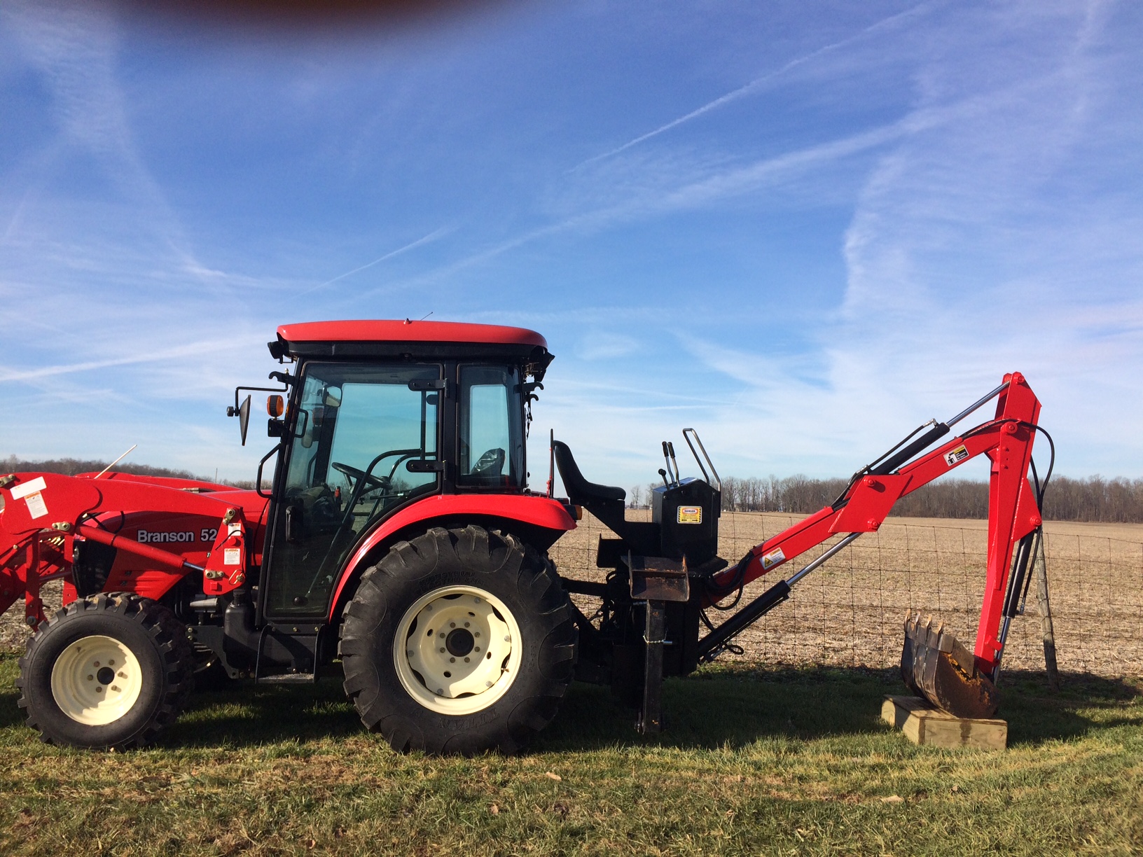

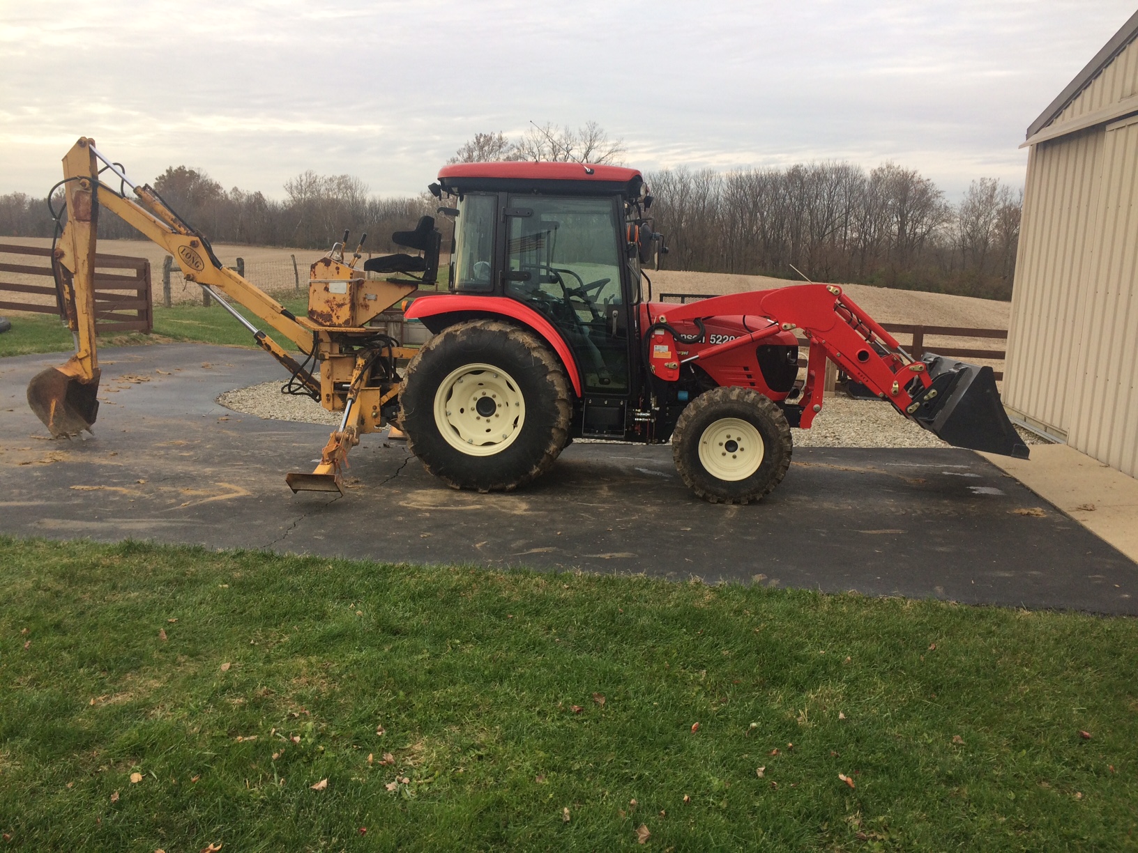

My apologies!!..... Let me start over.
I have a 5220C..it has the 3 ranges on the left of the drivers seat...and 4 different speed options on the right.
A little history:
I first notice the " burnt clutch" slightly last year when I was installing 200 ft of septic lines, using my three point hitch backhoe.....which uses the PTO shaft pump.
A few months later I was pulling a broken wooden fence post out of the ground ( we were hit by a tornado in western Ohio )....I pulled the fence post using the front-end loader...PTO shaft was NOT rotating on this project....and I noticed the " burnt" smell again.
A few days ago I was pulling some very large logs out of the woods...to go to a sawmil ...and noticed the smell again after I was done. I was using only the FRONT BUCKET and mostly REVERSE while pulling these logs.
I hope this helps with any confusion I might have created.
Thanks again
John
