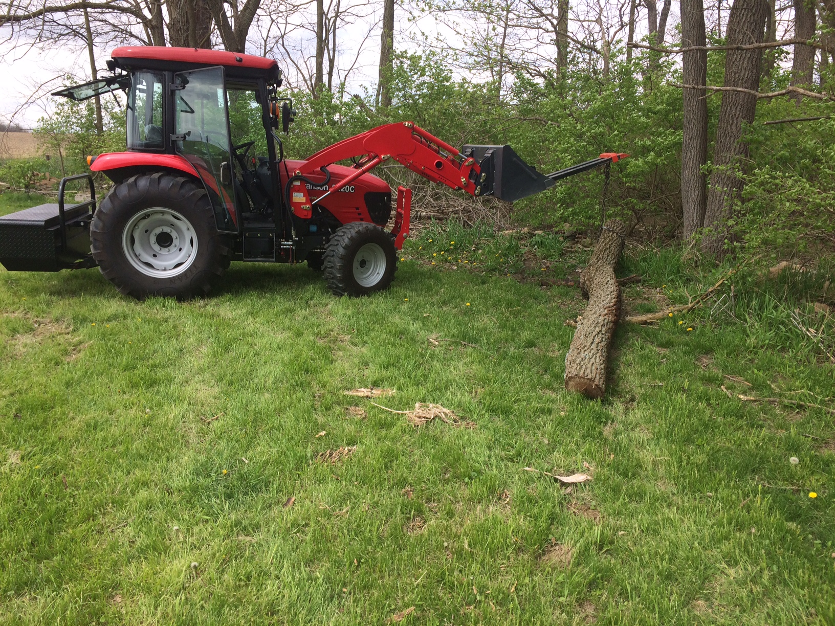

Here's what I have today...
I checked the free-play on the pedal...it was right 3/4"... So I adjusted it to exactly 1"...... Boy does it feel odd to push it that far down. ( also ...it was nice of Branson to put the adjustment turnbuckle behind an " easy to get to inspection plate).... Made it real easy to adjust from inside the cab.
Anyway...pulled the last log out of the woods today...(16ft)... And no smell, so far.
It feels so odd that you have to almost touch the floor with the pedal before it disengages/ engages the transmission.
I'll keep everyone updated on how things are going...but so far,...so good!!
Thanks everyone for their help, thoughts and ideas.
Thanks again
John

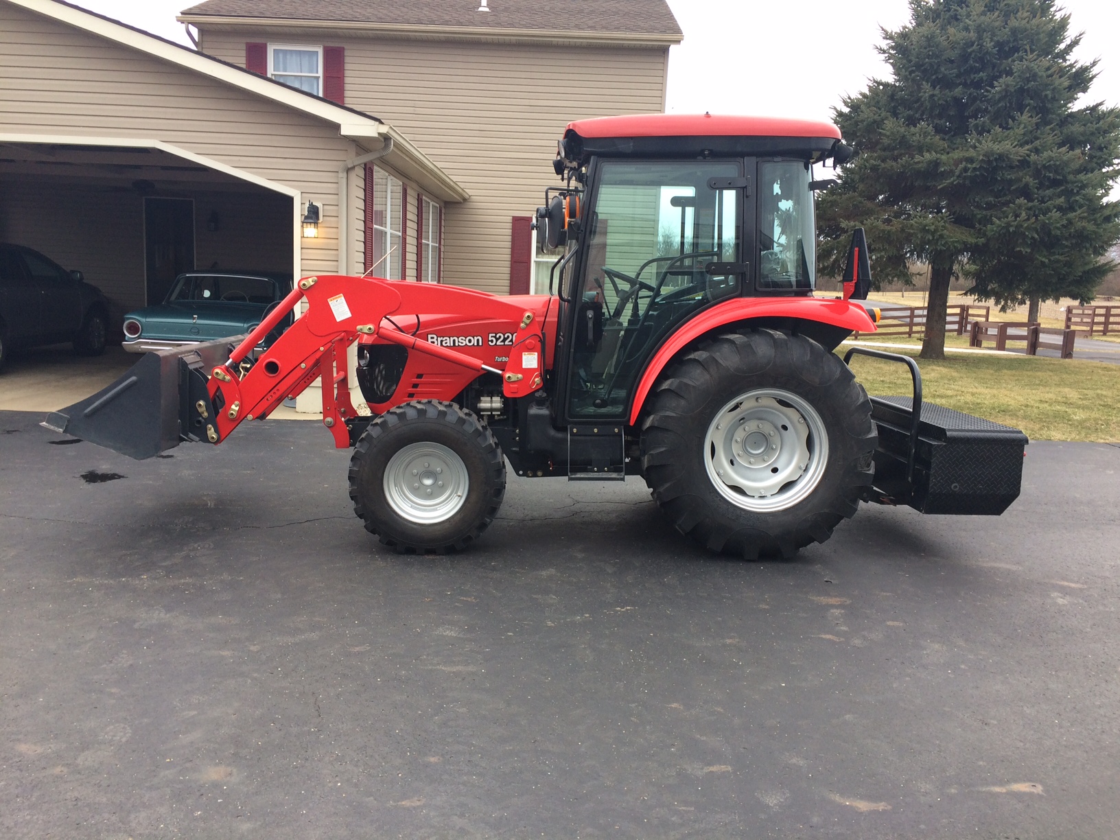

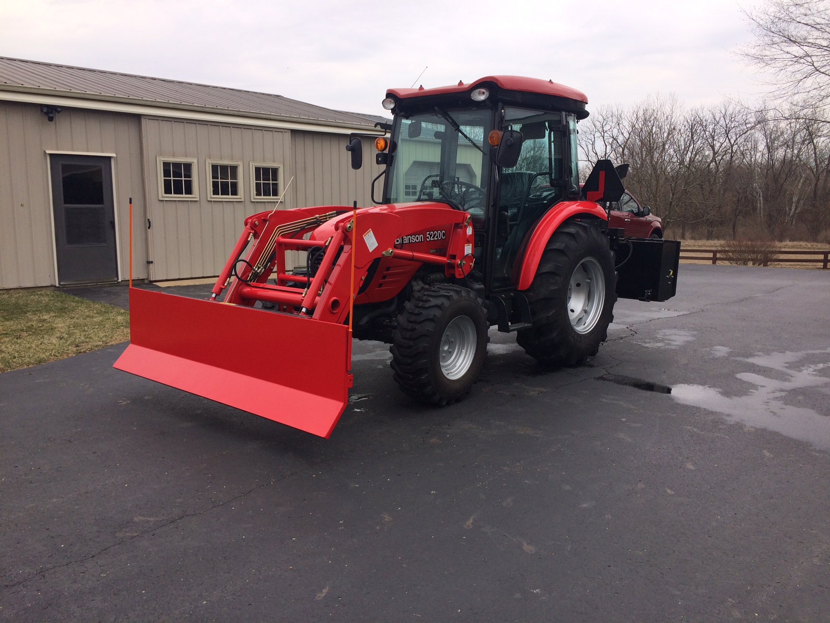

This is what I've got done

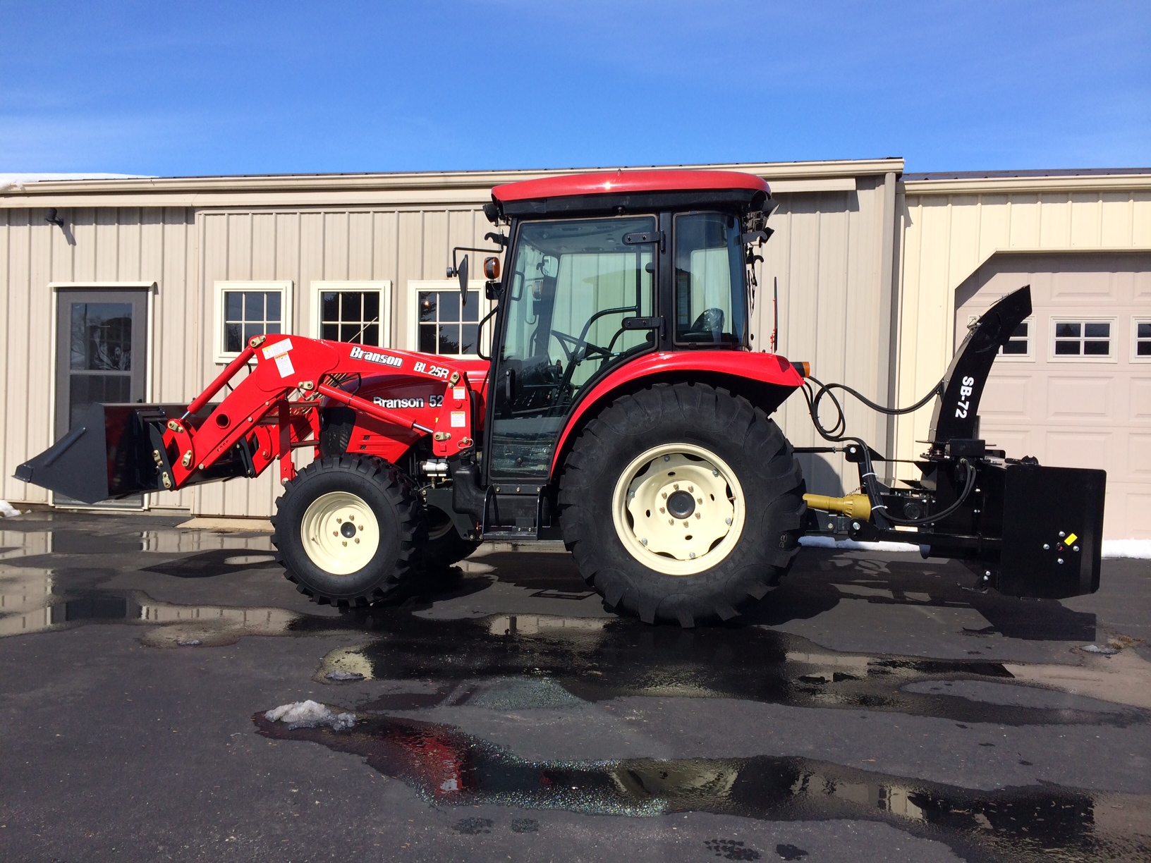

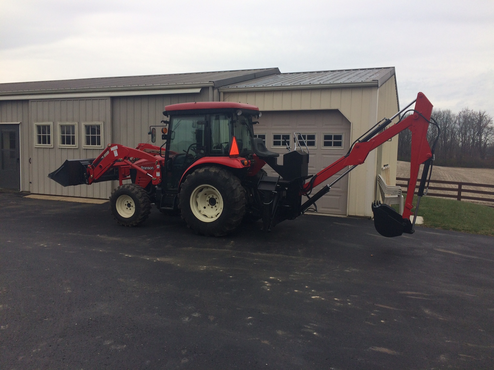

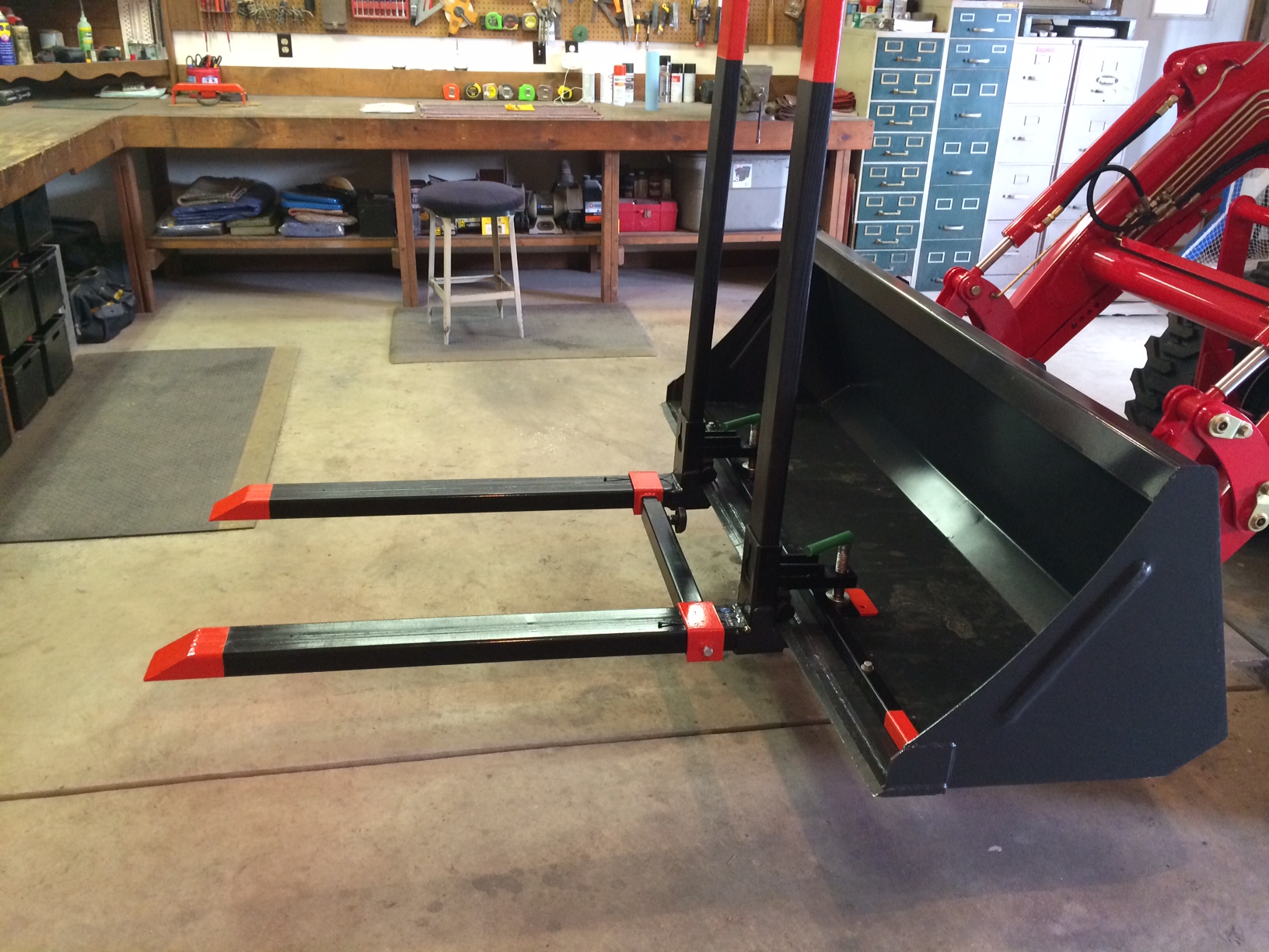

Just some of the things I've made and things I do with mine.
