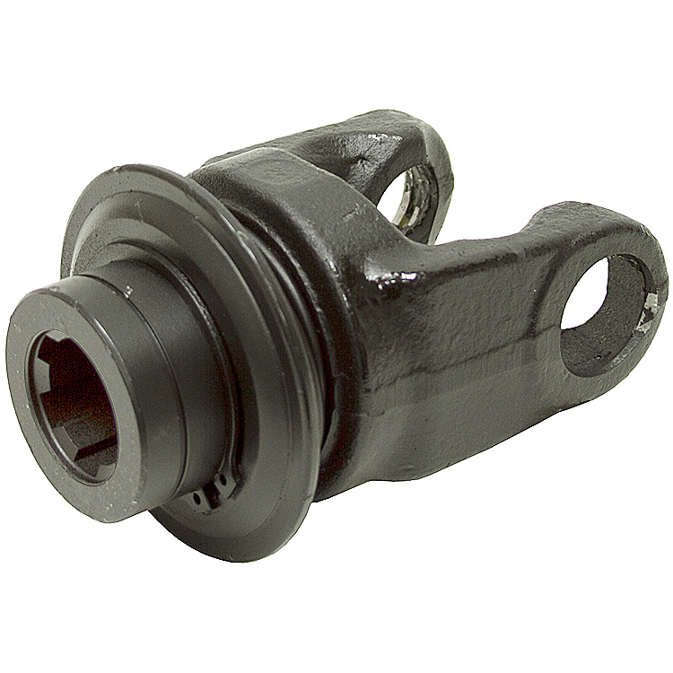

There are two types of sliding collar yokes, this type which in my opinion is difficult and awkward to connect;

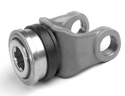

This type, IMHO, is easier to use as you can pull back collar with your index and saluting fingers while pushing yoke forward with your thumbs.
We have both types plus a couple with the push button yokes. Keeping all three types clean and lubricated will make hookup easier. I use compressed air gun to blow dust and dirt out of the yokes when I get done with an implement. Then dose it down with Fluid Film. Before hooking up PTO next time I give splines a shot of FF so everything slides well.
I have tried WD40 and the dry lubes and feel that I get best results from the Fluid Film. Your experience may be different?

I have the difficult type yoke pictured above. It is definitely a PITA design, and next to impossible to install without 3 hands. What is the make or name of the second easier type you pictured? Do you find the push button to be most useful, easier to wrangle than the second pic design?

I have the difficult type yoke pictured above. It is definitely a PITA design, and next to impossible to install without 3 hands. What is the make or name of the second easier type you pictured? Do you find the push button to be most useful, easier to wrangle than the second pic design? Thanks, CM
Here is a link to it at Surplus Center. They call them both "sliding collar" style.
https://www.surpluscenter.com/Power...LINE-W-SLIDE-COLLAR-TRACTOR-YOKE-1-3720-C.axd
As I noted, I have all three types but, probably prefer the sliding collar with large flange. They all work IF you keep them clean and lubed.

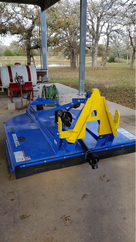

I think the cover over the yokes is part of the issue as it makes it difficult to get your hands around the yoke. Another issue with me is the Delta Hook QA I have to work around. The Woods cutter has my least favorite type yoke.
