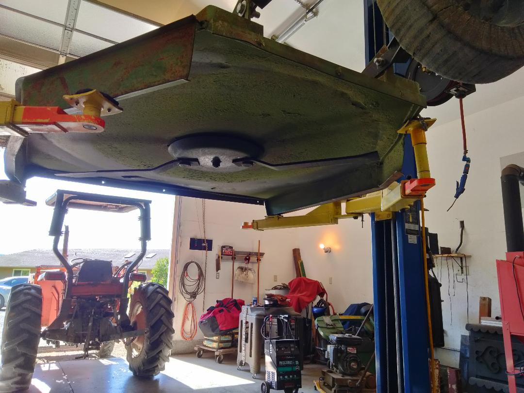

I cheat and use my two post lift...

That's a gloat, no?
Not necessarily a gloat but if it is seen that way there is not much I can do about it.
I bought this lift 15 years ago for $1,799.00. I have not had any funds go into it so the cost is $120/year. That come to $10/month at this point or less that two cups of coffee per month.
I just have so many people say they wish they could afford a lift. I think more how can you not afford it. I see it as an investment in being able to take care of your machinery in a comfortable way.
One tip though, do not buy a 9000# model as I did. Consider getting a 12K unit to lift heavier vehicles. I get a little stressed when lifting a 7500# vehicle as I would like a little more margin and not have to ask what is in the bed/and or are both tanks full of fuel... :) Do not get into the same predicament as I did.
