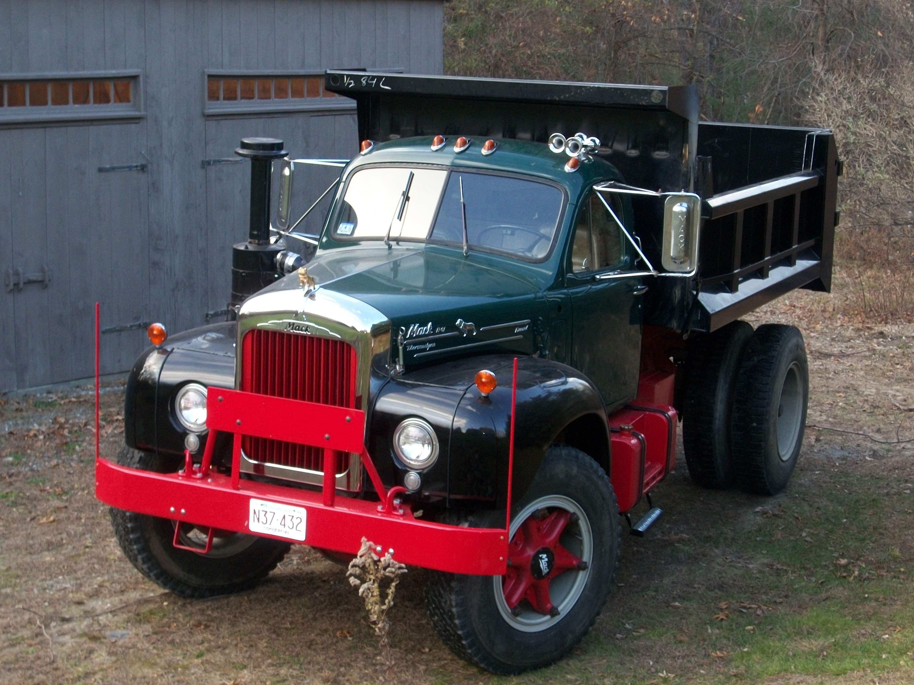

I too would be suspicious of a 26,000 GVW truck with 19.5 rubber. In any case DT 466 is a good engine in any of its variations. Also keep your eyes peeled for a clean Ford F800 with either a Cummins 8.3 or the Ford 7.8. The 7.8 was a tractor engine from Brazil that Ford engineered into medium duty trucks- good engine but emissions regs killed it. Check out E-bay motors under Commercial trucks and search "Ford".-"Internationa"l too.
"Builder" Nice 4800!
Check out my old girl:

Cute! :thumbsup:

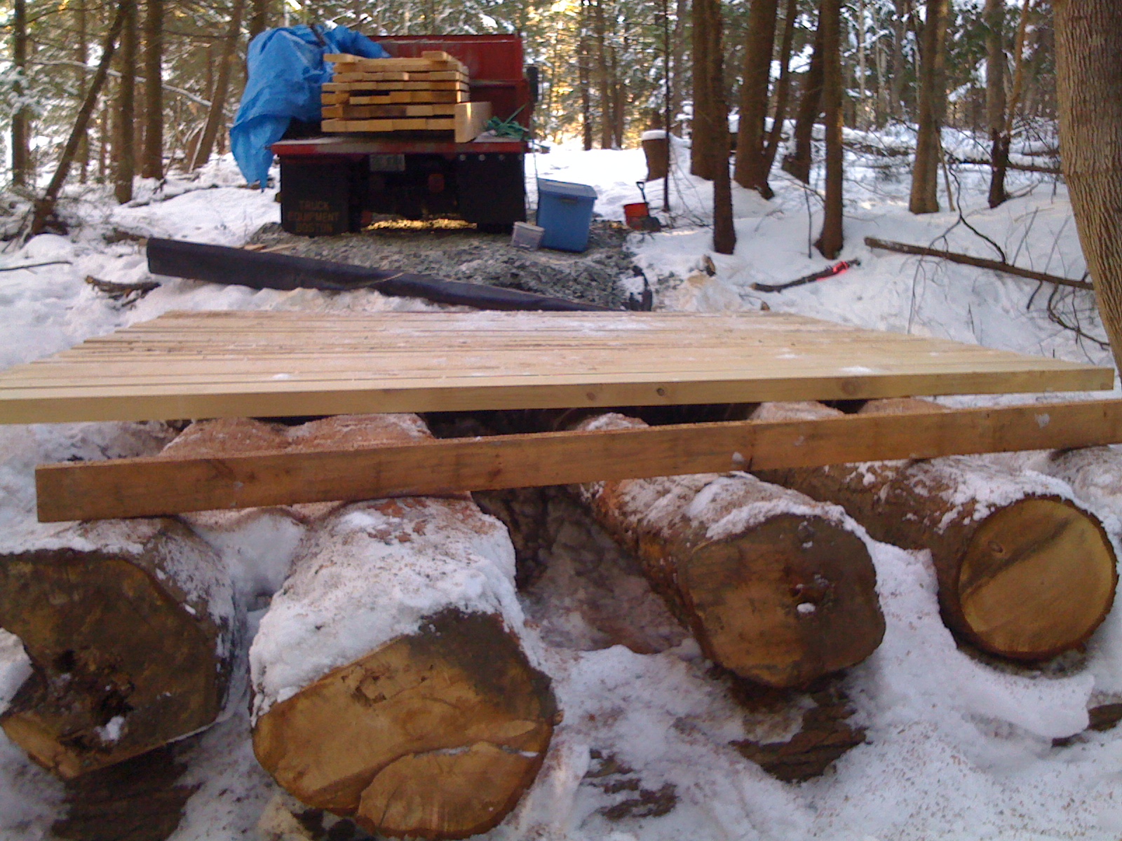

The truck I have ('94 GMC 3500 with a gas engine) will handle 2 tons just fine, but much more than 2.5t and it struggles up the hill and then really struggles to dump. I've stalled it several times and have to really lay on the gas/pump the throttle to start the lift. I got it used, and have been steadily replacing parts since then. Water pump, starter, ignition switch, dump pump, and I've re-lined the bed. I've probably moved 500 tons of road base so far. I'm lucky in that the local dirt guy will get the roadbase for me with his tri axle, and bring it to his pit in town. He also lets me use his loader to fill my small truck. I would have him bring it right up to the access I'm putting in, but 1) it is a little tight for his size truck and 2)there is a bridge I made out of hemlock that he is a little nervous about crossing (he did it a few times, but only with half a load, and he certainly won't do it with snow on the ground). With a bigger truck I could either get the material myself or at least drop the number of trips I have to make up.
I'll try to include some pics of the bridge under construction last winter, just because it's the coolest thing I've ever built.
Thanks again to everyone.

That lady is too pretty to get dirty. Nice old truck.
I drove the Brazil Ford Diesel in the late 80's early 90's as a lumber yard delivery truck. I remember it being reliable but not very powerful and cold blooded as they come.
