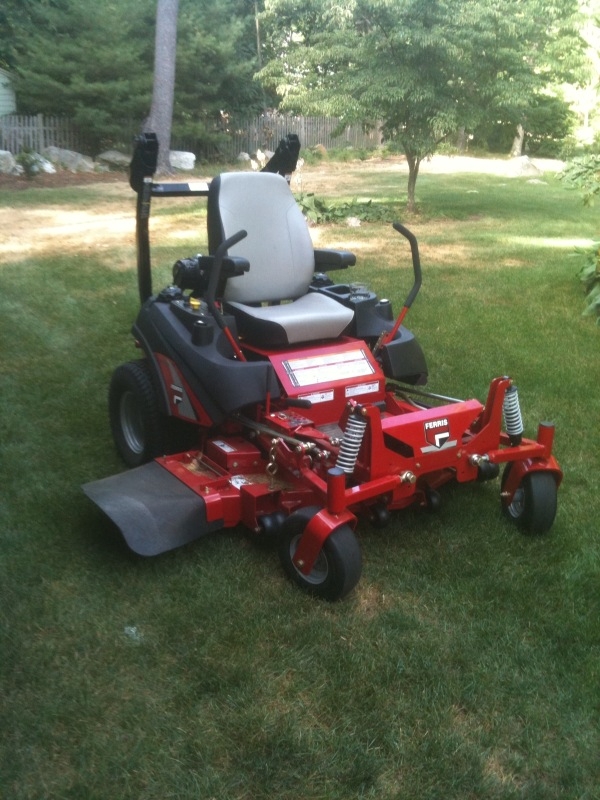

Since a lot of you ask about ZTRs and the like, let me second WinterDeere's recommendation to sign on to "Lawnsite." I have used that site for commercial opinions on ZTRs for over 20 years. If you make your living on these machines, you know something...listen.
Based on that site, I bought a lightly used Ferris 4500 in 2007 with a 30HP+ Vanguard engine. Great mower and great engine...except for the amount of gas it used. Sold it to my friend and took a friend's beating on it - he is still using it today with a large country yard to mow.
Fast forward to today. A 2013 BadBoy diesel ZTR and a Kubota front deck diesel. Both are good "farm" machines. (tried a Ferris 2600 with a Yanmar diesel in between.) Designed by idiots. Simply too hard to service (although the Yanmar engine is great) but the 4500 was a breeze. Still, the Ferris suspension system is great...and greatly costly.
But, since Winter Deere is really down on B&S engines, Intek particularly, I got one made on a Wednesday apparently. I bought it as a throw away mower at Walmart in 2002 when my job moved for a while. I used it in very heavy grass down south. Foot operated Hydro, mowed great. Curious, I put an hour meter on it. Today, still used on the farm in KY to trim for an hour each mowing. Something like 900 hours. Uses very little oil-replaced starter once and last year all of the idlers and pulleys underneath (but never a spindle - they are greaseable). A really uncomfortable process by the way. Use only synthetic oil, changed once a year with filter.
Now, would I recommend a B&S homeowner engine today? No. But sometimes you get lucky.
