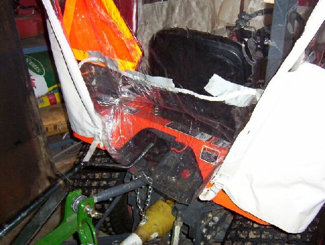

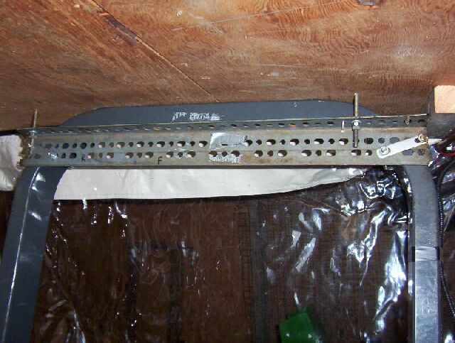

I have had several requests for addtional information so here it is hope it helps.
The plywood roof is 48 inches wide by 58 inches long ( front to back). If I was doing it again I would use 3/4 inch plywood, I do get some sagging when I get 8 inches of snow on the cap. You do have room to operate the FEL, attached is a picture inside of the cab.

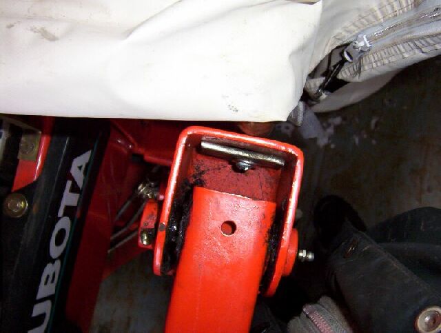

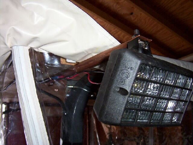

#28
The rear bracket is held in place with some 1/4 inch bolts with double nuts to prevent them from coming off. I kinda used what I had in the spare nut and bolt bins. I left this bracket on during the summer because the rear light was connected to it. Since I have removed the rear light to the outside, I will remove the bracket in the summer. All the electric connections are on quick disconnects, so dewiring will be just a few minutes in the spring.

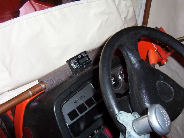

#29
Last one, this is how the copper tubing, which is a 31 inches by 31 inches, connects to the tractor on the left side. A bolt and a large washer works well.
If you have any other questions, please let me know.
