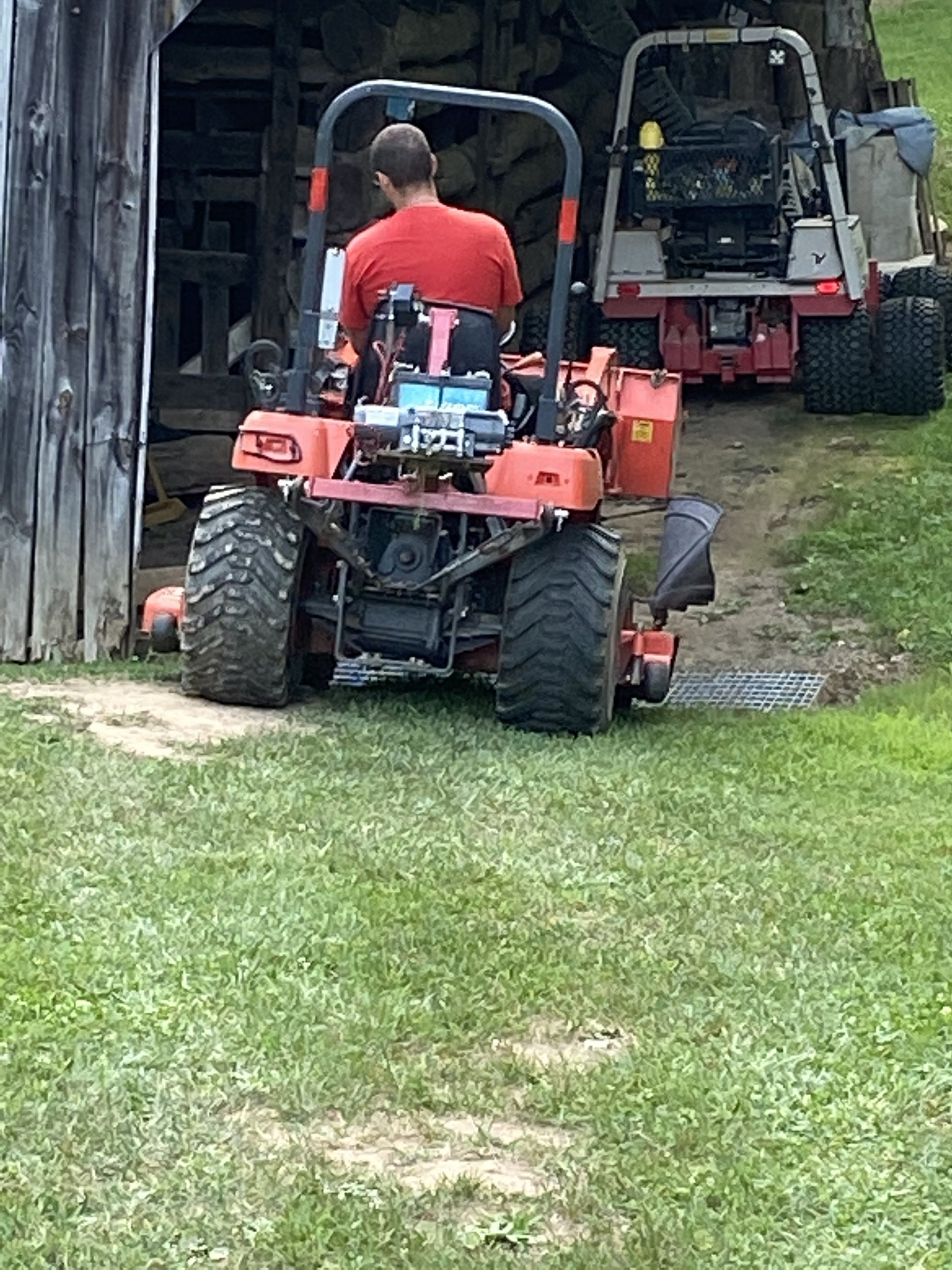

Just put the 1.5” aluminum on my BX2350 60inch mmm and it made a huge difference. I’m so glad I found this forum.
