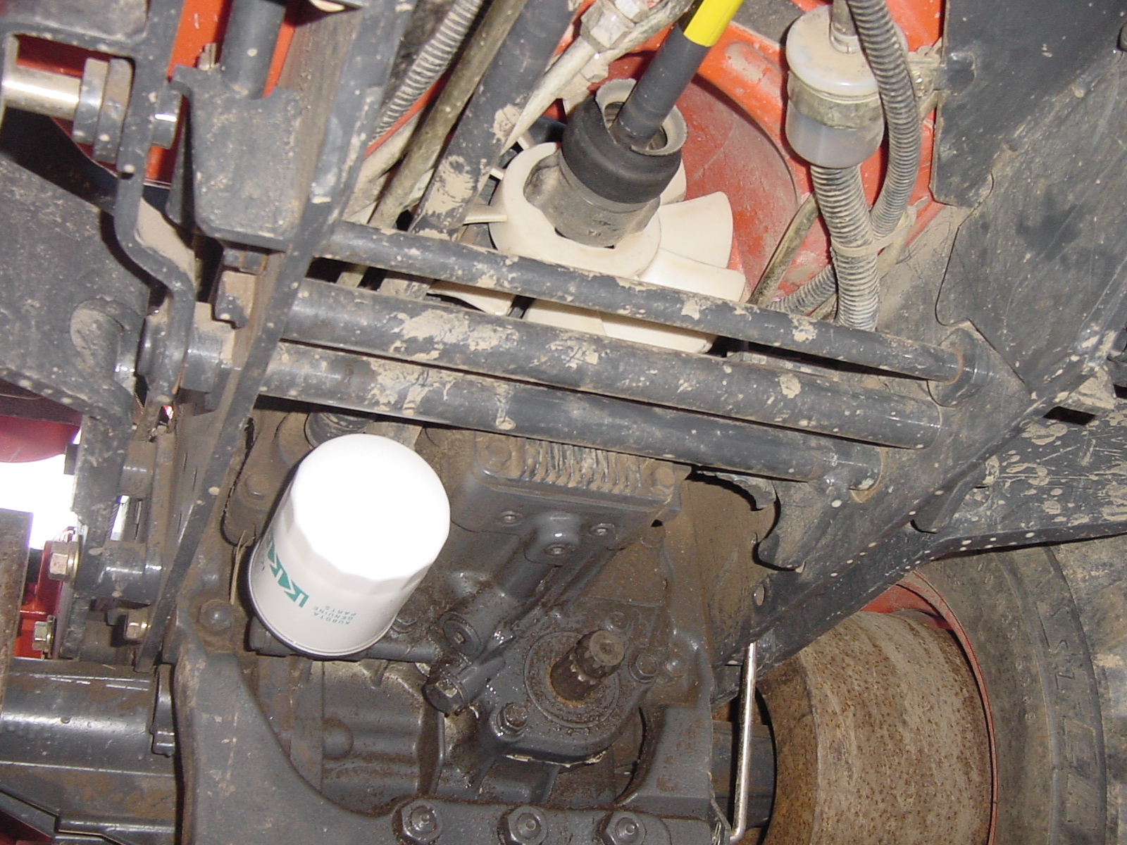

I also destroyed this fan on my brand new tractor. Murphy's Law strikes again. :mad:
Suppose the fan broke and I hadn't noticed? I presume the hydraulics will overheat. Does this cause catastrophic damage, or gradual? How often should I be crawling underneath the tractor to check this fan? Would it be prudent to install some sort of temperature gauge?

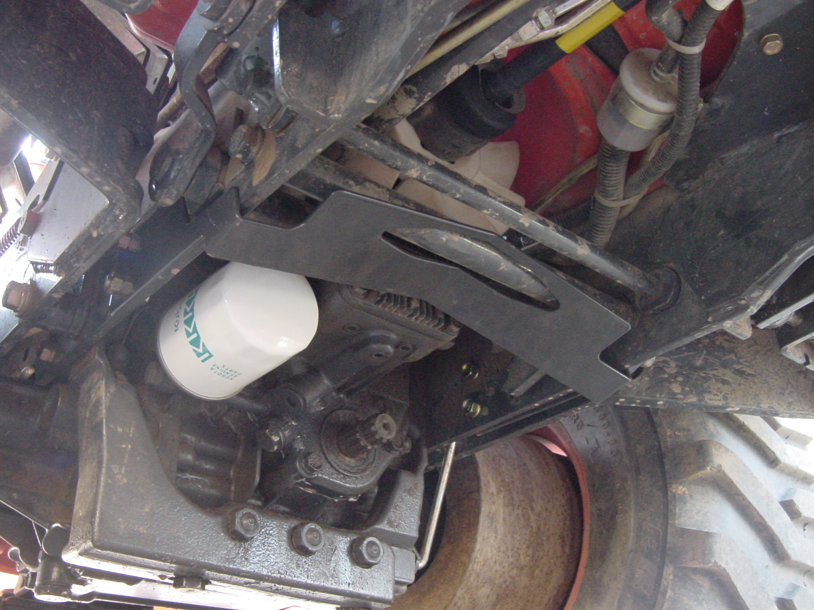

I read so many accounts of fan damage that the first add on I got for my BX was a Bro-tek skid plate. Well worth the cost since most dealers charge several times its cost to replace the fan due to the amount of labor involved. I know some guys have replaced their own, but I didn't want to face that decision.
