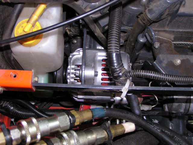

This artical was a nice addition to the instructions (term used loosely) that came with the alternator kit - especially the steps about cracking a couple beers, but it apparently needs update depending on which kit you get. I just installed the BX7310A kit for my 2004 BX23. It comes with different parts which address the problem Charlie had about removing the bushing from the alternator mount on the engine. This kit had the parts to do any of the BX tractors, but specifically had a special collared spacer which slides into the bottom alternator mount hole, adapting it for the smaller diameter bolt. Although Charlie found a bushing in the motor mount hole, the new engines in the BX23 apparently do not have that - I really looked closely - it has the smaller mounting hole and no bushing. The parts included work well to mount the alternator with the smaller diameter bolt, saving what I thought would be a painful step removing that bushing. Also, I did it without removing the cowl totally, just moved it as far forward as the brush guard would allow and lifting the side up (held up with a string) to access the bottom bolt and to feed the wires through the firewall. My kit had a spade connector that was slightly too small to fit over the starter/battery post and I had to round-file it to fit. They also shorted me the boot that goes over the alternator post, but I had one that did the job. They also shorted the alternator post nut, but the unused shouldered one that comes off the old regulator is perfect (who has a big stock of metric hardware around the garage?). The alternator is a tight fit - trying to retrofit a car unit, as one post suggested, might be a little tricky and probably not worth the hassle. The little relay that replaces the old regulator is used to disconnect the field (regulator input) when the tractor is off - perhaps the ignition switch wouldn't handle the current, or they wanted to meter voltage properly at the battery, so they went that way. The project is surely worthwhile - you end up with a real alternator instead of the permanent magnet dynamo and it's inefficient series regulator that comes stock - it's basically a larger unit of what rode against the tire on a bicycle. I used to see the light brightness change when I came off idle speed, but not now, and the battery charging voltage (14.50) stays almost constant (within 0.04v) when the lights are turned on. I feel the battery will get a full charge now. All set for a cab and radio!

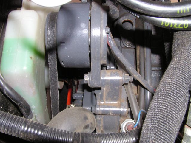

Hi guys, alternator shown in pic is a Denso, aka Nippondenso. These units are OEM on Toyota's vehicles as well as other makes. Old unit is an A/C only unit with no internal diodes used for changing A/C to DC. The retification is instead done in the combo regulator/rectifier unit. This is why the old unit had more wires (3 phase AC) going from it to the old combo unit mentioned above.

I Know this is an old thread, but I wanted to give credit to the original author Charliebrn, and updates by Electron8 and RichT. It has been raining here all day, so decided today was the day to get this upgrade done. Great information and pictures (also gleemed the Amsoil filter # SDF20) I sure it would not have gone as well without this great advice. I don't post very often here, cause I'm usually looking for advice rather than offering. Thanks again for a great install article.

I was able to get the kit. As mentioned, I had to specifically tell them that it was a whole goods part. I removed the cowl and it was a breeze to install. I had to use the original top bolt as it did not come in my kit. Otherwise everything was there (minus the red boot on alternator). Easy install and did not take long. Worth every penny spent. Everyone needs this kit. My Meyer snowplow now does not drain the battery and I can now also add a winch kit, aux lights, and power plugs for my sprayer pump. Thanks for all the posts and info on this.

I was able to get my alternator Kit on my BX23 today, followed Charlie's directions and no issues. His instructions where 10x better the the ones that came with the kit. My kit also did not have the red insulation booty for the hot lead on the alternator. My bota dealer found a black one laying around and I modified it to fit.
I also pulled the bash bar and cowling for easy access and raised the bucket. Just took my timeand made it better than a factory install, thank you all and especially you Charlie for taking the time and posting, the pics are worth a 1000 words!
