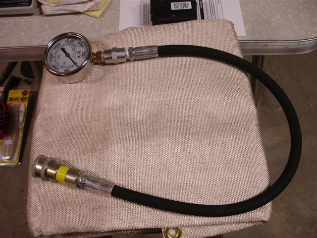

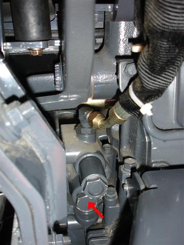

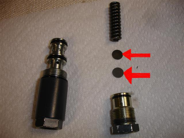

Gave the BX some more muscle for Christmas last night. After reading a post about this I ordered some shims from Kubota for the pressure relief valve, & made a pressure gauge assembly with parts from online. I did the testing off the FEL lift quick disconnect male fitting (red arrow in picture). Factory setting was 1775 psi. I used .6mm worth of shims to bump it to 2000 psi @ 2200 rpm (normally don't run it much higher) and 2050 @ 3000 rpm. The picture of the transmission is just to the left of the pto, the lower port is where the valve is located (red arrow). Will let all know if I can feel a difference next time it snows.

Nice how-to pics for those without a WSM.
Getting ready to do same mod. Just assembled my gauge/tee/QDs. One each of the .1, .2, and .4mm shims should give me what I need to build the correct shim stack for my 2K PSI target. Which did you add to the original shim, the .2 or the .4? Just curious, since tolerences differ.

On another thread I read that you get approx 39 psi/.1mm of shim. On that basis I initially added .4mm + .1mm shims to the existing factory stack which gave me 1950 psi (from 1775) @ 3000 rpm. One additional .1mm shim gave me 2050 @ 3k and 2000 @ 22k. My advice is start shy on the shims as the last .1 gave me over 50 psi, and the first .5mm gave me 35psi/.1mm.

Whole upgrade was less than $50 and takes less than 30 min.

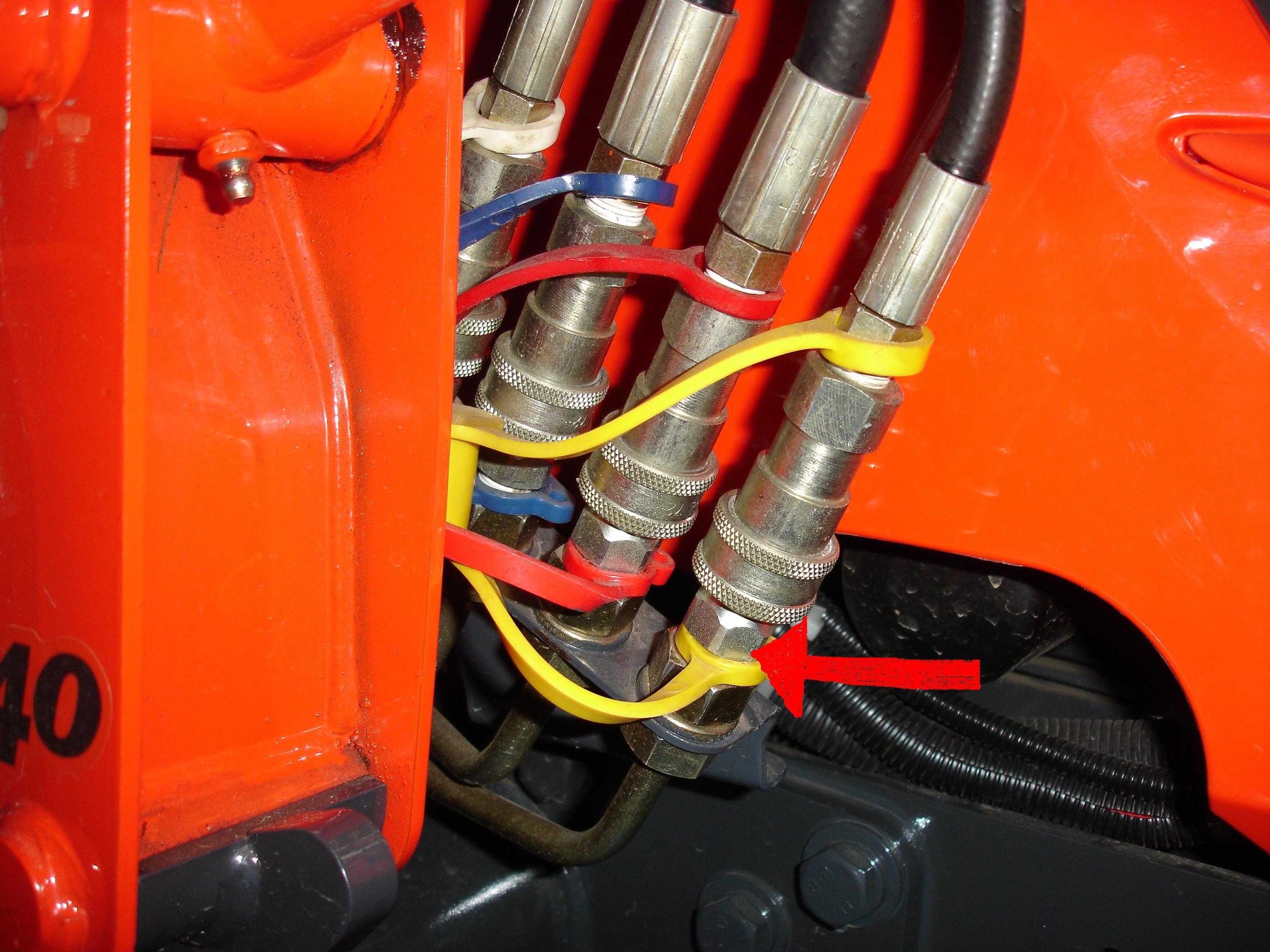

I have a question - I see you have setup your gauge to deadhead the hydralic output. Is this ok or would it be better to T in the gauge ?

There is no need for a tee. By connecting to the FEL arm "up" male quick disconnect the gauge is actuated as though your FEL arms were all the way up immediately as soon as you use the lever to "lift" the arms. You relieve the pressure off the gauge by tapping the control lever up a bit as though you were moving the arms down. Avoid going to down pressure.

The gauge is a glycerine filled 0 - 3000psi class A with a male 1/4" npt fitting.$10 - $15 at Northern tool or any supply store. The hose is 18" (so I could put the gauge where I could see it) - also 1/4" male male. One female female 1/4" npt coupler to mate the hose and gauge. The quick disconnect female coupler came from my local dealership along with the shims.
The shim part #s;
31351-37950 .4mm
-37960 .2mm
-37970 .1mm
Expect around 40psi increase with each .1mm increase to the pressure relief.

The site referenced for the prefab gauge is a John Deere site - not sure if couplings are compatible with other models. I used a female coupling for the gauge assembly in my case as the BX24 provides male couplings to feed the FEL lines on the valve side of the couplings. In such a case, if I was to use a male coupling on the gauge I would have to connect to the FEL lines and though you could get the same reading, you will be reading "through" a hydraulic piston and if bottomed on the gauge side to start you could get no reading ("0" psi is possible) - not as clean as testing directly off the FEL valve side. If you have a BX, the first post in this string is all you need to know.

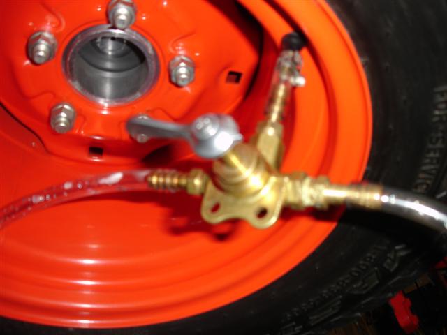

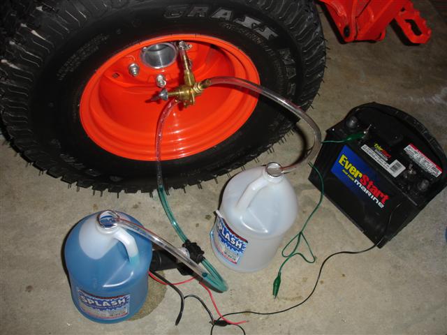

Not to Hijack my own thread, but while I was doing the pressure relief bump up I filled all four tires with ballast - 11 gallons each rear turfs and 3 on the fronts, though probably didn't have to do the fronts. I used a small 12v pump and a venting valve I had laying around. Only about 3 - 4 coors lights worth of time. Also found the front axle low by 1.5 quarts - we have been warned about this on other threads - I suggest everyone check. I would hazard a guess it's due to techs not removing the vent bolt on the left and right gear hub before topping off - make sure you do - I also spun both wheels to make sure the hubs filled.

Good catch. I didn't even realize the Aux-Hyd gauge has a male end and my BX has female FEL ports. I was getting around to checking the PSI on my BX but didn't do it yet. Guess I'll have to pickup a female termination and just replace the existing male end. Orange, if you call them, Ron might just be able to send you the gauge with the compatible BX female coupling. He's a nice guy to deal with.
