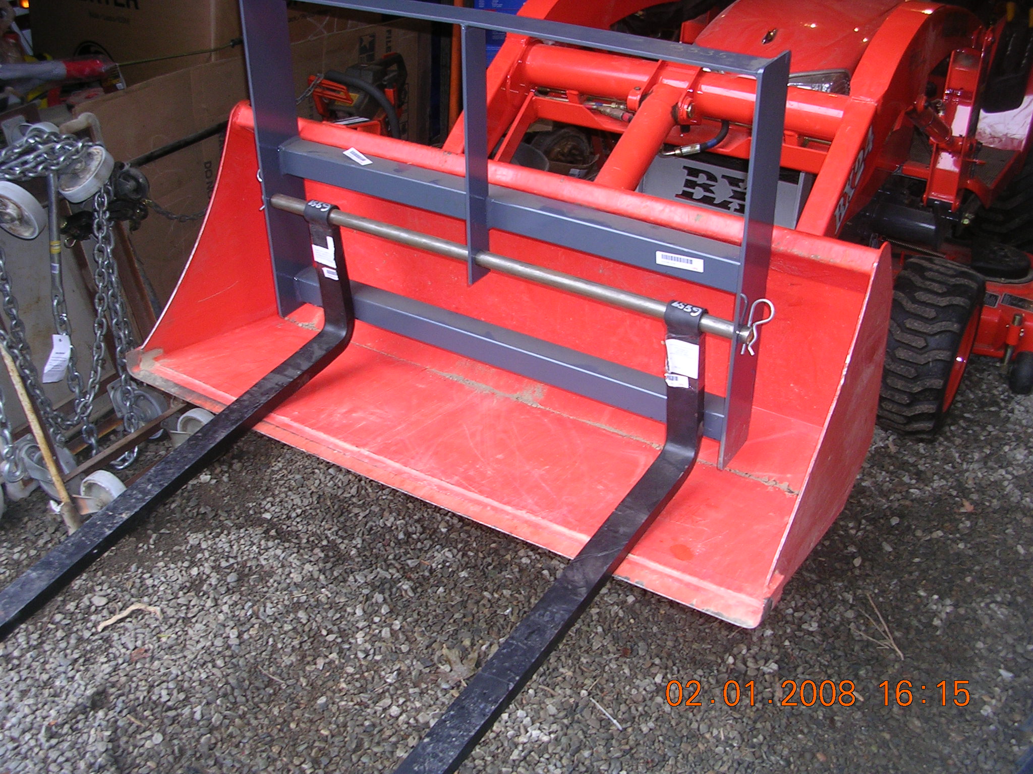

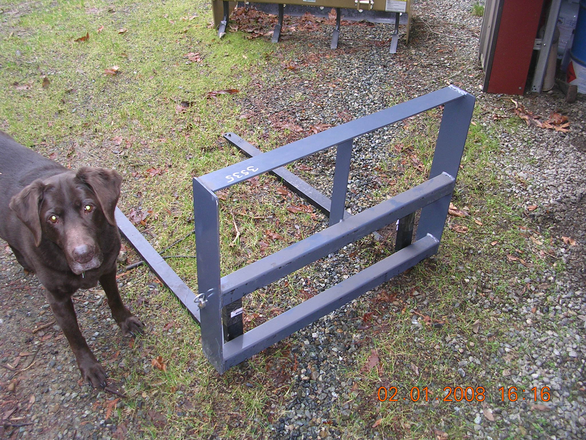

Here is the set of forks I want to use with the QA. I want to switch between the bucket and the forks easily. They weight about 130 LBS.
Cary:cool:

   / bx FEL bucket quick attach #79
CapnCray,
That isa a nice set of forks for the BX. They certainly won
t subtract from the lifting capacity since they are lightweight.
Does anyone know, approximately, how much the BX Bucket weighs when removed? That may be the next homework assignment.
It would be a good benchmark, as you wouild want to try to make any ohtre attchements plus a QA similar, or less weight, to preserve lift capacity.
My owner manual says the bx23 bucket weighs 132 pounds. Cap-n-Cray's forks are right in the ball park if his 130# includes the rack and too much weight is not added with the QA.
Cap-n-Cray,
I'm with SkunkWerX, those are nice forks. Can you share where you got them?
