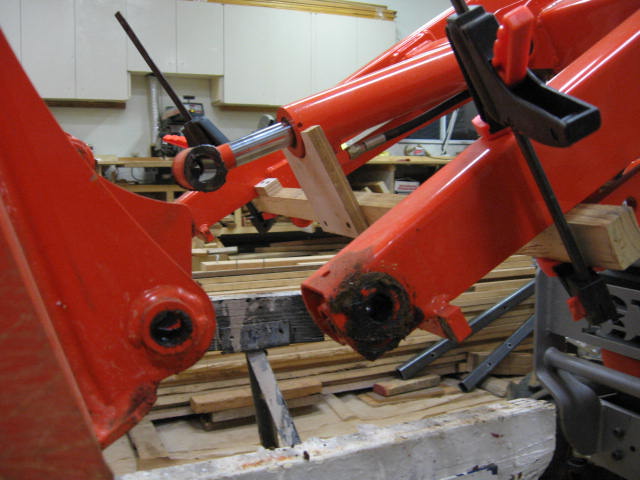

I understand now what you mean by registration jig, I guess really it is just a means to hold up the center cylinder?
Next step will be for me to actually remove all the pins and the bucket, and time how long it takes. The center was pretty easy, wondering how the 2 outer pins will be?

Yes, the registration jig is just to hold/lock the arms and cylinder pins in the relation of the implement that has been (is going to be) removed. If all the loader implements have the same geometric configuration then aligning one pin will put the other two really close. Once the pins are installed in the changed over implement the jig is removed.
I just looked at my bx23 and the center cylinder is just above the arms so the jig can be as simple as a 2x4 quick clamped to the bottom of the arms, butted up to the loader stand pivot tabs for registration, and then a half moon ply saddle screwed to the edge of the 2x4 to hold the center cylinder. Maybe the cylinder could just rest in the saddle allowing it to raise by hand for minor adjustment. The bx24 is likely a bit different. I think they have curved loader arm whereas the bx23 has straight arms. So a slightly different jig but the same idea.
Once roughly aligned the alignment/sleever tool would come to play. I like your double-ended tool idea. The tool root diameter would be a slip fit of the pin and then the taper would be 1/2 the pin length and maybe 1/2 the pin diameter. A few light hammer taps of the tool in conjunction with a little implement jiggling with a lever should drive the alignment pin to the root diameter. Then pushing in the real pin would push out the alignment tool.
Let us know how (easy) your lower pins come out. I'll do the same when I get the chance to do the same, maybe in the next couple of days.
I think we are well on the way to make this a viable alternative to the added weight (and build time/cost) of a bone-fide quick connect.

I removed my bucket tonight. I had the luxury of doing this in my shop so I was not battling the elements.
I set the bucket on a couple of horses and relieved all hydraulic pressure. I built a simple registration jig in about ten minutes.
All three pins slid right out. A slight tap to start them and that was that. Took about five minutes including messing with the keeper pin cotters (I don't have bolts like Just2quickz28's). Can probably shave a minute or more from this by switching to quick pins.
I slid the bucket away from the arms, wiped down the pins and mic'd them then re-attached the bucket.
Took about ten minutes to slide the bucket back, align, smear a bit of grease on the pins by hand, insert the pins, keepers, straighten the cotters and insert them. I did have a pin alignment tool for the arm pins. It was just 3/4" wood dowel with a tapered end. The bucket is so light that was all that was needed. Didn't need one for the cylinder pin.
So we shave a couple of minutes by using quick pin keepers but add a couple of minutes shifting from one implement to the next. Looks like a minimum of 15 minutes, maybe a hair more breaking out and putting tools away and greasing zerks.
Not exactly "quick" but for the relatively few times I'll be changing front implements each year it is quick enough for me to forego building a bone fide quick attach system. Certainly it is easy, no real effort required.
Pin Diameters (inches) at bucket:
Loader Arms:
Pins: .7485 to .7495
Bush .765 to .770
Center curl cylinder:
Pin: 1.187 to 1.188
Bush 1.196 to 1.199 (1.202 at one wear spot)
Looks like about .015+/- is needed for for a pin "slip fit".
This machine has only 115 hours, 90 by previous owner so I don't know the loader history. There was no visible wear at the arm pins but one quadrant of one side of the cylinder pin had slight galling. Perhaps he missed a lube job.

Red Dirt,
Way to GO!!! You beat me to it, THANKS greatly for the pictures and posting this, great findings. And it supports what I found when I removed my center pin.
I agree with your asessment, not quite what you could call QUICK, but, I also won't be changing every hour or even daily.
I picture a rake/root grapple attachment, and some pallet forks.
The fork attachment I will probably rig up a [platre that will accept 3 point rear implements. Won't use them on front too much, but just for ease of loading them onto a trailer, or moving them around it would be nice. Also it would be there for any "home brewed" attachments.
Great progress and good findings!
Thanks again for you efforts!
