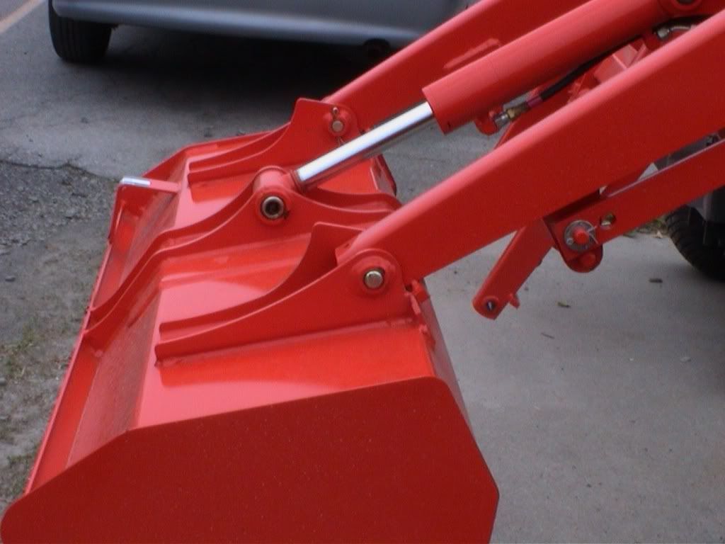

Ok I left work a little earlier than usual to get some work in on this project. And I did happen to get some pictures (pardon the pictures the camera has isssues at dusk). I took some time and filed off a bit of the bushings on the FEL arms till I was able to get the quick attach on.
I still need to do a bit more filing to get the movements smooth. But I stopped here to address some of the other issues I need to resolve on this QA. first off the LA240 pins are a little longer than those that come on the BX22/23 loaders but the same diameter. So I will need to get 2 side pins that match yours RedDirt (what model is your loader?) Likewise the 2 quick pins that came with the QA are not long enough to go through the loader. Well they go through the loader but are not long enough to get a retaining pin in. So in short I need to get 4 pins, the center cylinder pins didnt require any modification.
Now the last part will require some cutting on the bucket. The flanges on the bucket have 2 places where they hit the QA and keep me from alligning the QA to put the 2 side pins in. This should just be a slight trim on the bucket.
In this pic if you look close you can see on this side where the bucket is hitting the QA frame. If I take out the center pin on the bucket the side pins can line up.

It is a very nicely made unit plenty of ideas what I can do with this (it would have fit directly to your machine too). ATI told me that the failing point is where the center cylinder hooks because there is a tremendous ammount of force to curl the bucket from a fully dumped position. They said the unit would have "Stress Fractures" I think the downfall is that they designed it to work without modification to the existing bucket. Im sure a little modification to the bucket and unit would solve any issues. Here is the email from ATI, also the picture they sent back to illustrate their point.
ATI Email said:
I am sorry but the quick attach for the BX-series loaders has been discontinued. After repeated design changes of our quick attach to increase it's strength, some customers still experienced stress fractures. These fractures are due to the geometry of the single dump cylinder on these Kubota loaders. When the bucket is fully dumped, the two cylinder pins are nearly in-line with the pivot pins on the loader frame. When the pins are nearly in-line like this, a tremendous amount of effort, and therefore strain, is required to return the bucket from the dumped position. I have attached a photo to help illustrate my point. It is also interesting to note that Kubota has added a significant amount of bracing on the back of their bucket, as well. This area of the BX loader bucket is braced much more than Kubota loaders with higher lift capacities. This indicates that it is a high-stress area on a BX loader.
And all that stess is placed on that middle hook...... I guess I will worry about it when or if it happens.

Back to the topic of the ATI QA. Their Email and picture explain a lot.
So, let's take this as super-valuable information.
If we build any front attachments, whether using the QA or just the 3 stock pins, let's be certain we build the center bracket area very, very beefy to handle the strain ATI has referenced.
PS: my 2350 bucket doesn't have those 2 center bracket ribs that run all the way up the bucket to the top lip.

Regarding the tabs at the center cylinder, my bx23 bucket looks exactly like the photo from ATI.
And ditto making that center attachment very strong on any future fabrications.
