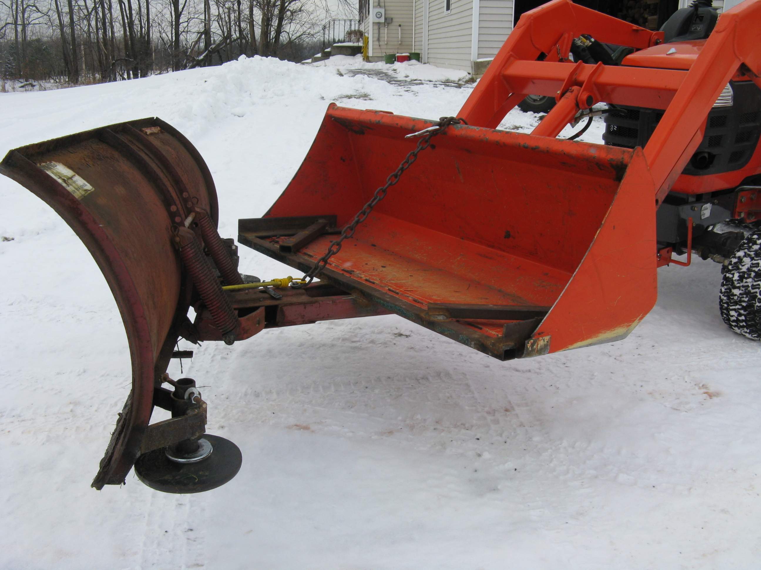

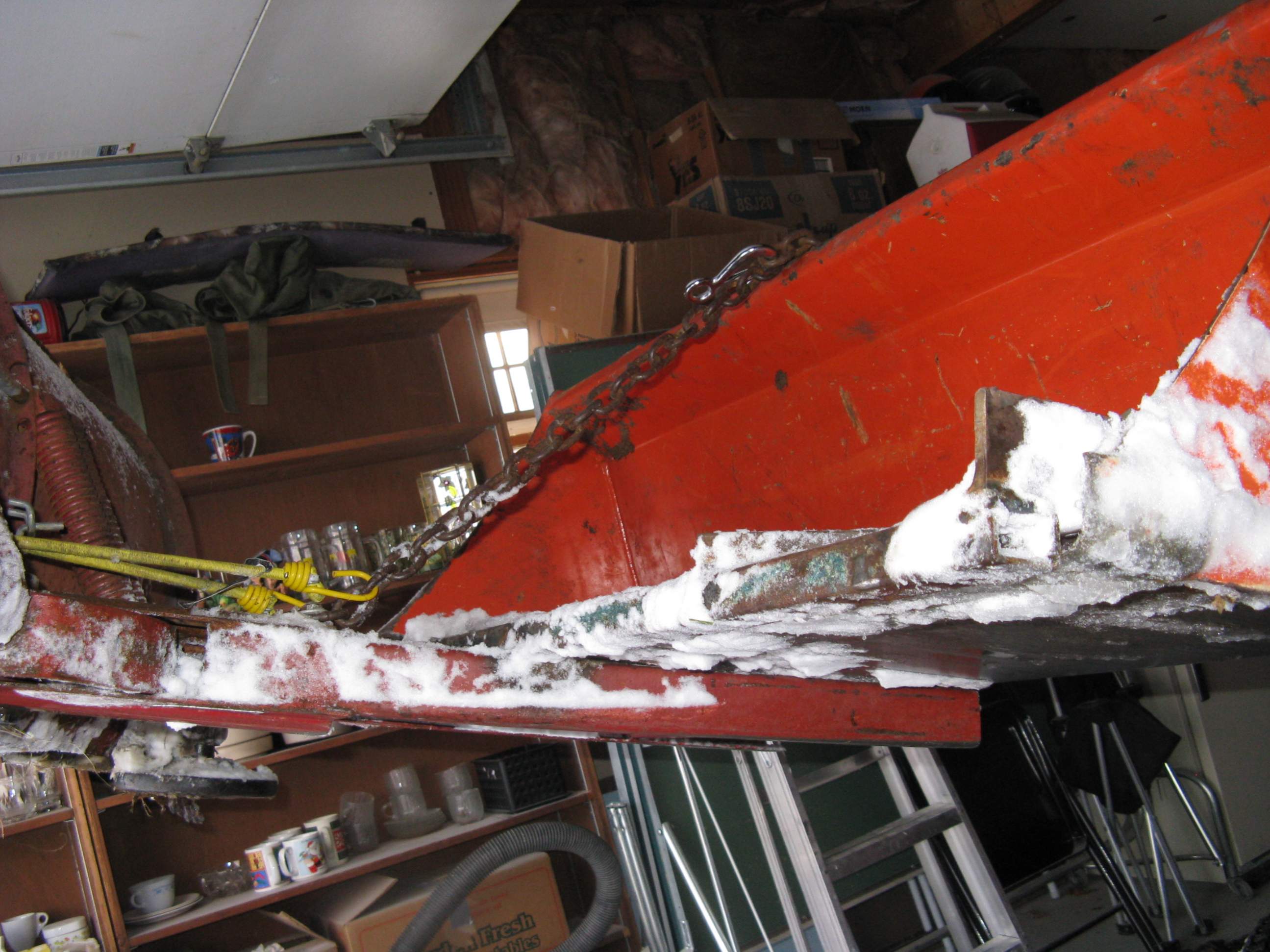

Heres what I made up for my BX 1500. Just a quick job before the snow came one weekend. Works really really good. Just slide the bucket into the mount there, and hook the chain up to the top of the bucket.

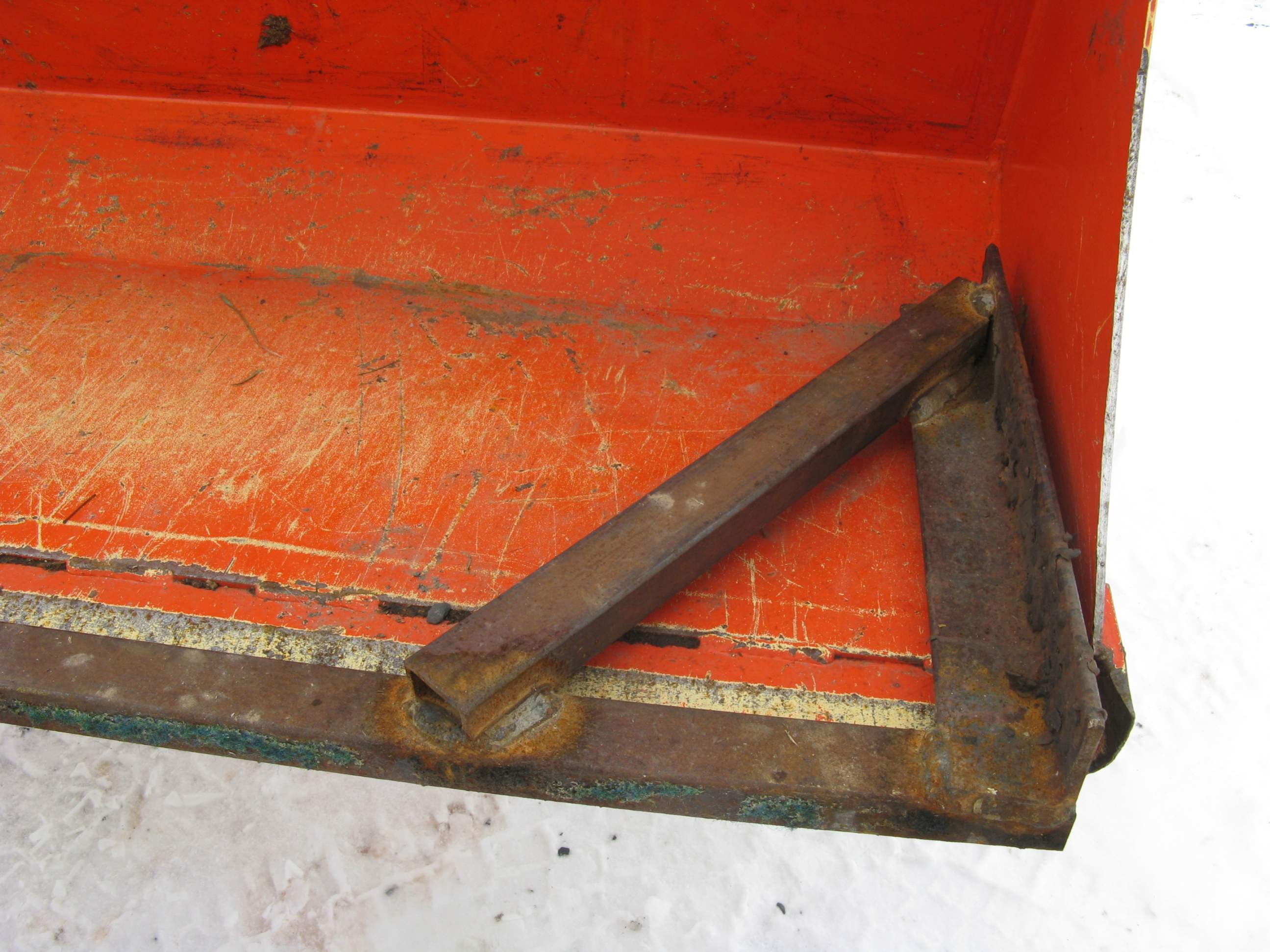

It would work a bit better if I had a chain binder on the chain, because there is some slop. I made the angle iron right up tight to the inside of the bucket because since there is only one chain in the center, the frame shucks side to side sometimes, so the angle iron helps stop it. Made some mounts for the snowplow shoes.
Yes I know, its not beautiful, and if you have seen some of my other stuff I've built they look the same way, but I am only 19 with little money, and I use all scrap steel.
Plows snow like nothing!!
Oh yeah and its great because you can just simply take it off real quick when you need the bucket for something. Also since the plow is so far up ahead you can easily push tops of snow banks back and work your way down

Just a few cans of paint and it will look great! May I suggest Cevy engine block orange? Nice jub!;)

that is pretty interesting and good way to go at it. good thinking! :)
   / BX FEL snow plow #44
Thank you very much!:) And yes, I will have to get some paint on it. I think it would really make it look much better.
